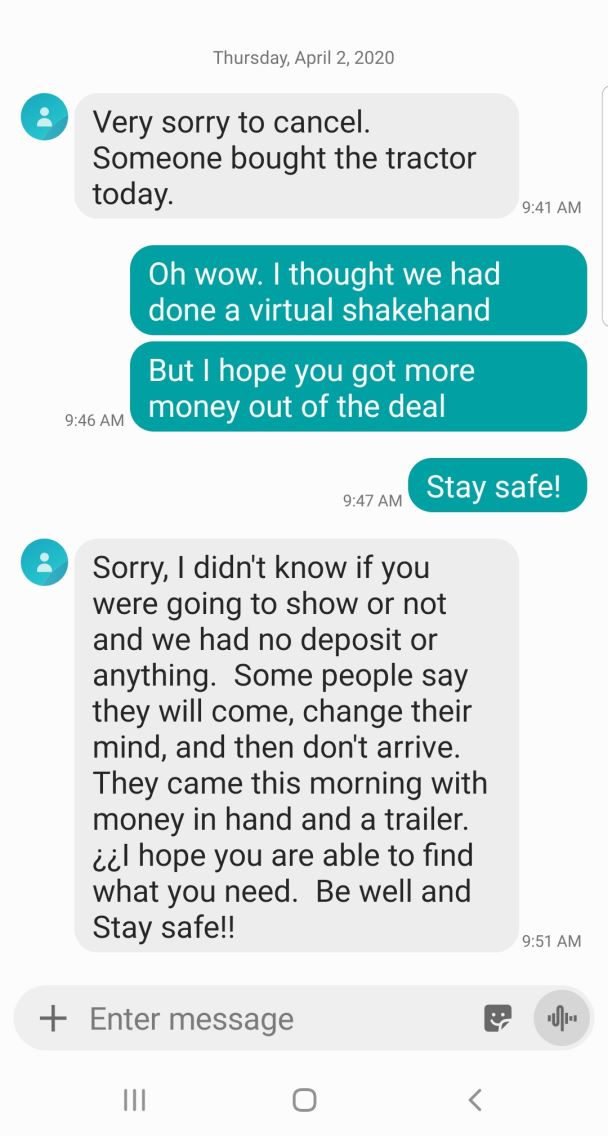

So I received a text just now and the seller sold the tractor to someone else :(:(:(. I am really annoyed and this delays a lot of things for me but everything happens for a reason and I hope I find something better soon.
having said that, if you're aware of decent deals that you've come across, please share.

I am in Connecticut and yeah even when I was having second thoughts about this, I was going to go ahead with it just because I had told him that I was going to buy it. I guess I am old school.

While you fiddled....Rome burned!
A good lesson for next time!
