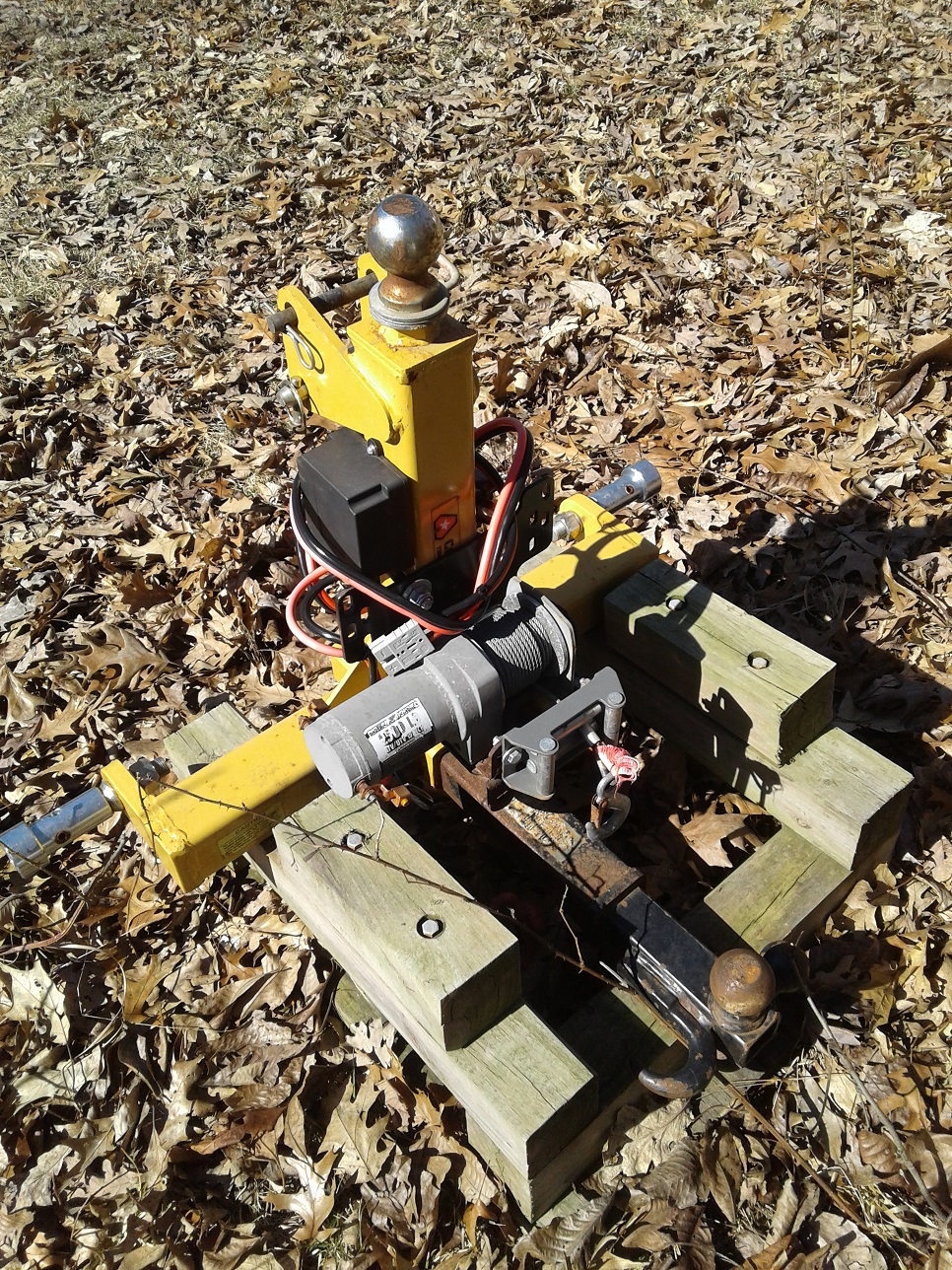

they make a 3 point setup that has a 2”receiver built in, you can make or convert attatchments, its slick, also works really good for trailors because you can raise or lower hitch, or a subsoiler for trenching, amazon has them.
   / Is this a reciever of some sort #22
I see the wholegoods price on a drawbar kit is only $60(50#) for a B26. Thunder Chicken’s receiver adapter looked useful too. Drawbar trailer hitch has some safety advantages over 3pt mounts.
There lots of safe ways and some not so safe ways to move a trailer with a tractor. Our manure spreader has to go on the drawbar. 3pt hitch it and your dead. Spreader tongue weight goes negative at the end of spreading a load a can lift, bend/break the 3pt hitch and crush the operator going down hill.
Anyway you choose use good sense, know your limits and consider how the forces effect the tractor.
   / Is this a reciever of some sort #23
Go with 3pt trailer mover. You can add a winch to pull stuff on trailer. You can easily mod concrete filled rollers for easy attachment.
