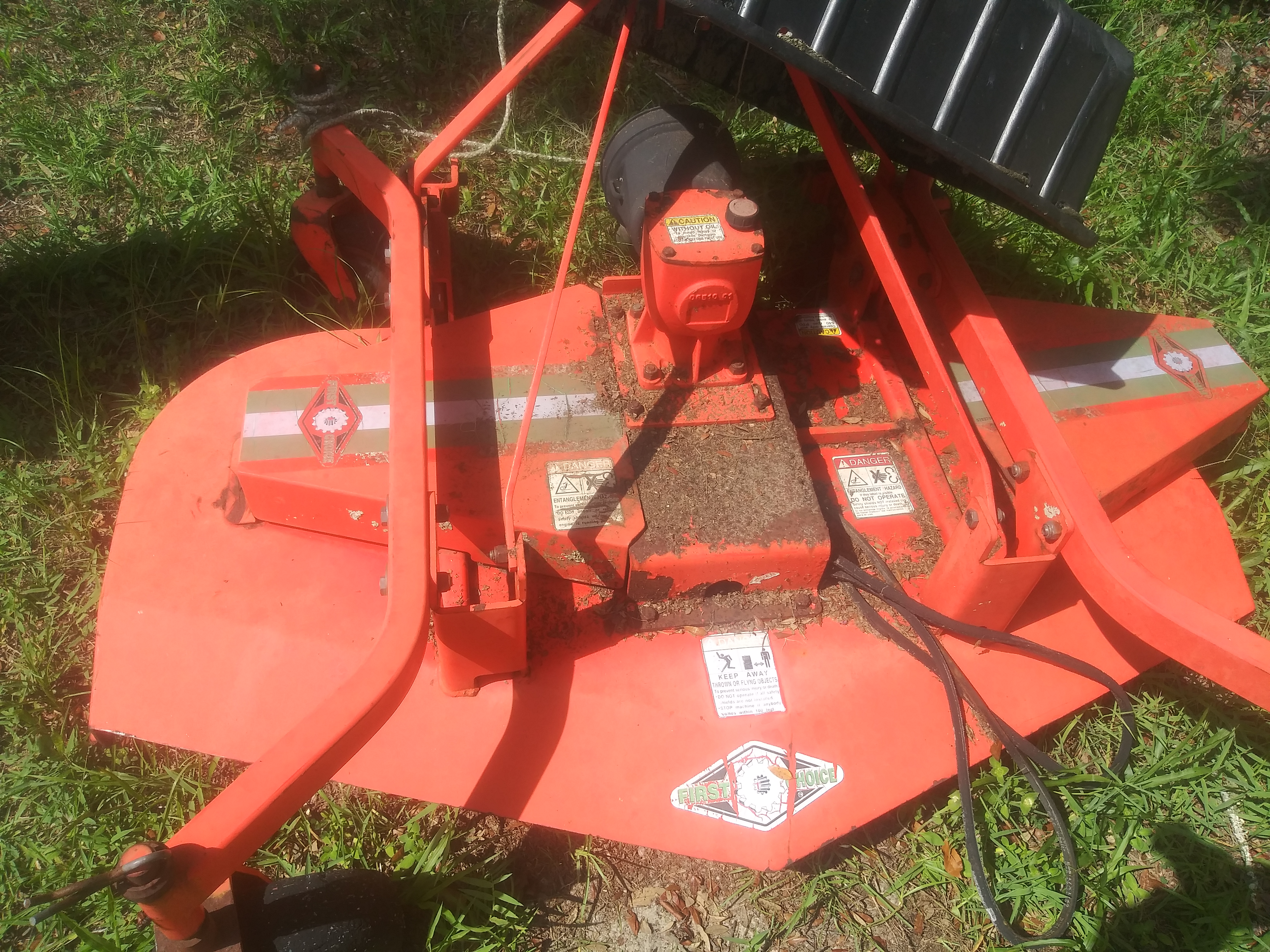

Someone I know offered me this first choice finish mower for 75.00. I know zero about finish mowers.
I know it needs wheels, at least a pulley and belts. Don't know what else.
He knows nothing supposedly about it. He traded it for some paint work.
Deck width is 5 foot. I dont even know if its missing parts to hook it up to my small kubota B series 2 wd tractor.
Looked underneath it and deck is fairly clean with minimal rust. Blades seem to turn freely, possibly smoothly..

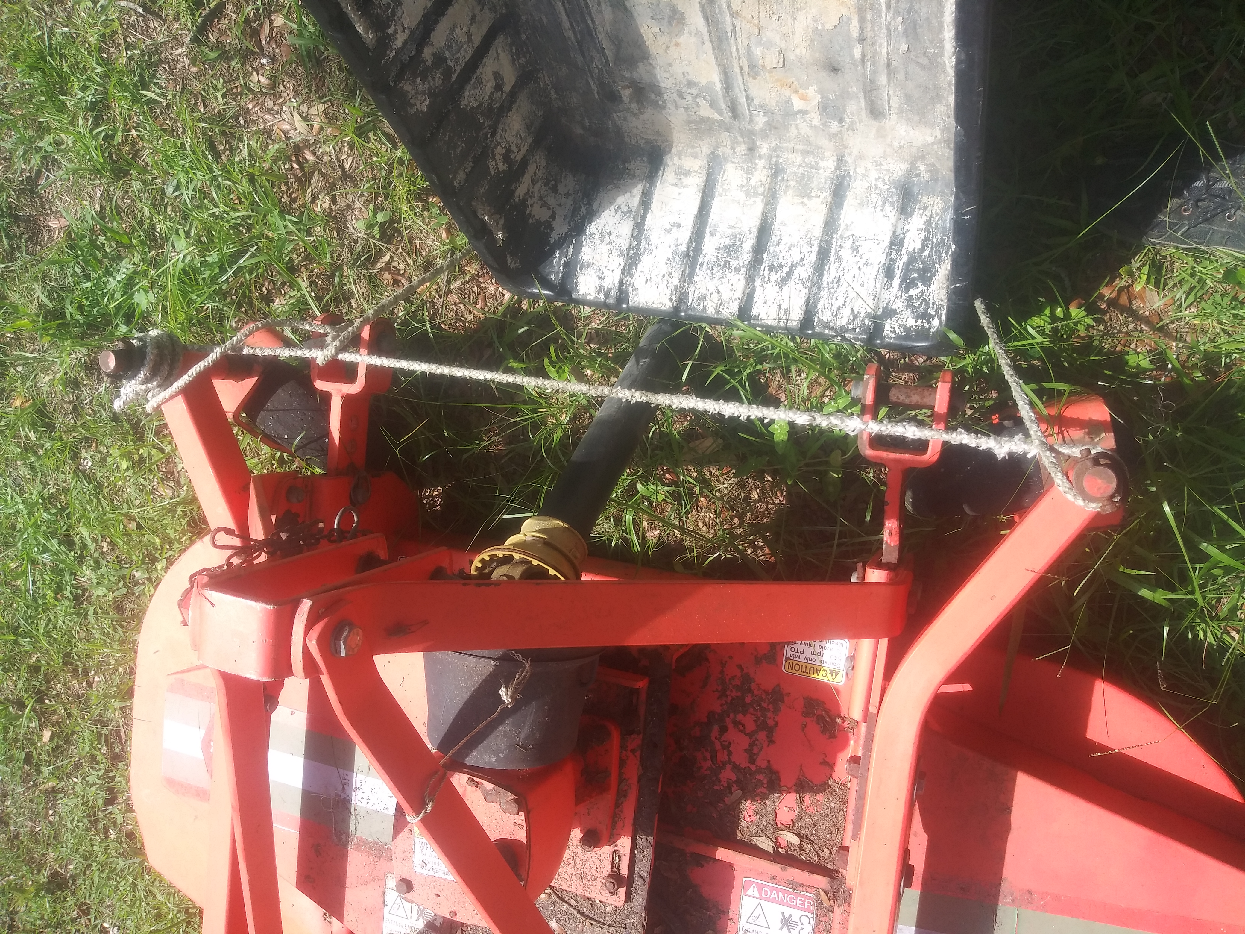

Can you guys look at the 2 pictures and tell me if my tractor is big enough to work it.

Cant find an identification plate but maybe I didn't look hard enough

For that price you can’t go wrong but I don’t think your tractor is big enough.
/ Is this a good deal #4
The PTO shaft alone is worth $75. It is large for your tractor, but might work if you drive slooowly. I would buy it, use it, look for a 4 foot model, and then sell this one.
/ Is this a good deal #5
/ Is this a good deal #6
12hp & 60" is 12" too far.
You can get away with a 48" mower but 60"?
Your tractor doesn't have the hp to turn the gear box and spindles with any sort of efficiency.
Like airbiscuit says:
Buy this and sell it. The profit will buy a nice 48" for you to use.

I don’t see the second half of the pto shaft in the picture.

Based on what you've posted I would buy it and decide what to do with it afterwards. To answer your original question, yes that is a good deal. As others have pointed out if you don't keep it you should be able to sell or trade it as it sits now, and still come out ahead.
Pulleys are cheap, belts are maintenance items anyways.

I see the wheels alone are 100 a piece. 1 is missing completely and I think the other 3 are badly damaged.
Sometimes a good deal isnt so good.

The mower gets good reviews elsewhere on TBN. If you can get a 5/8" to 1/2" bushings (a piece of 1/2? copper pipe?), these $9 wheels could be made to work.
1" x 2-1/2" Solid Rubber Tire

I went back and looked at it again, its within driving distance of my tractor. I took it apart and brought it home, Im home now so I can do a better job of finding parts/info.
The second look convinced me it is in overall pretty good shape. Im in no rush for needing to use it so I figured for the 75.00 I can piece whats missing or broken over time.

I used to mow my yard with a ford 1220 with a woods rm 59 , plenty of powerwith 17 gross hp. Cut lots of tall grass with it to . As long as the spindles are good you can get tires for less than 100 bucks , I would buy it .
