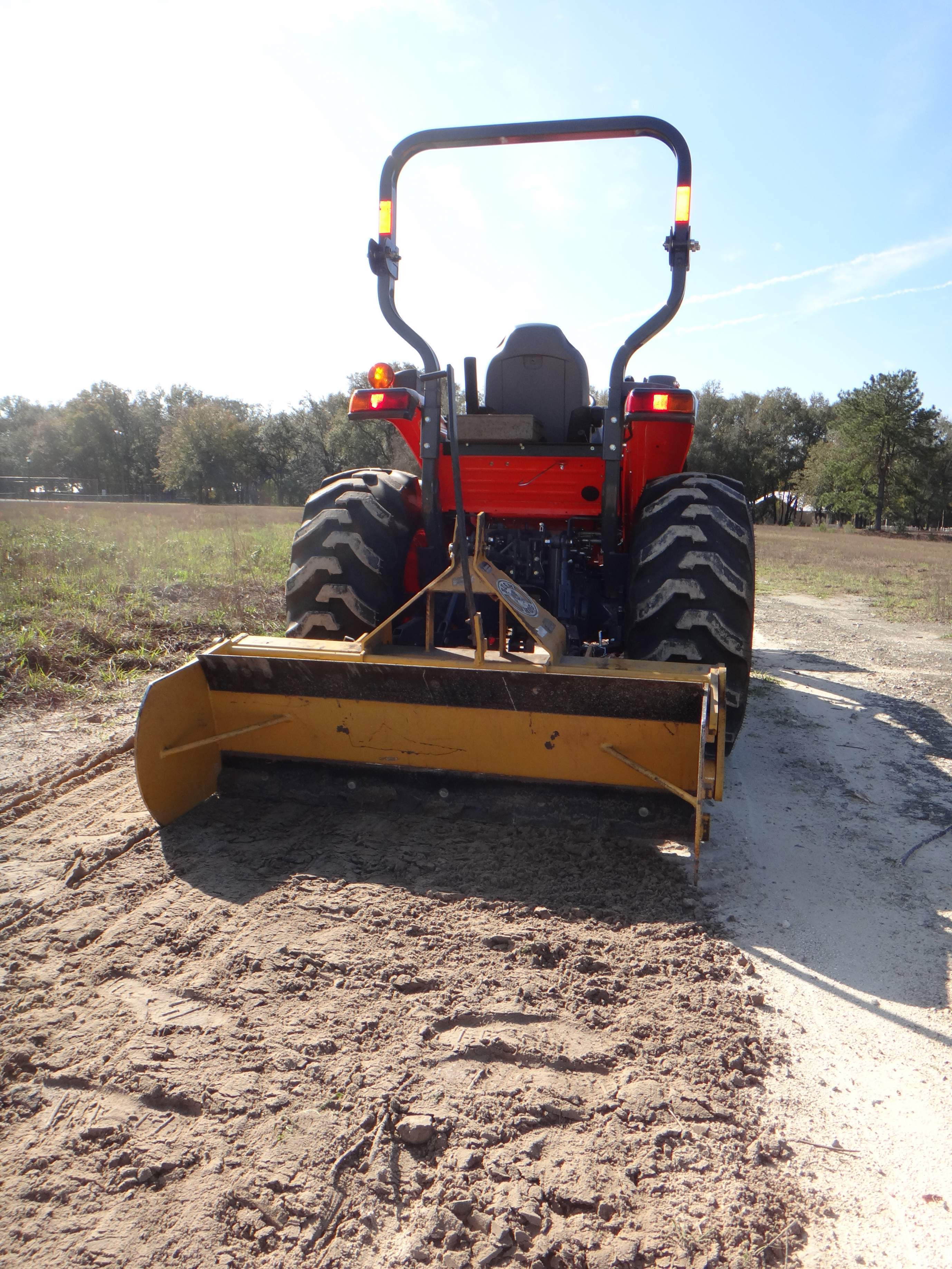

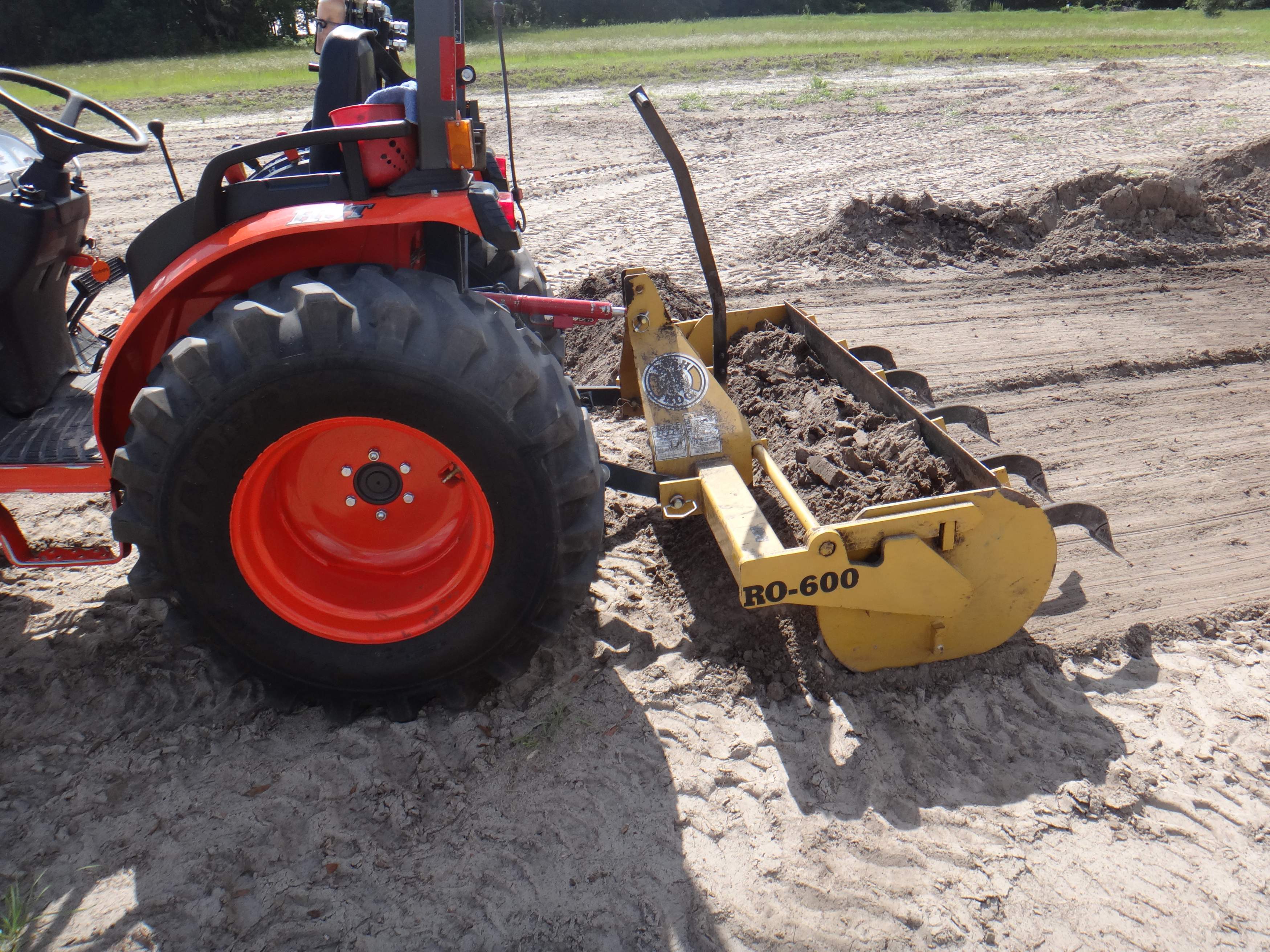

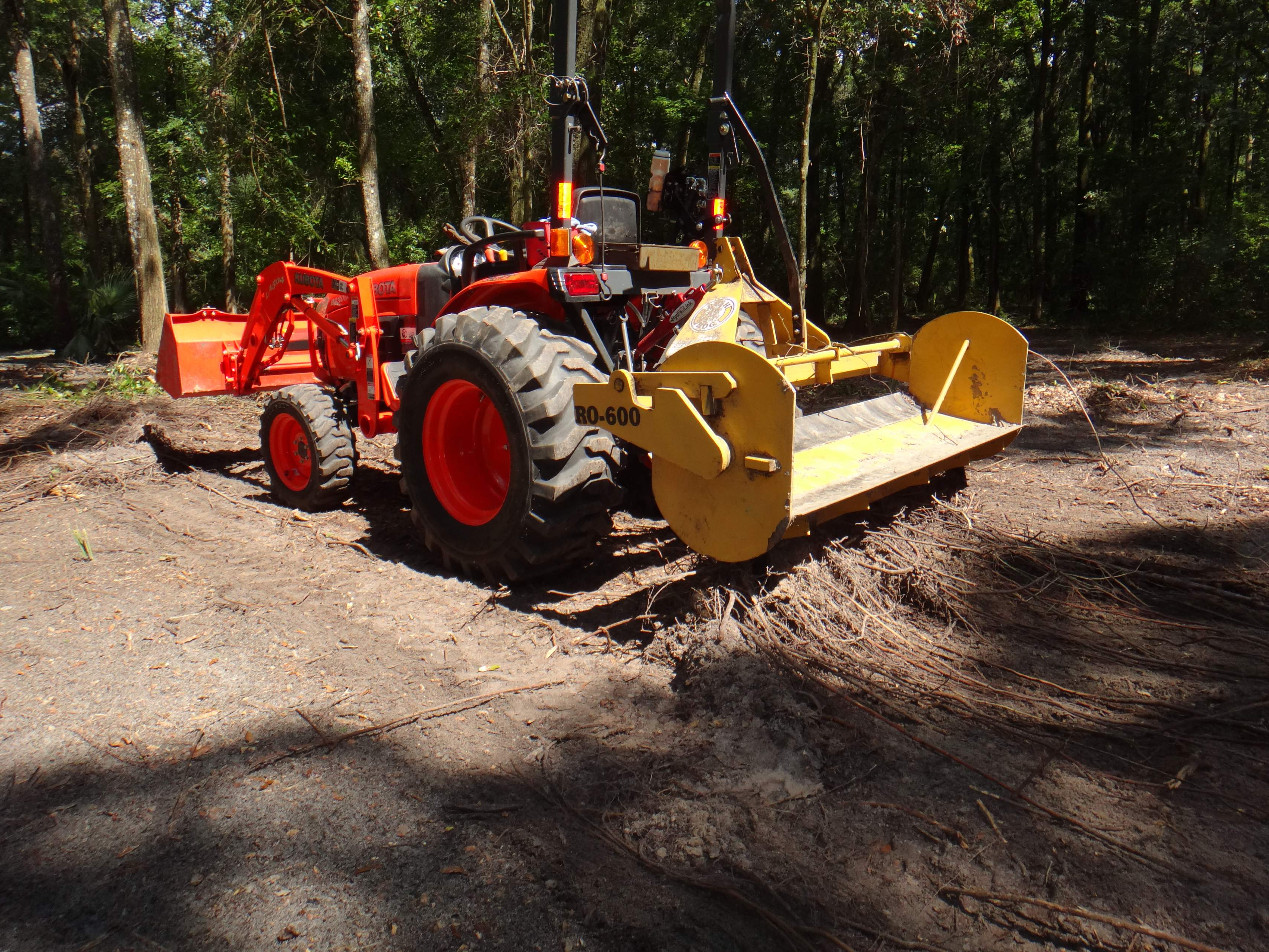

The key metric is weight per unit of width.
100 pounds per foot is OK. 125 pounds per foot is better. 150++ pounds per foot is nirvana.
Pictured Bush Hog (brand) 60" Rollover Box Blade weighs 630 pounds = 126 pounds per foot.
Soil: Florida sandy-loam.

/ Is there really a difference in box blades? #7
I have the Bush Hog 72" ROBB(RO720). Looks exactly like what jeff9366 has pictured. It weighs 710 = 118 pounds per foot. With my hydraulic top link it does a great job of moving dirt. I also have a 400 pound concrete block that I can place on it for added weight. I've found that by using the hydraulic top link and the rippers its just as effective as adding the concrete block and a whole lot easier to control/use. I can easily take a deep cut and end up with all four wheels digging.

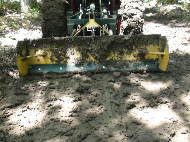

I have the same blade jeff9366 has except in the 72" version and really enjoy the usefulness and quality of this ROBB. My soil is very hard clay and very rocky with rock sizes in excess of 1000#. Sometimes I wish for a heavier blade- one maybe twice this weight for better penetration in my tough soil conditions. In many hours of grading I have only damaged it once in a minor way by bending a shank a couple inches sideways I believe happened when the shanks were digging deep and the unseen tip of a buried rock (think iceberg type of build) happened to pass between the two shanks. Off course, the buried rock would not move so the steel had to.
No lesser BB would work nor survive at my place. Attached is a pic of the type of the rocks (many) I have dug up- initially with the ROBB and then finally with the stump bucket and rock grapple bucket. And the completed job made doable by this ROBB.

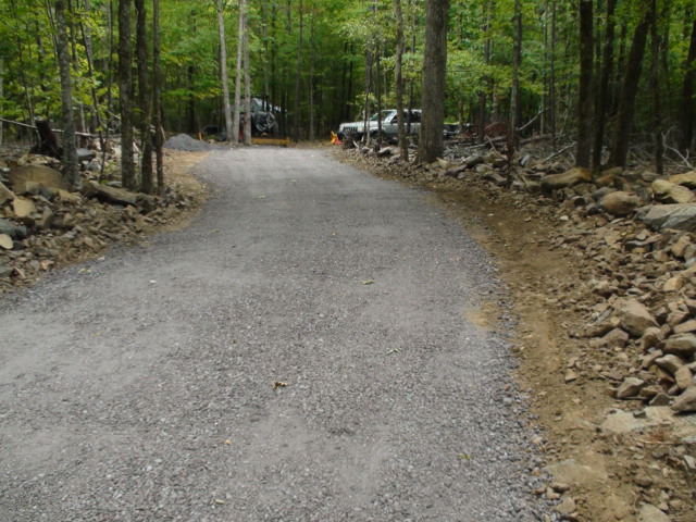

The only way I could fix my mushy/muddy driving surfaces was to grade with a box blade and rake, let it dry out and then cover with larger diameter (2" - 3") gravel or crushed concrete which fixed the muddy surfaces seen in a previous picture I posted. I prefer the crushed concrete as it is less expensive. Most folks will recommend creating a road with a crown in the center and drainage (ditches) off the sides. At my place the best I could hope for was a fairly smooth driving surface a bit higher than the sides in most areas as any grading just brings up more large rocks that creates more grading problems to deal with.
