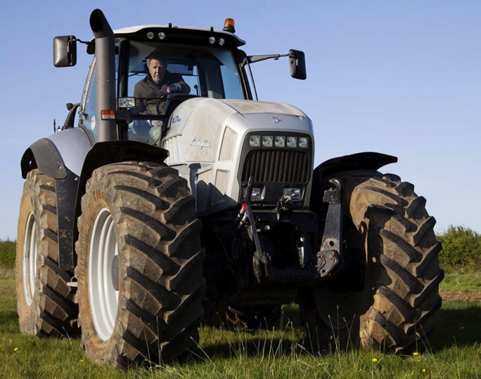

I would expect this is a bit too big for a backhoe.
Pfft I expect Clarkson to have a BH on his machine next season.
looks like it would fit a 3-point "front-hoe". There are numerous tractors out there that have 3-point hitches on the front. Just not the usual CUT. I built a 3-point hitch for my FEL so I could operate a few 3-pt attachments on the front (rake, boom pole, manlift, and hyd mixer). Very useful.
   / Is there any size of tractor that is too big to add a backhoe on it? #45
Much cheaper than skid steer implements off the front!
