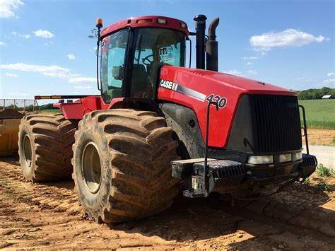

I would expect this is a bit too big for a backhoe.
   / Is there any size of tractor that is too big to add a backhoe on it? #38
Actually if it's not a bareback, it would be a bit clumsy but it would work.
