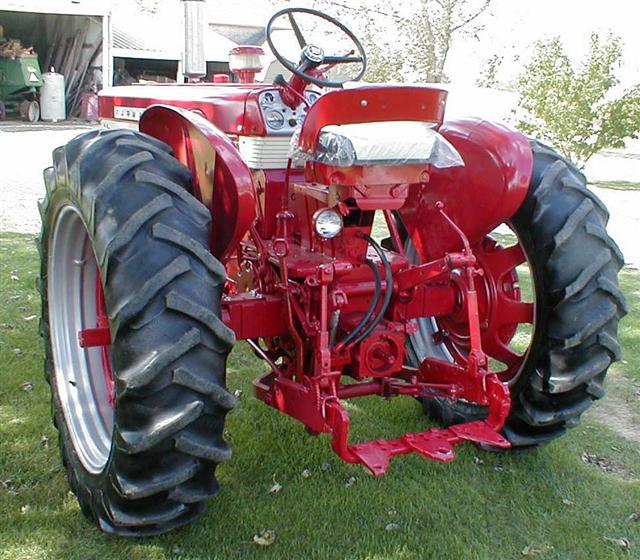

Growing up Green, my Uncle had an odd ball IH 560. Weird beast compared to the Deeres. No fenders, no side hydraulic console, what looked like "after-thought" hydraulic connectors, no foot throttle. ......but now I remember it had no 3PTH either. But it did have a height adjustable hitch /"cross drawbar" that worked off of lift arms lke a 3pth.
Now I'm wondering if the adjustable drawbar also had slots for the IH quick hitch stabs shown on video implements?
We had no IH quick hitch implements, so I wouldn't of realized what I was looking at.
Edit: Found this picture on internet of something similar. Does it looks like the "cross drawbar" was a special attachment that clipped into the IH quick connect slots of the tractor?

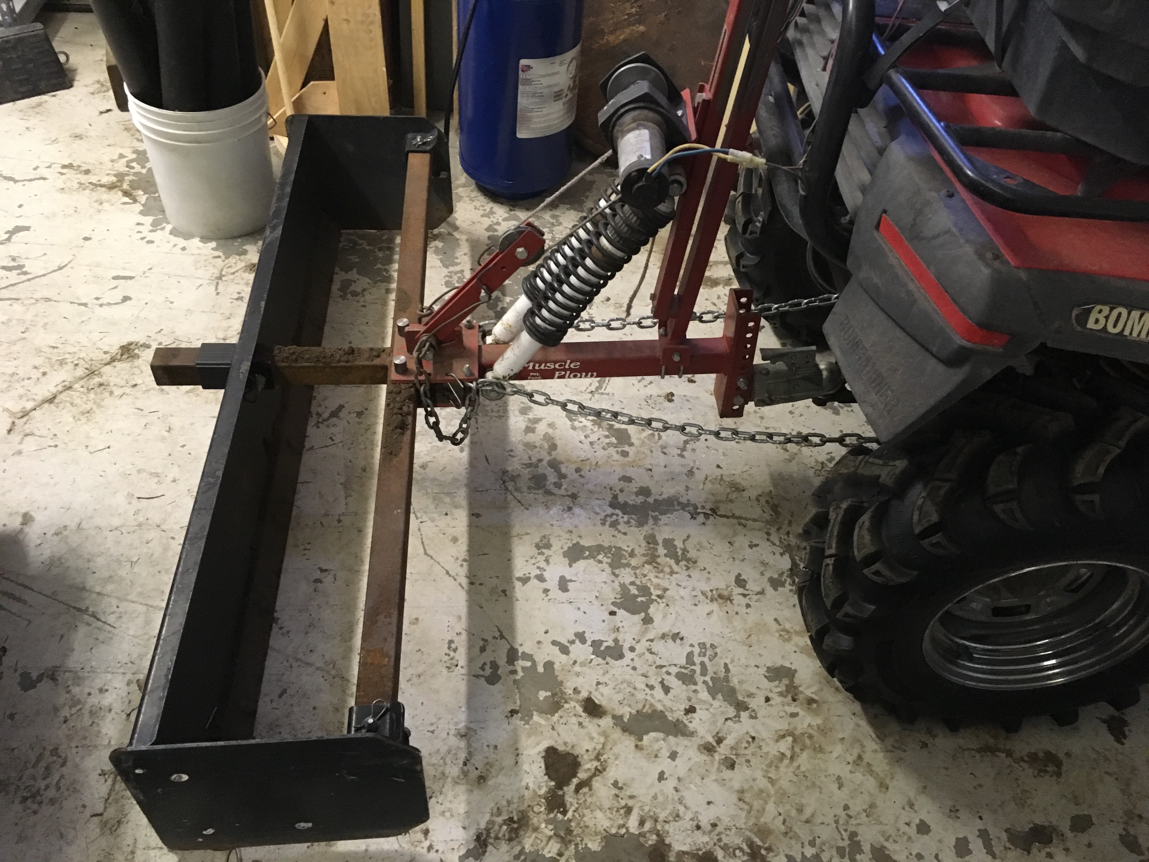

Years ago I had a project for my ATV and implements that required more down pressure on the implement. I couldn't just add weight due to the ATV not handling the extra weight so I built the following. It allowed me to make the implement more effective without adding the weight. It is adjustable so I can vary the amount of down pressure on the implement and it is forgiving so if the ATV back axle dropped into a ditch it would allow the implement to raise up so I could get thru the ditch.
I haven't looked at it to see if the same principles could be applied to a tractor but where a tractor will handle a lot more weight I think I would just add the weight to the implement.
Very interesting idea! Might call it a "modulated down pressure kit".
Edit: The more I think about this the more interesting I find it! I don't see why the same principles couldn't be applied to a tractor 3PH.

Couple questions on the IH quick hitch: How is the side-to-side tilt achieved and how does it get around not having a top link for adjusting fore-aft? Anyone know?

I never used one with the side to side tilt. Saw a few on the smaller tractors it was an expensive option in addition to the fast hitch option.
It worked off an elliptical type unit mounted up under the fuel tank that went down to the front of the lift arms.
I can recall 3 styles of fast hitch, a two armed small, a larger 2 armed unit and a single armed one.
I'm thinking the single arm was only on the 100 and maybe the 200 models.
The other small tractors up to the 340's I believe had the small 2 arm style.
I believe the 300 may have been optional on the small or large arms.
The 400's , 460's, 560's and 656's with the fast hitch used the large arms.
The front portion of the wish bone of the hitch was mounted up under the tractor and was the pivot point,
the arms coming back to the lift point had a flex joint that could be pined to have down pressure or unpined to float.
One side had a crank adjuster for leveling. If you look at the picture that CobyRupert has posted you can see the arms and lift actuator.
The draw bar in that picture is the fast hitch draw bar with hitch plate bolted to it we usually only had one hitch plate on ours.
With those arms there was no need for a center link the arms supported the implement.
With the pins in to provide down pressure you could roll a block of wood under one side of the draw bar and jack up the tractor,
to change the tire spacing for plowing or cultivating or stability. Or even repair or change a tire.

Thanks for the info. Never too old to learn. I still don't understand, however, if there was any adjustment for front-to-back tilt and, if not, how an implement such as a moldboard plow could be adjusted to run level front to back.
