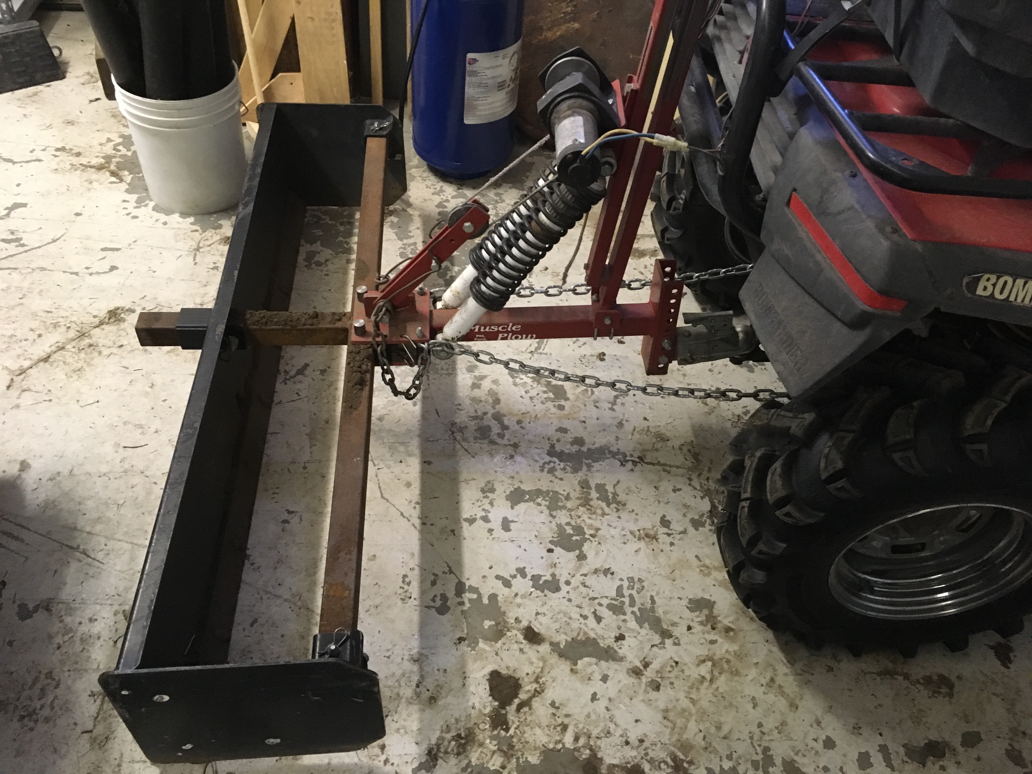

Years ago I had a project for my ATV and implements that required more down pressure on the implement. I couldn't just add weight due to the ATV not handling the extra weight so I built the following. It allowed me to make the implement more effective without adding the weight. It is adjustable so I can vary the amount of down pressure on the implement and it is forgiving so if the ATV back axle dropped into a ditch it would allow the implement to raise up so I could get thru the ditch.
I haven't looked at it to see if the same principles could be applied to a tractor but where a tractor will handle a lot more weight I think I would just add the weight to the implement.

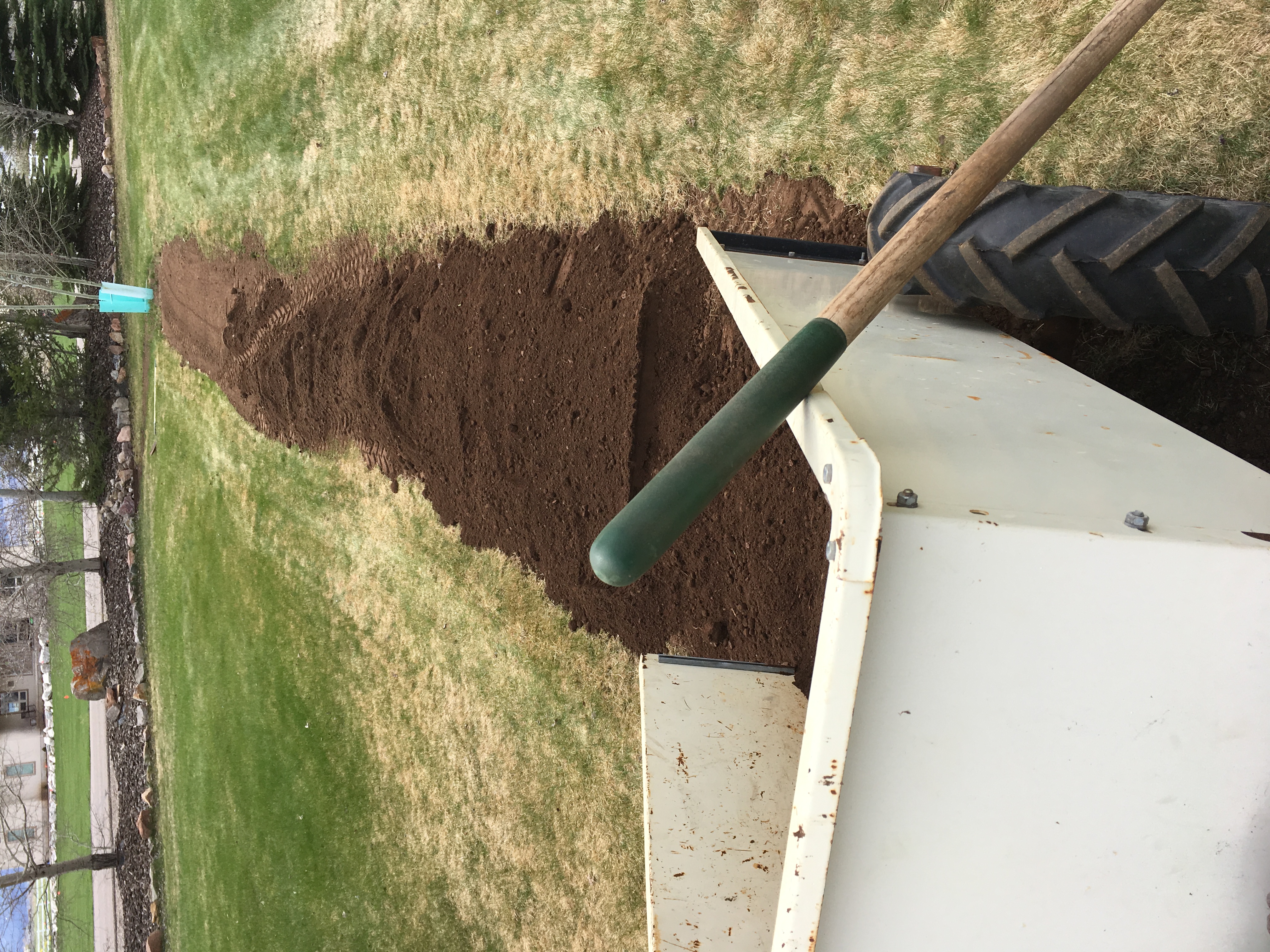

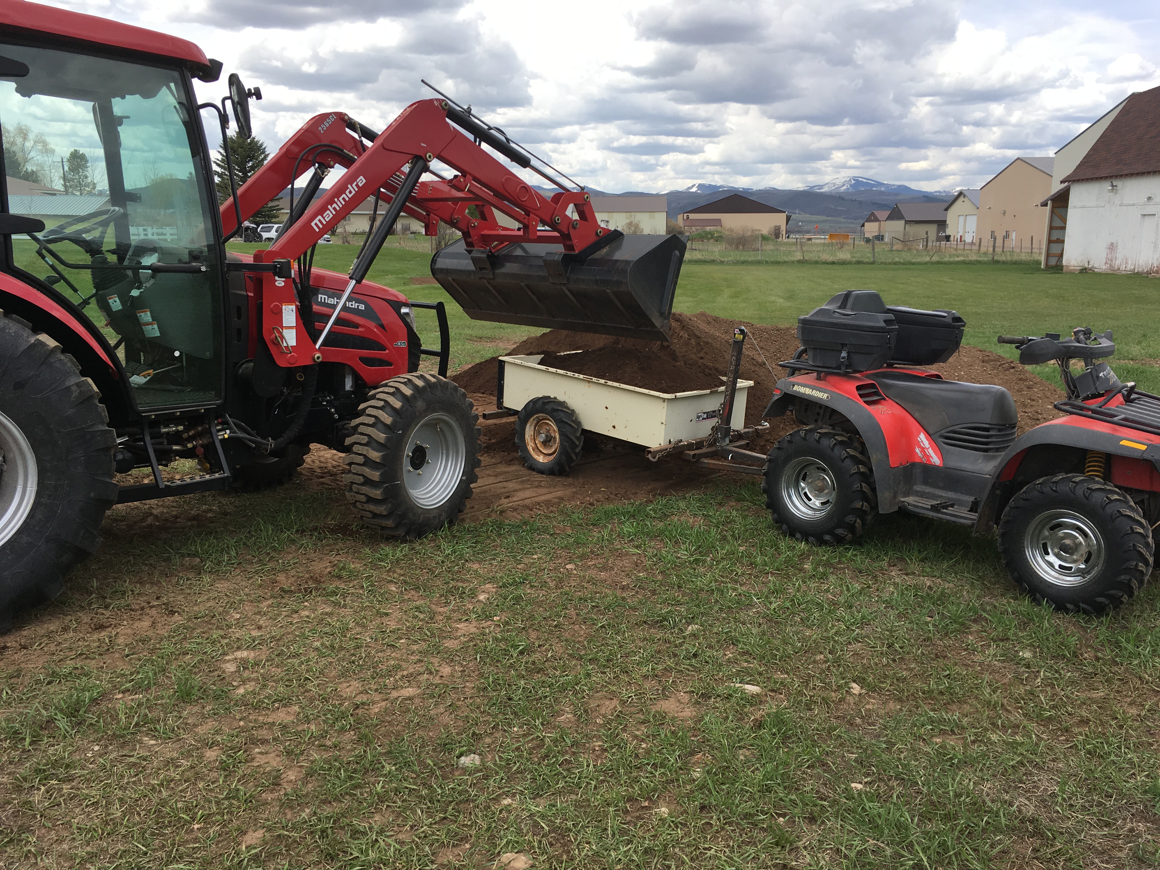

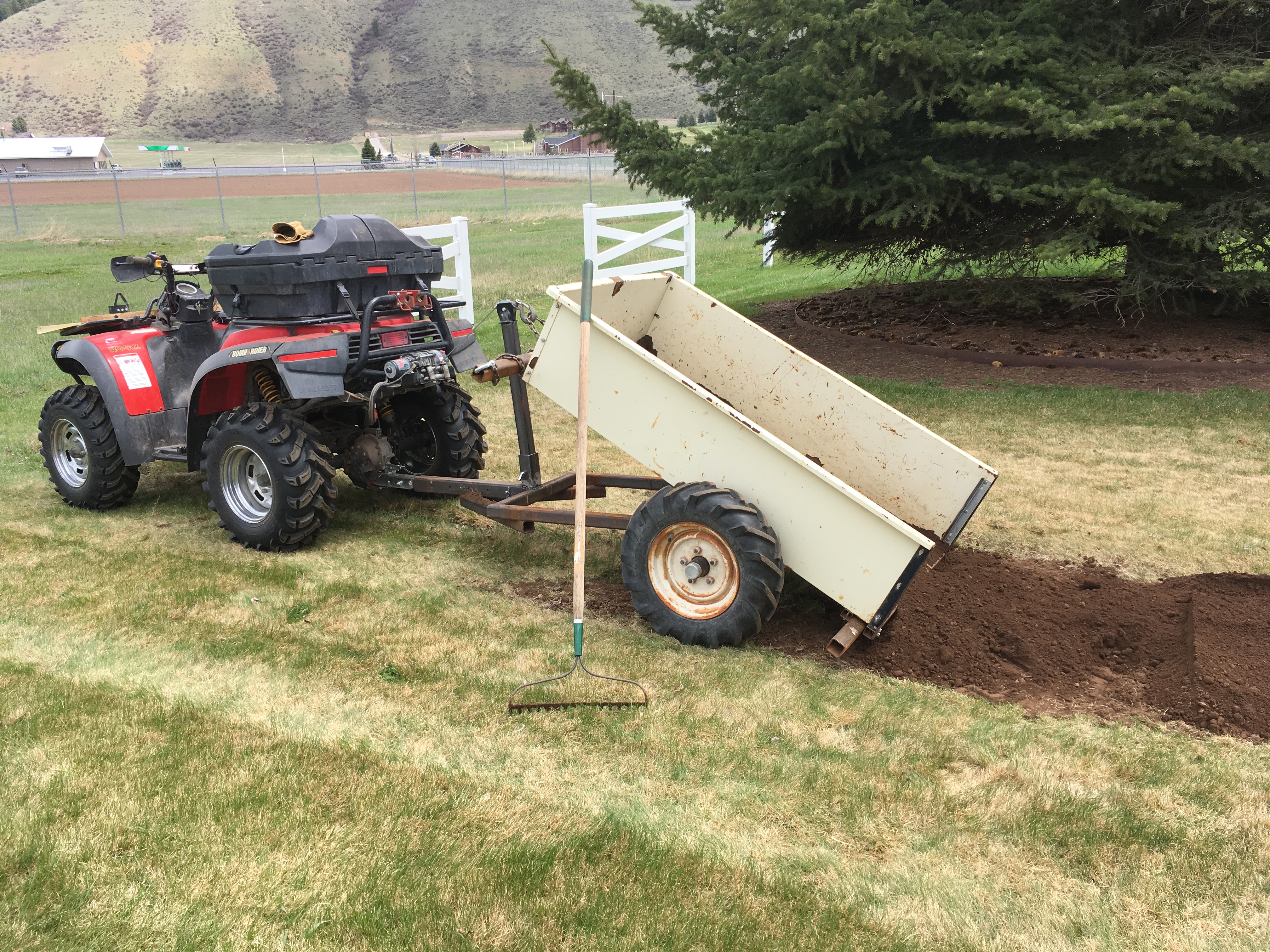

A little follow up, a ditch ran through our front lawn that was a pain to mow around so last summer I decided to fill it in.
I didn't want the tractor on the lawn due to the sprinkler system so I used the tractor to load my ATV dump trailer as shown.
Then I would dump the dirt in the ditch. I use the winch on the back of the ATV to dump the trailer.

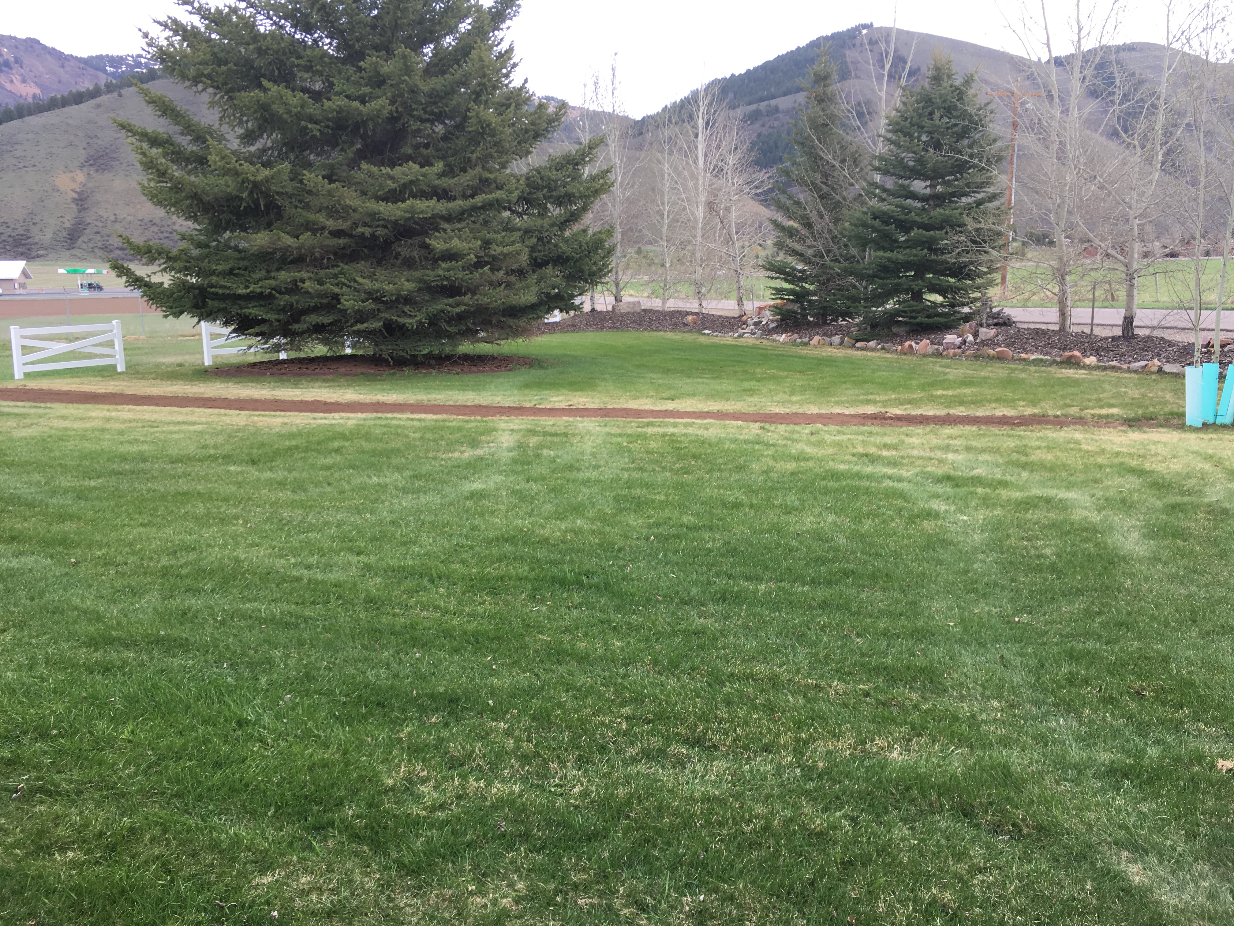

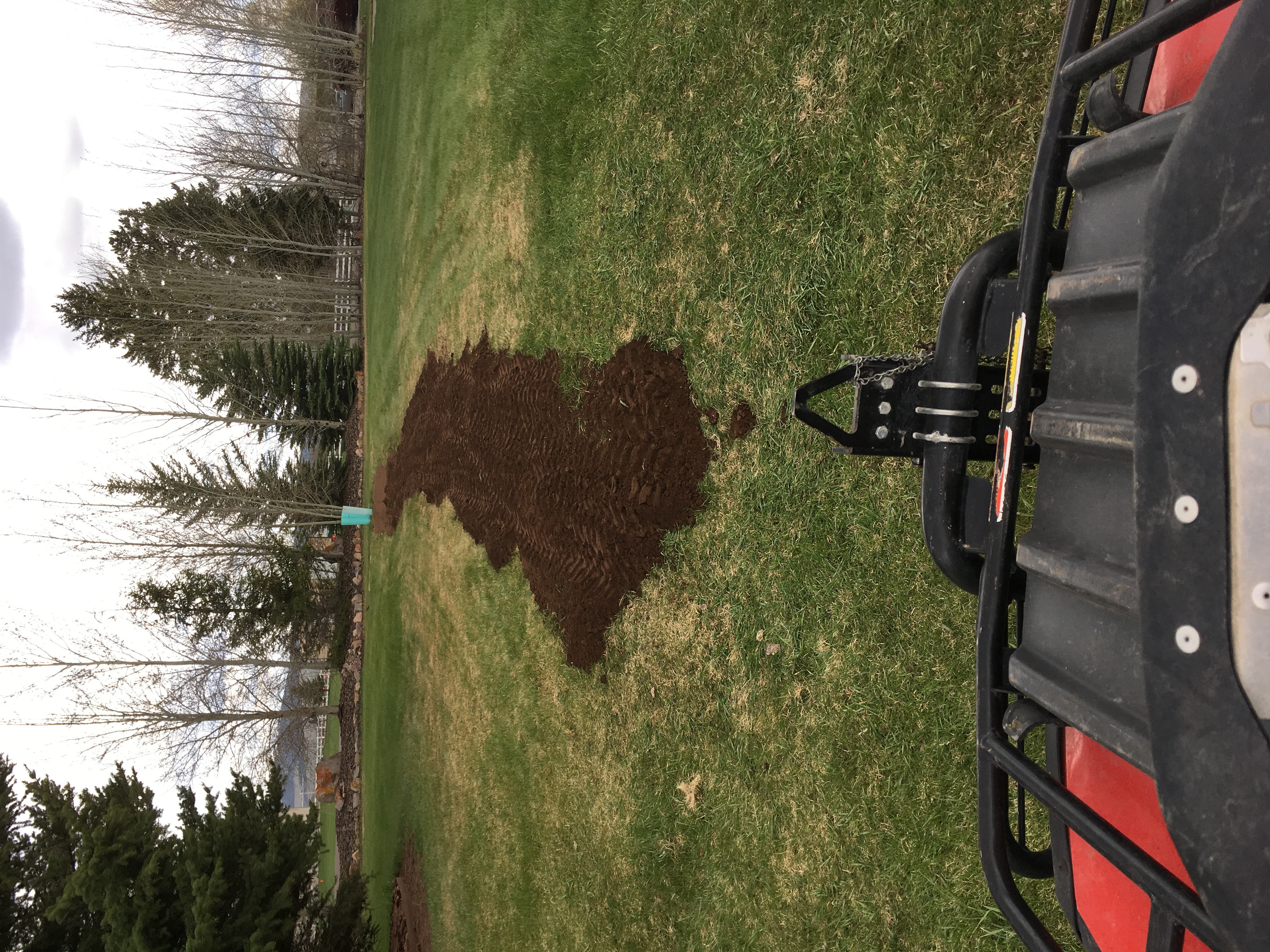

Next I used the box blade to spread the dirt and the ATV tires to pack it down.
The finished result.
Very little hand work and it didn't take much time to finish it.
Not sure why the two pictures ended up sideways, I don't know how to fix them.

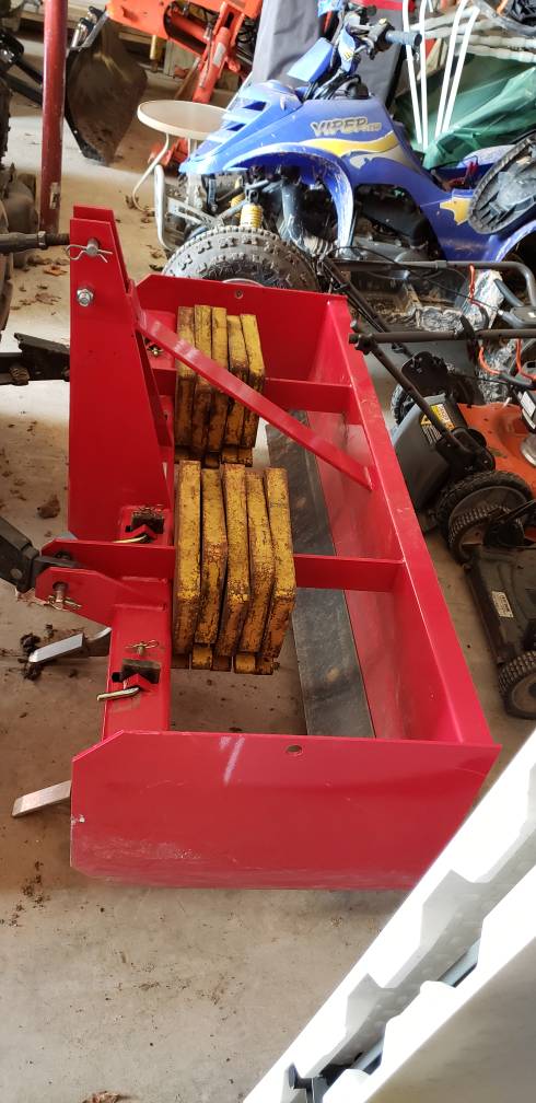

What about adding 400 lbs or so? It makes a massive difference in a box blade...20190314_162445.jpeg
