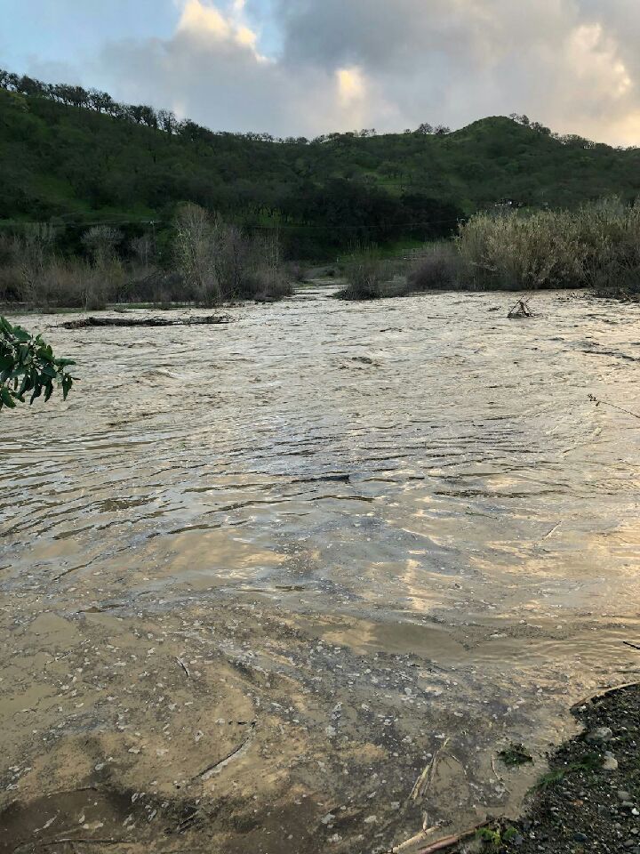

Brian that is a very nice Dozer. I知 in the market for one and I will also look for a case 310. We got a lot of rain this year and the runoff over flowed the creek bed on our property. I probably have several hundred yards of dirt I need to push back up to build up the embankment.
This pic the water is about 4 feet deep.

While I love to look at water, I do not envy those that have to deal with the damage that it can do.
