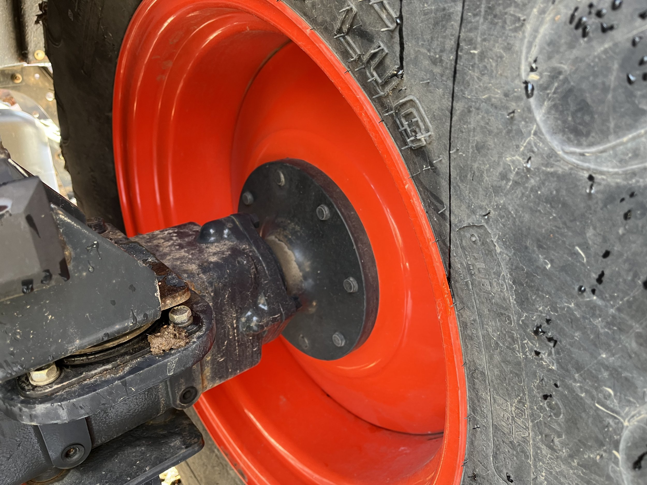

Many of the larger tractors with R4's are on adjustable rims, need a picture of your rear rims to say.
/ Is rear tire width adjustable? #6
Like Lou says. depends entirely on the rim configuration and not the ire mounted. Need a picture for sure.

Take a pic of your wheels and show here. Then someone could tell you if they can be adjusted or not.

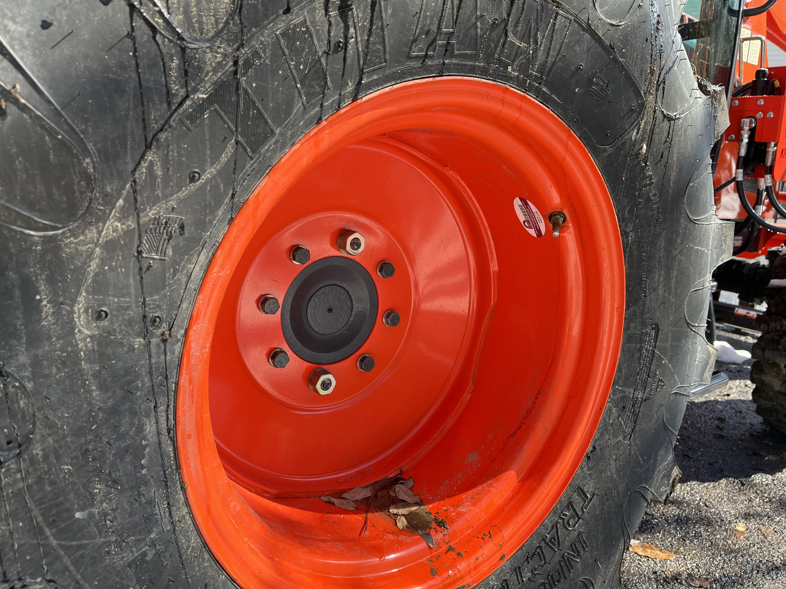

Attached are some photos of the rear tires. Current trailer is 14k GVW, so no weight issues. Just need the fenders to be moved out an inch on each side. But not enough clearance to trailer tires without rubbing. Would love to buy a new gooseneck deck over trailer. But hard to justify to my wife. Just bought the tractor, some attachments, a class A motorhome, vehicle to tow behind it, and new zero turn in the works. Maybe I can buy it and just tell her I'm storing it for my Dad!

NOT adjustable for track. Good luck on the motorhome. Talk about sticker shock, there it is, in spades. Terrible fuel mileage and exceptionally high fuel cost will result in extreme wallet drain.

Afraid those are non adjustable rims, and loaded with beet juice.
Won't be cheap but new 16" wide rims with separate centers will likely be your best bet.

It sure looks to me like it would be narrower if the wheels swapped sides. Keep thread direction the same but switch sides,
The rim surfaces look flat so should bolt up nice. You wouls lose a little bit in stability from having a narrower tractor though, Plus the valve stems would be on the inside.

For sure those aren't adjustable, I just learned something new, it's another good day.
