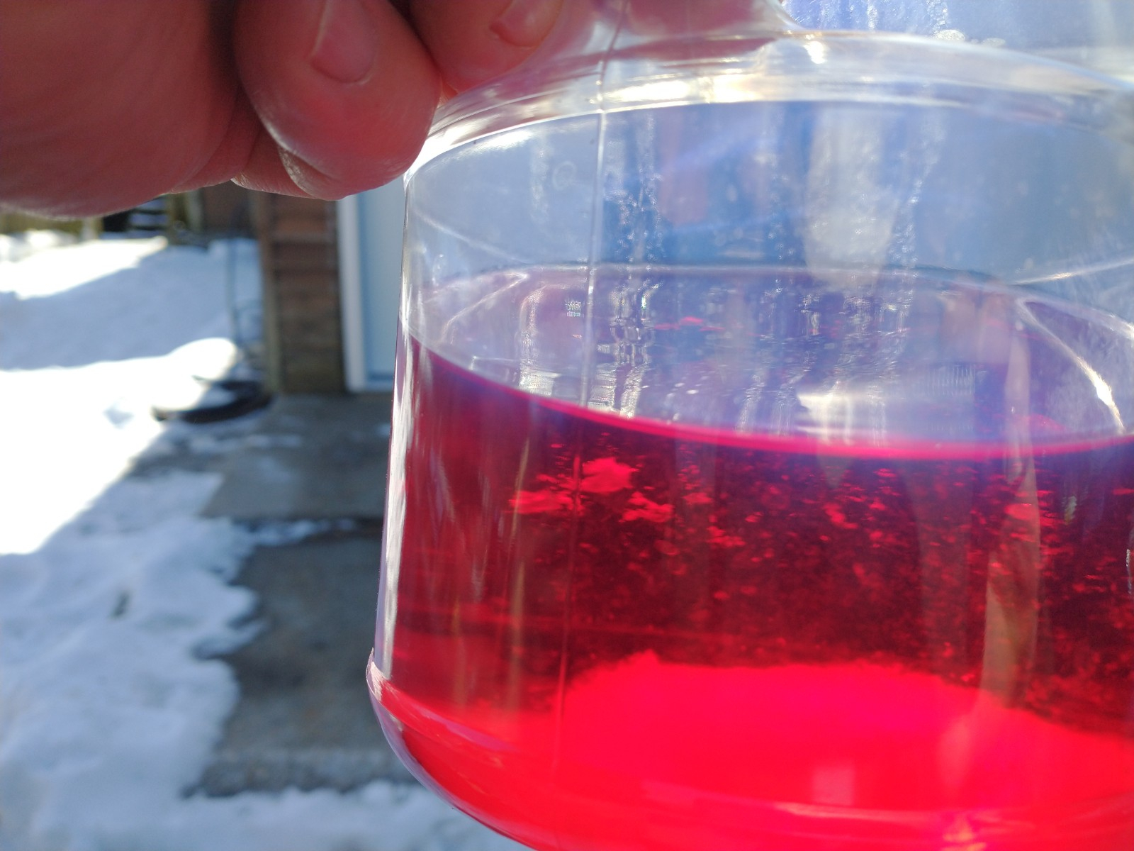

Well here is some info on #2 Fuel with double dose Power serve,
picture from 5F (-15C);
same bottle at -14F (-25.55C);
Lots of cloudiness from paraffin particulates that would plug a filter and bring a diesel to it's knees.
The same fuel in the tractors that had to run today had kerosene added to them to make a 50/50 blend of #2 and #1,
they are running and working.
Anything with this fuel wouldn't be running for long. The filter would be plugged.
