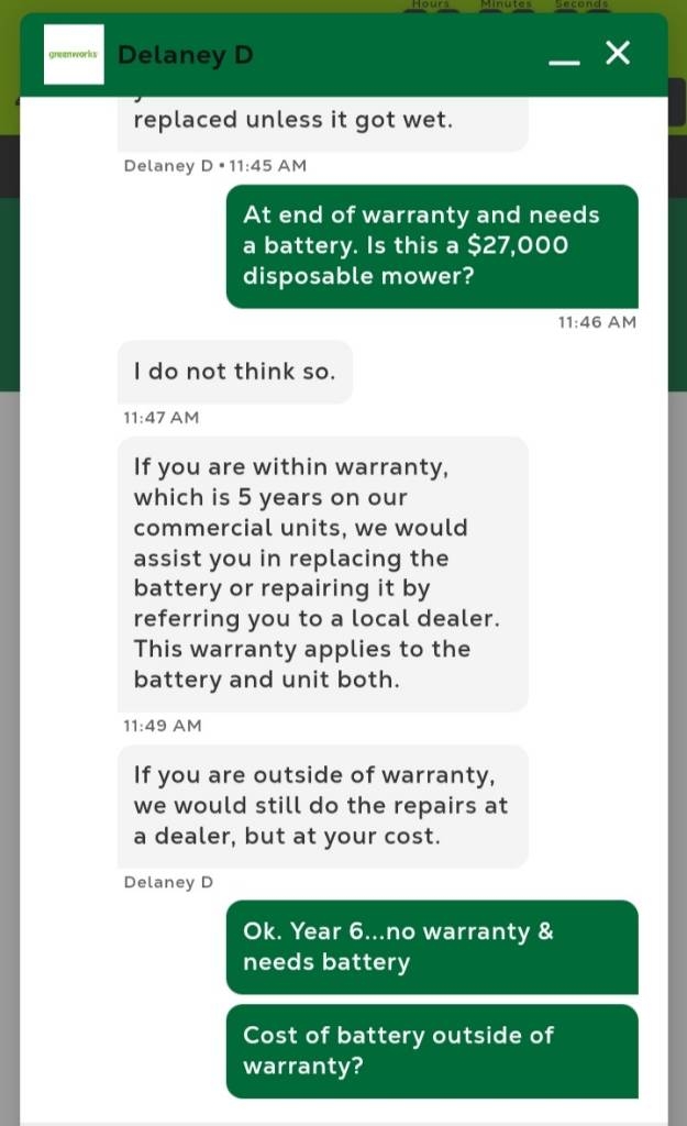

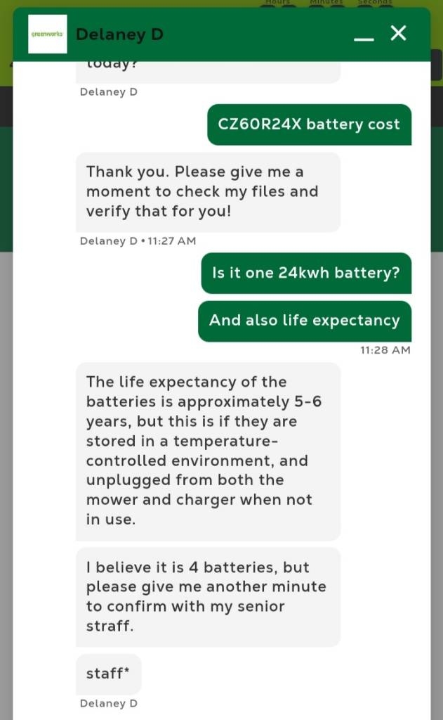

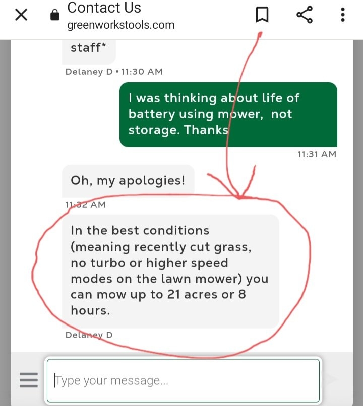

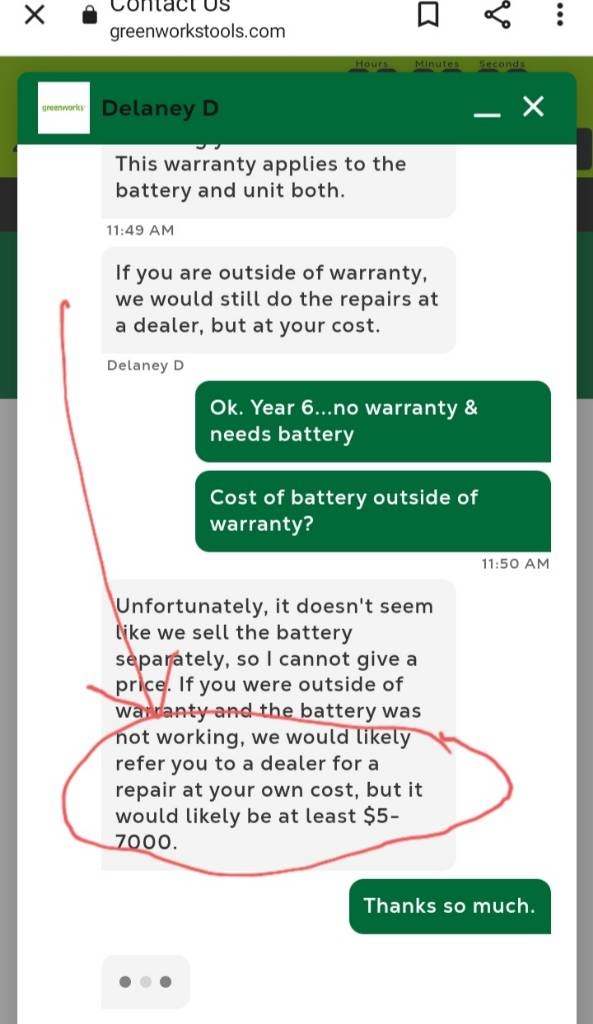

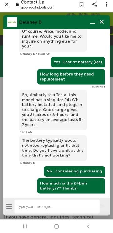

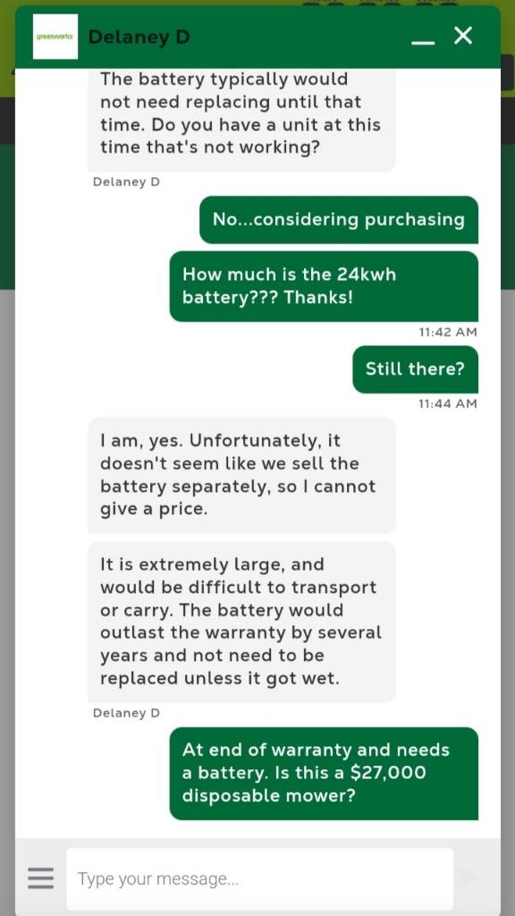

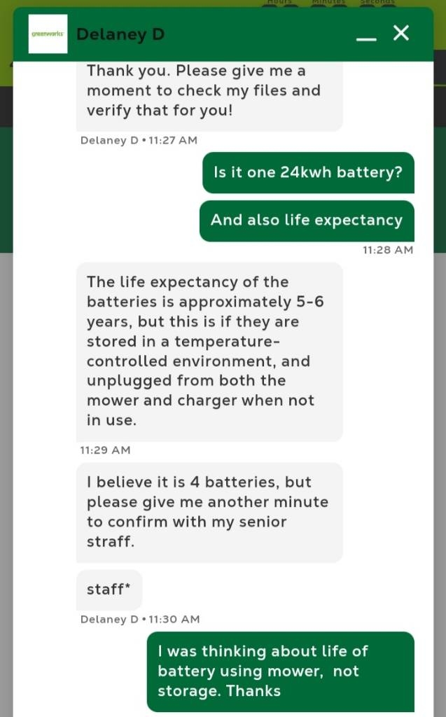

$28k battery lawnmower. That’s insane
Here we go!!! I just now chatted with Greenworks. Please read!!!
/ Is it time to consider electric? #111
So NOW...electric or petroleum?
Hmmmmm...let me think...
/ Is it time to consider electric? #112
I love that "recently cut grass" part! Grass has been cut...flat, level, 21 acres 8 hours...gotta love it.

Ok, interesting conversation. And, I doubt there is an easy and safe way to simply unplug the 24kWh battery pack. It is probably better on float charge.
$5K to $7K replacement would not be unexpected. Then again, in 5+ years, hopefully you've saved more than that in gas.
Prices will be changing over time. One question is whether the company will have long term support for their equipment.
In the EV and hybrid market, there are 3rd party companies that are rebuilding battery packs for much less than new replacement.
/ Is it time to consider electric? #115
Let us know how it works out for you.

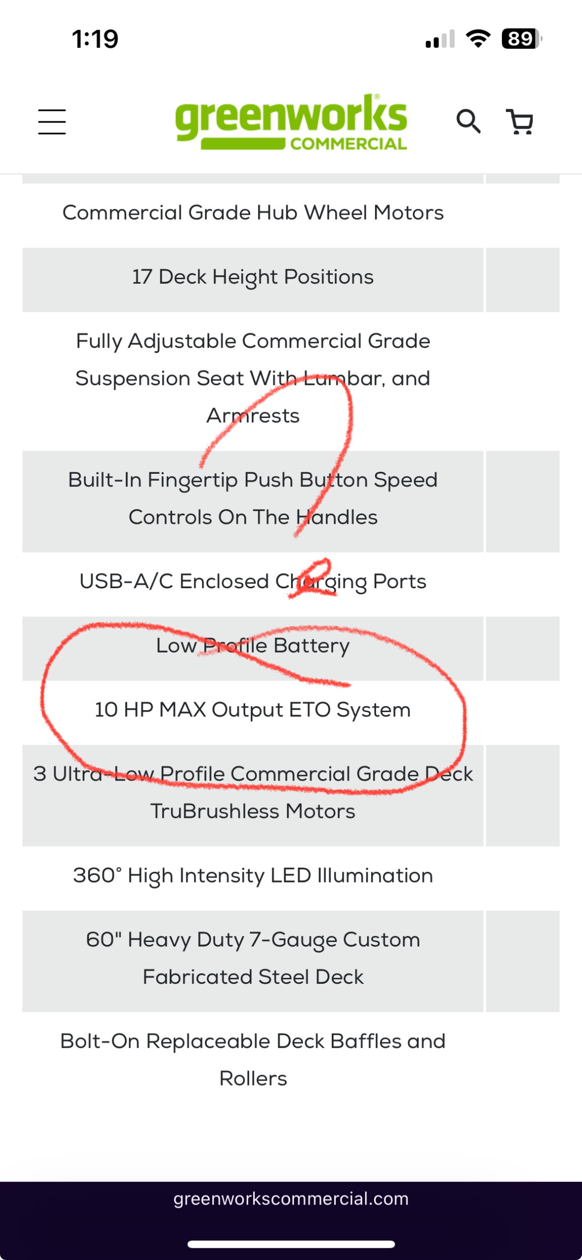

Notice nothing in the specs about 65hp?
It’s, almost like some marketing guy….just made it up.😉
/ Is it time to consider electric? #119
Ok, so what the heck is an ETO?
I found on another site, perhaps for an older model: "Electric Take-Off (ETO™) Power Port for added versatility of front hitch power accessories"
There appears to be a front mounted receiver hitch.
So, that appears to be a power out port of some sort. Unfortunately I'm not seeing any accessories for the Greenworks Commercial mower. I'd expect at least an optional bagger. Perhaps they'd make one of those wheel type orchard and fence mower accessories.
It doesn't appear to be related to the actual drive power or deck power of the mowers.
