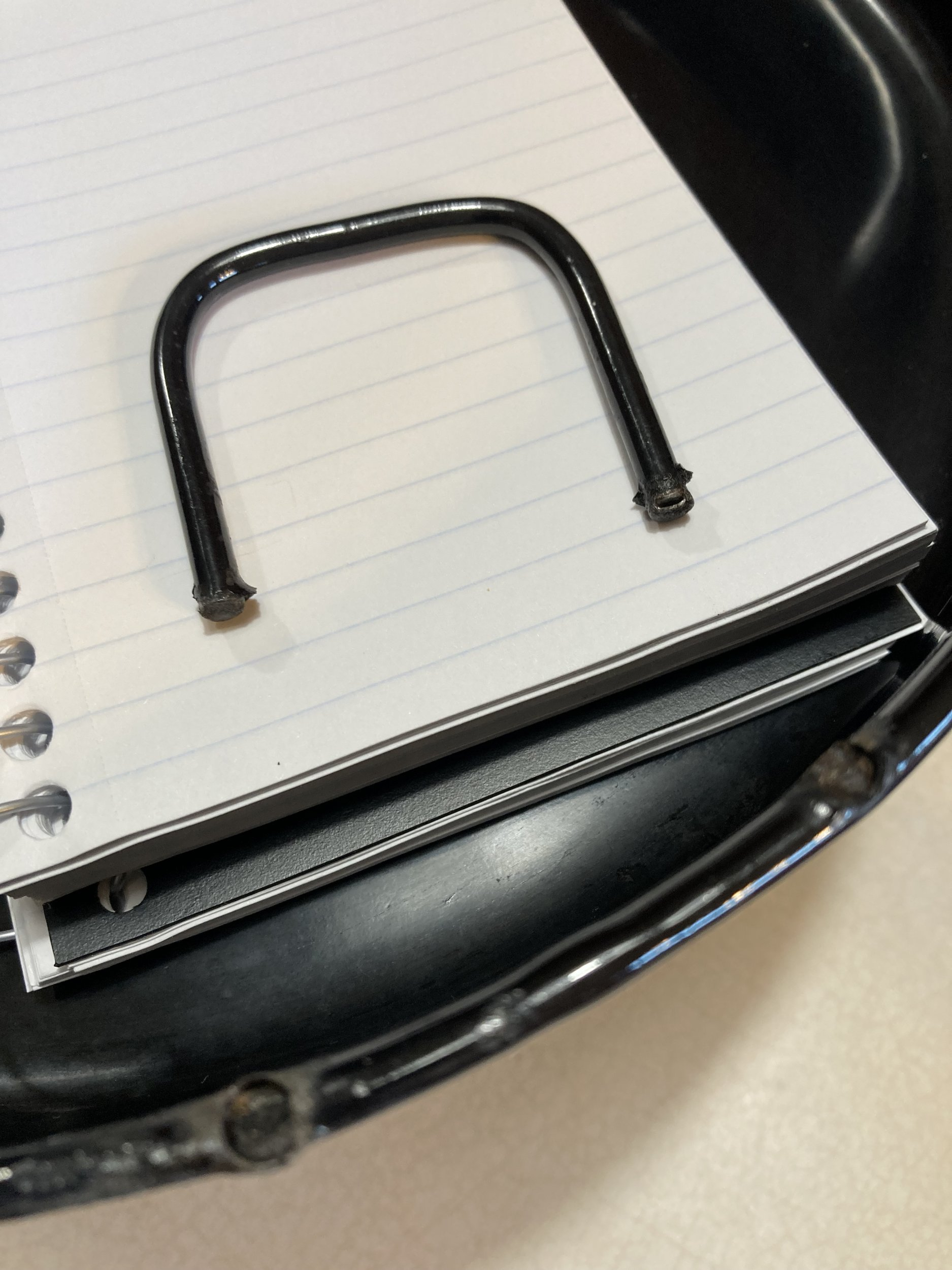

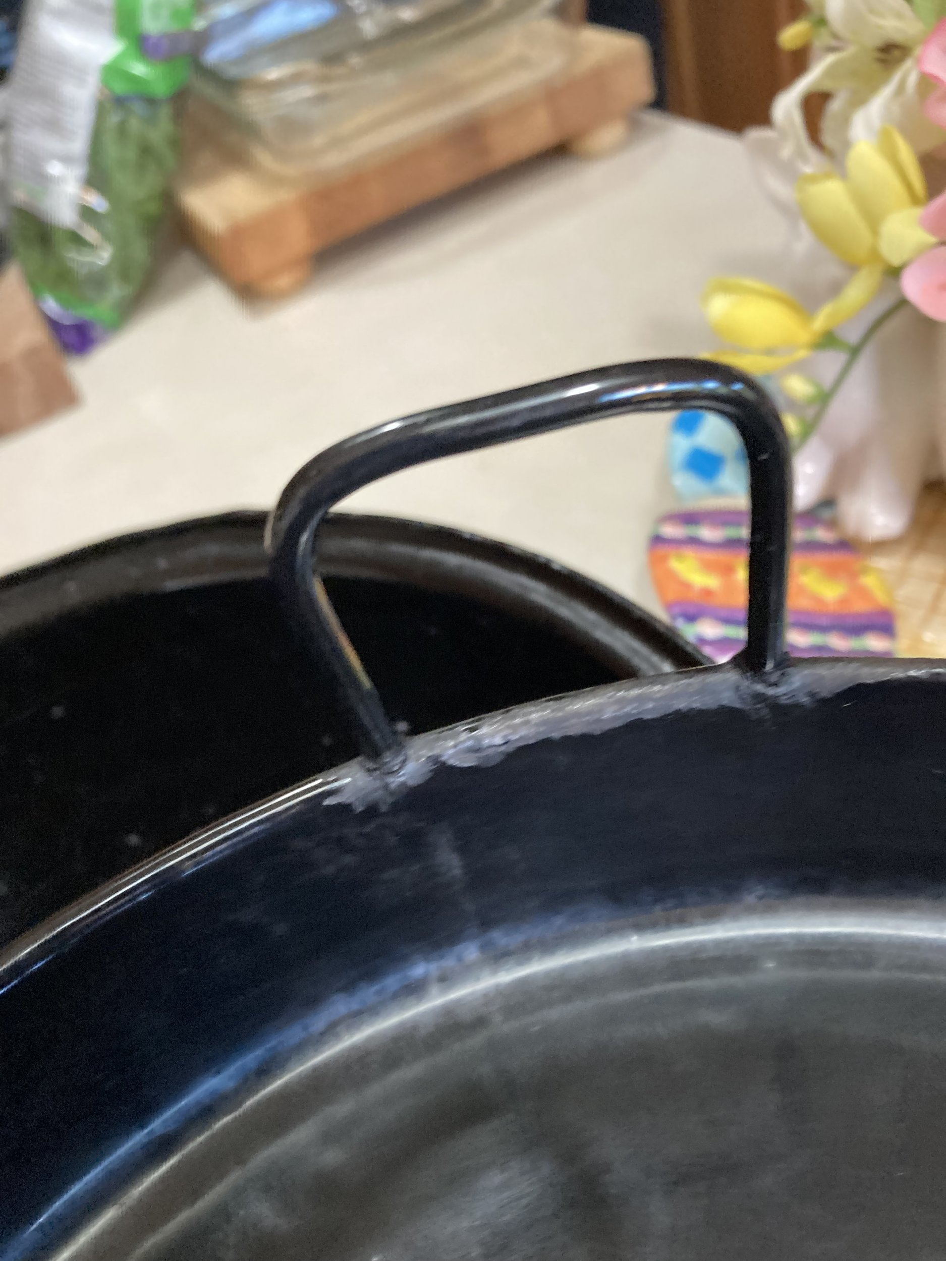

The handle let go on my wife's turkey roaster pan today on a ham. The wire handle was just spot welded into the pan and then ceramic coated. I could easily clean that up and just tack the handle back into the pan but the wife isn't sure it would then be safe to eat out of. I don't see any problem since it was welded once so why not again? Just a simple MIG weld but no ceramic coating over it.
You guys know more than I do so any advice on this? Photos below.

how are you going to ground it ?
   / Is it safe to weld my wife's turkey roaster pan that we use for cooking? #4
If I need a ground and don't want to grind off a lot of coating, I'll use a chunk of rod, and tack it where I've already ground for the repair. Might have to move it once during the process, but it's the least intrusive way to do it.

Yeah there is no food safety issue using normal MIG hard wire - ER70S, probably. It is just steel, like the rest of the pan. Well, I guess I am assuming it is a steel pan and not aluminum or something else... That would be an important point.

It's a steel pan and she just gave the go-ahead to weld it so it's on the list. I'll ground it one way or another.
