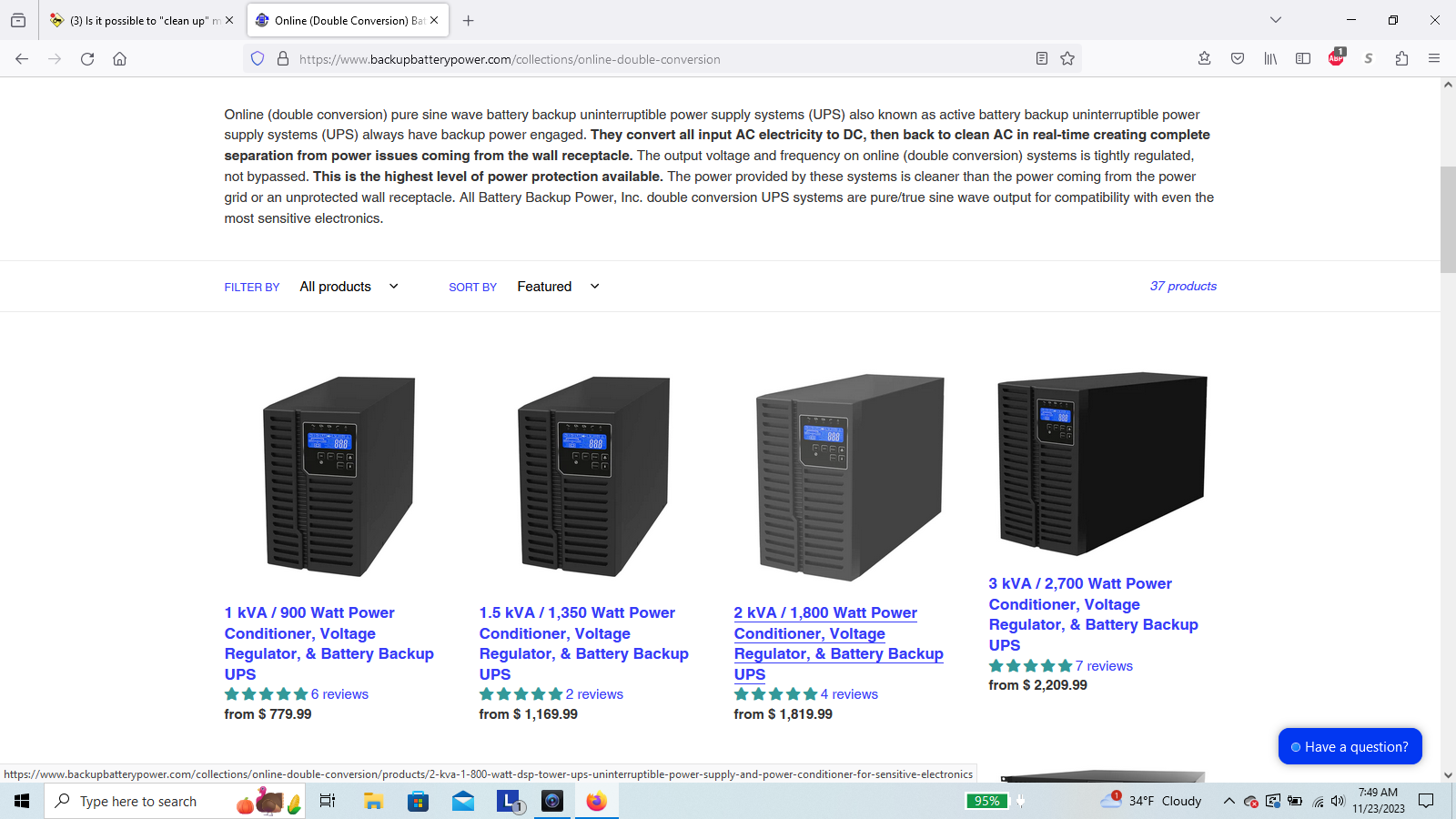

An online UPS will do the job, but they are not inexpensive by any means;
   / Is it possible to "clean up" my older generator's power for sensitive electronics? #6
UPS will do it, don’t have to go super large like the ones Lou posted unless you need that much clean power. A quick search on Amazon has them as low as $70…probably wouldn’t recommend that one though. I’d just inventory all the electronics you’d like to power and see what your load is plus any surge load and find one in the size you need.
