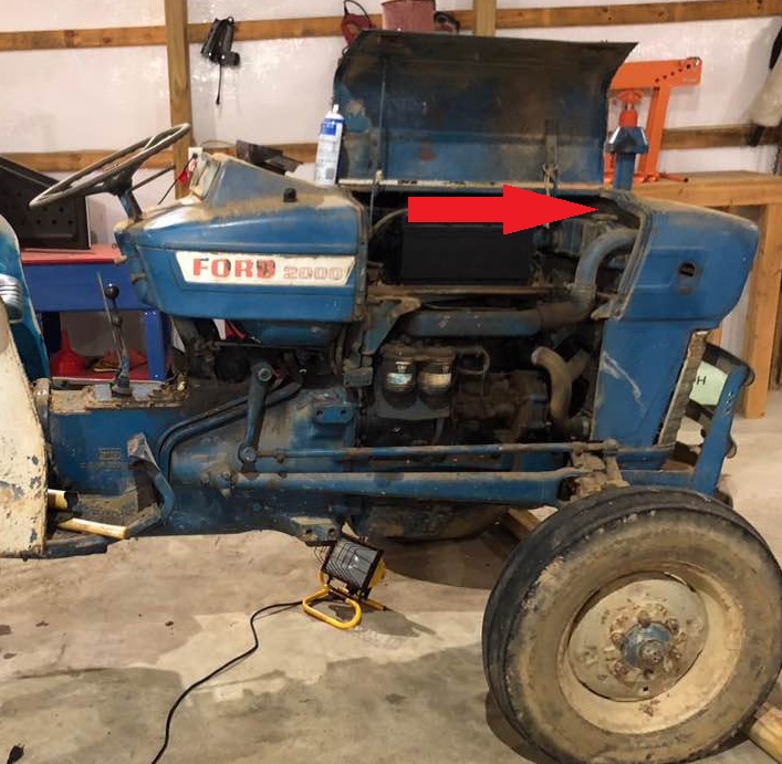

I am fairly certain this is a Ford Dexta. I can't locate a source for decoding the model though.
   / Is it a 2000 or 3000 #12
It is a Ford 2000 or 3000. A144-336 is the serial number (A for Antwerp, Belgium), normally, the Model Number should be stamped nearby it. This does not seem to be the case here. British and US made tractors had a sticker on the underside of the hood, over the battery, with the numbers on it. Antwerp made tractors may have that (though I can not see one on the picture), but instead there may be a metal plate riveted somewhere. I have only seen the plate close up on pictures, but I guess it would be placed on the firewall or on the inside of the hood.
Edit
I tried to understand some discussions in Belgian/French forums, and it seems that some owners found the plate on the wall in front of the radiator, see arrow in attached picture. Perhaps it could be on the other (front) side of the wall, or the fan shroud.
An easy way to find out if it is a 2000 or 3000 is to look for the spring for the draft control. I can not determine from the pictures, but if you can see a fat spring behind the driver's seat, then it is a 2000. 3000 had a cover over the spring.
Here you can see the spring on a 2000:

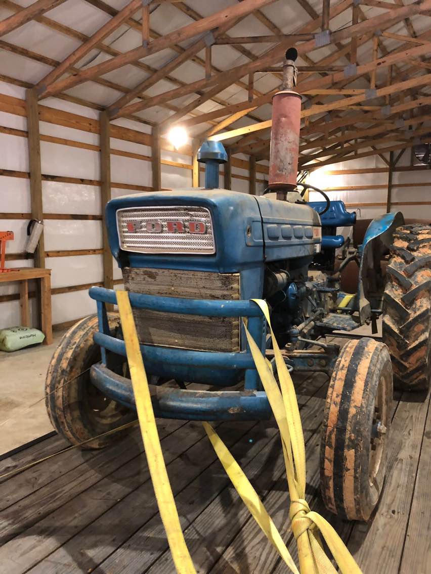

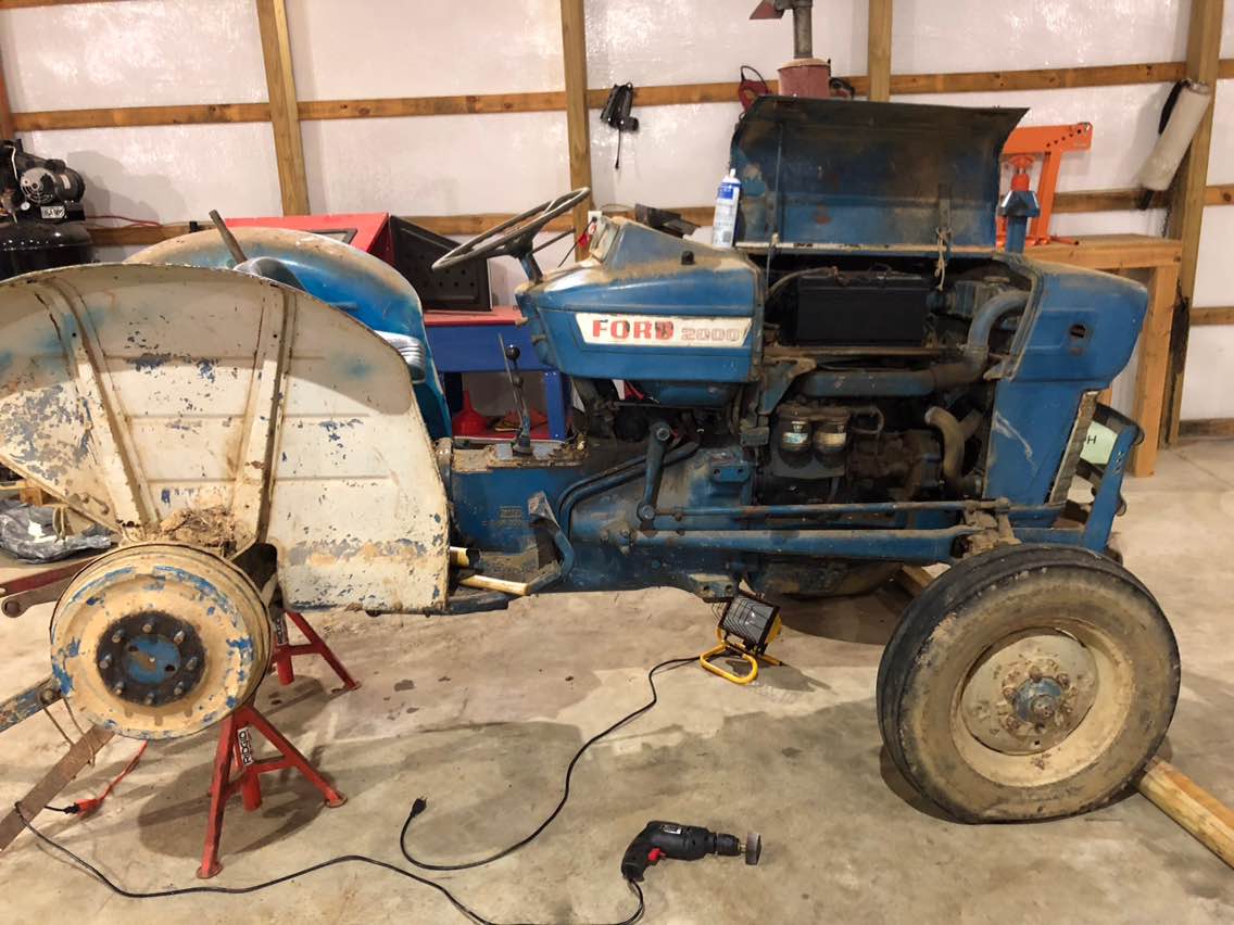

Here痴 a side view. I can get a better pic over the weekend
I think 2000 should work since the current 2000 label looks old and it does not have power steering which proves nothing. On a 50+ year old tractor I think old decals are more likely correct. I mean like what farmer or dealer would remove 3000 decals and replace them with 2000 30 years ago?

You could turn that the other way around.
Say it is a 3000 and the hood panel was damaged during the 50+ years and a replacement from a 2000 was used. What farmer would take the time and cost to put the correct decals on it?
