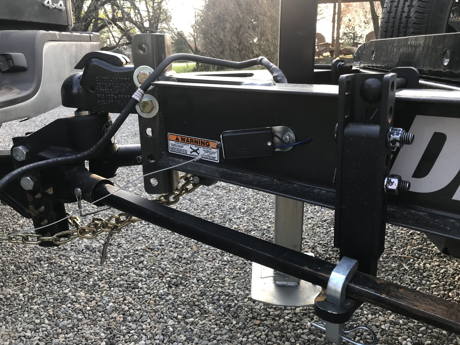

So how do you add a weight distribution hitch to an I beam tongue?
   / Is Anyone Making a High Quality 7k Trailer? #38
Just needed longer bolts because the beam is wider. I went with Blue Ox because it has the shortest arms and the built in toolbox doesn’t leave a lot of usable length without modifications. I was a little concerned it would slide because it doesn’t have the face of the channel to grip but it works fine.
