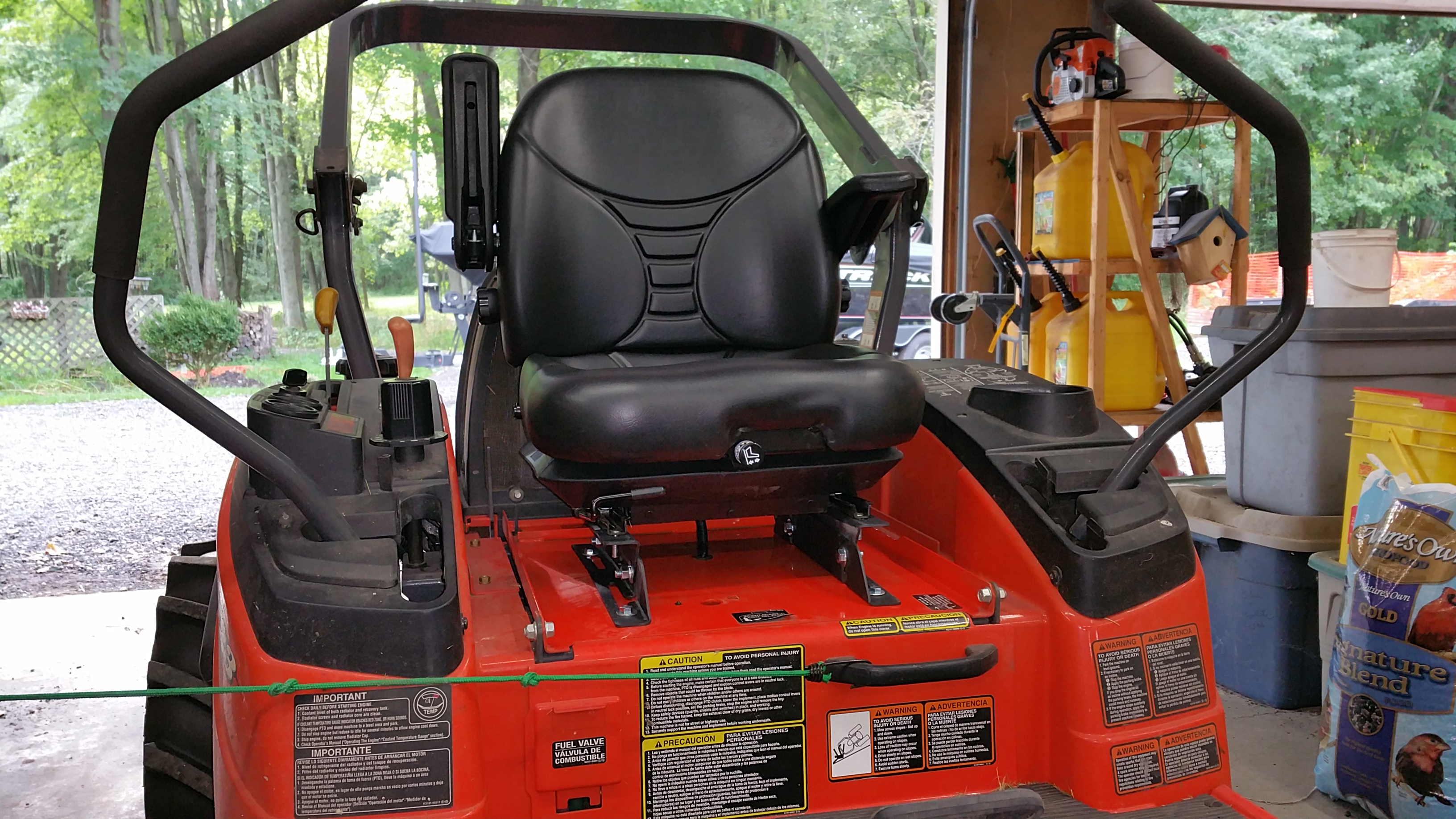

I had an issue last winter where the surgeon cut me open from my rib cage to south of the border. Come spring I was still quite sore and soon discovered I could not mow on my ZD. The bumps were painful but the bilateral movements were worse. My issues were further complicated by my height (6' 4") and my knees were too high with respect to my torso while sitting on the machine.
So I bought an air ride seat after hours of reading and research. The seat came in and I mounted it on the ZD but soon found out the seat sat lower than the factory mechanical suspension seat. So I found a set of seat risers and installed them, adjusted the rear and forward seat height to fit me and viola, I could mow with out as much pain.
There isn't much you can do to reduce the bilateral movements, but getting better control of the bumps reduces the bilaterals.
Here is the ZD with the air ride seat and seat riser set up for me.
I got the air ride seat at;
MILSCO V54 AIR RIDE SEAT, HUSTLER, EXMARK, TORO, BOBCAT, DIXIE CHOPPER, ZERO TURN #JQ - Seat Warehouse
Here is the adjustable seat bracket;
Trique Manufacturing Adjustable Seat Brackets SRB2 - Free Shipping on Orders Over $99 at Summit Racing
