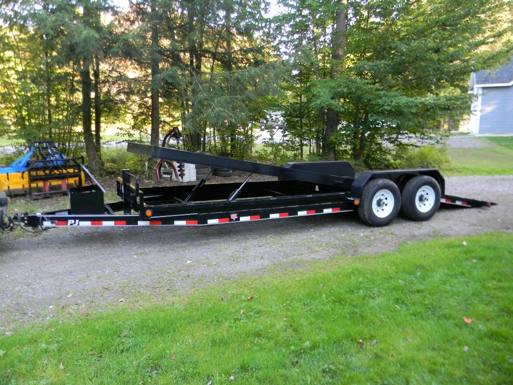

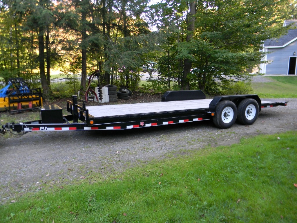

I've had tilt trailers for the past 22 years and will never go back to a standard trailer with ramps. I'm getting old and ramps are no fun to move. My first TT was a 20' 7K power up and gravity down. whether loading my tractor or a full size truck I was always pushing the weight limit of the trailer and 20' left little room to move fwd or back to balance the load.
11 years ago I bought a PJ TF 22' full tilt power up / power down 14K trailer. Only needed a 10K but they only had the 14K in stock. Even though it says 22' actual bed length is just shy of 24' so plenty of room to move load fore/aft. I could load 2 mowers by leaving it tilted but never have a need to do that.

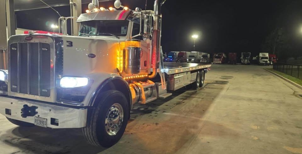

View attachment 3884676View attachment 3884677

Do you happen to know what the angle is that the trailer tilts back to? More or less 15°?
From the items you’ve loaded up, what’s your thoughts on the wisdom of an 8’ wide trailer rather than 7’ wide? I’m not convinced I need to go wider than 7’, but I don’t want regrets.

Mine has a wood deck and lots of side pockets. I added a 9K winch to the front of the tilt deck for pulling dead vehicles on.
The angle is very low. If I recall about 12 deg. is when the knife edge back touches the ground. It will go higher but no need.
8' wide deck would be called a deck over. 8' is max width for a trailer so deck would be over the tires. That also means the deck is higher off the ground. Pivot point on mine is just behind the rear axle. Mine is 82" between the fenders which is plenty wide enough for anything I haul.
