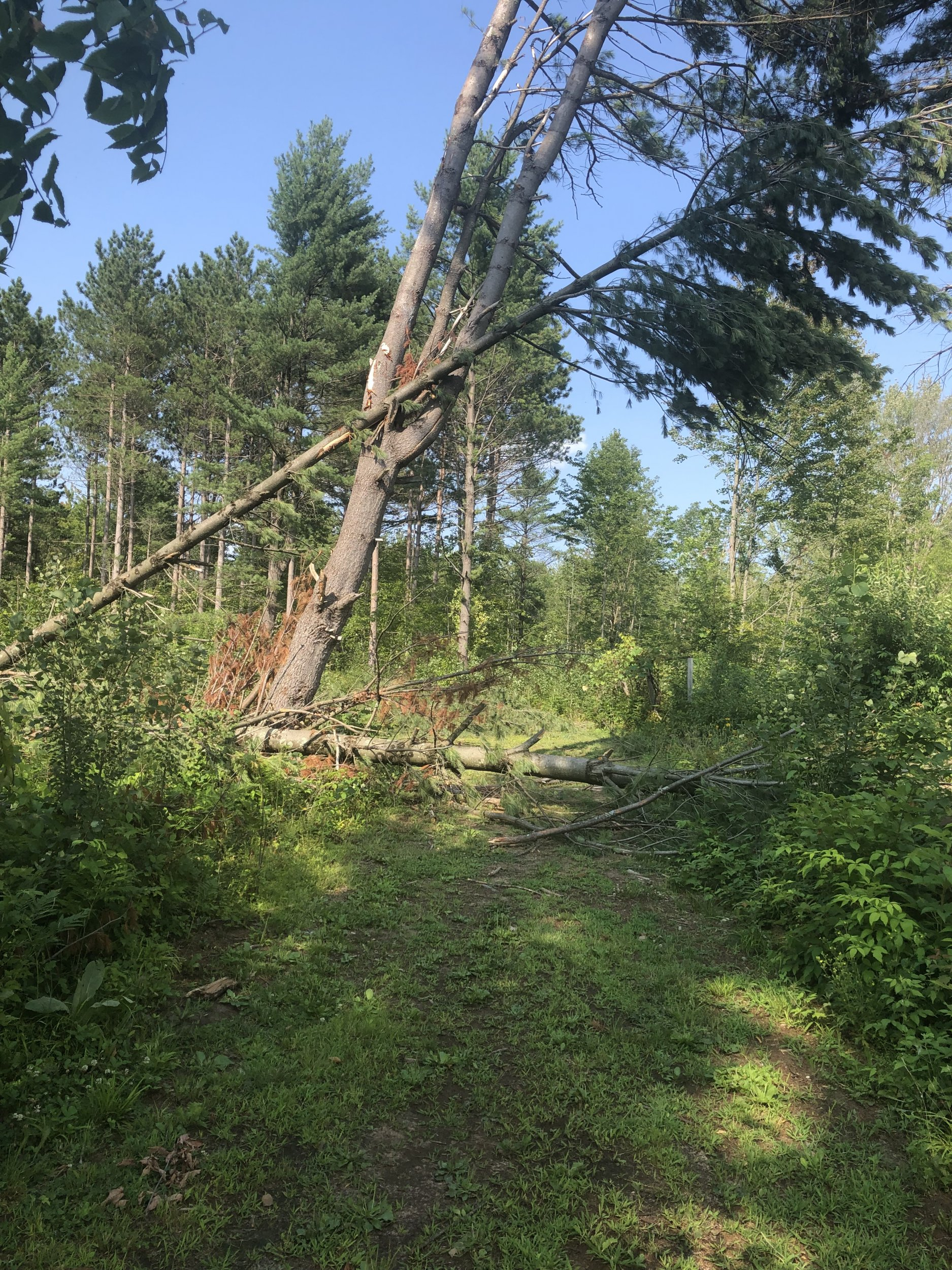

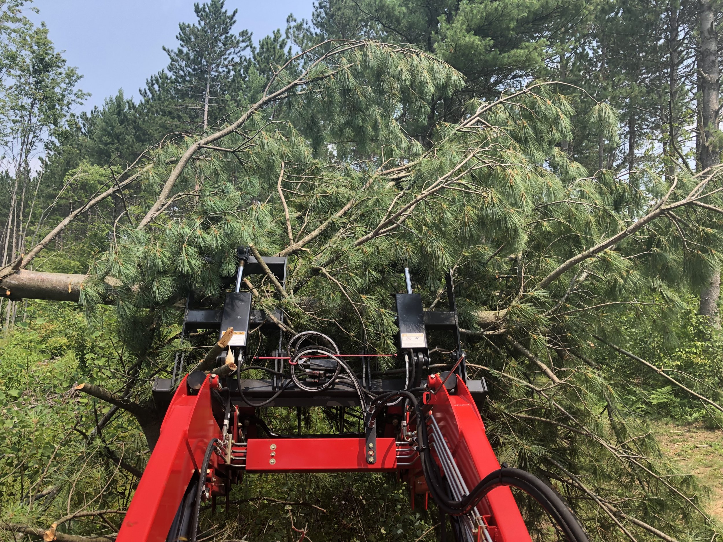

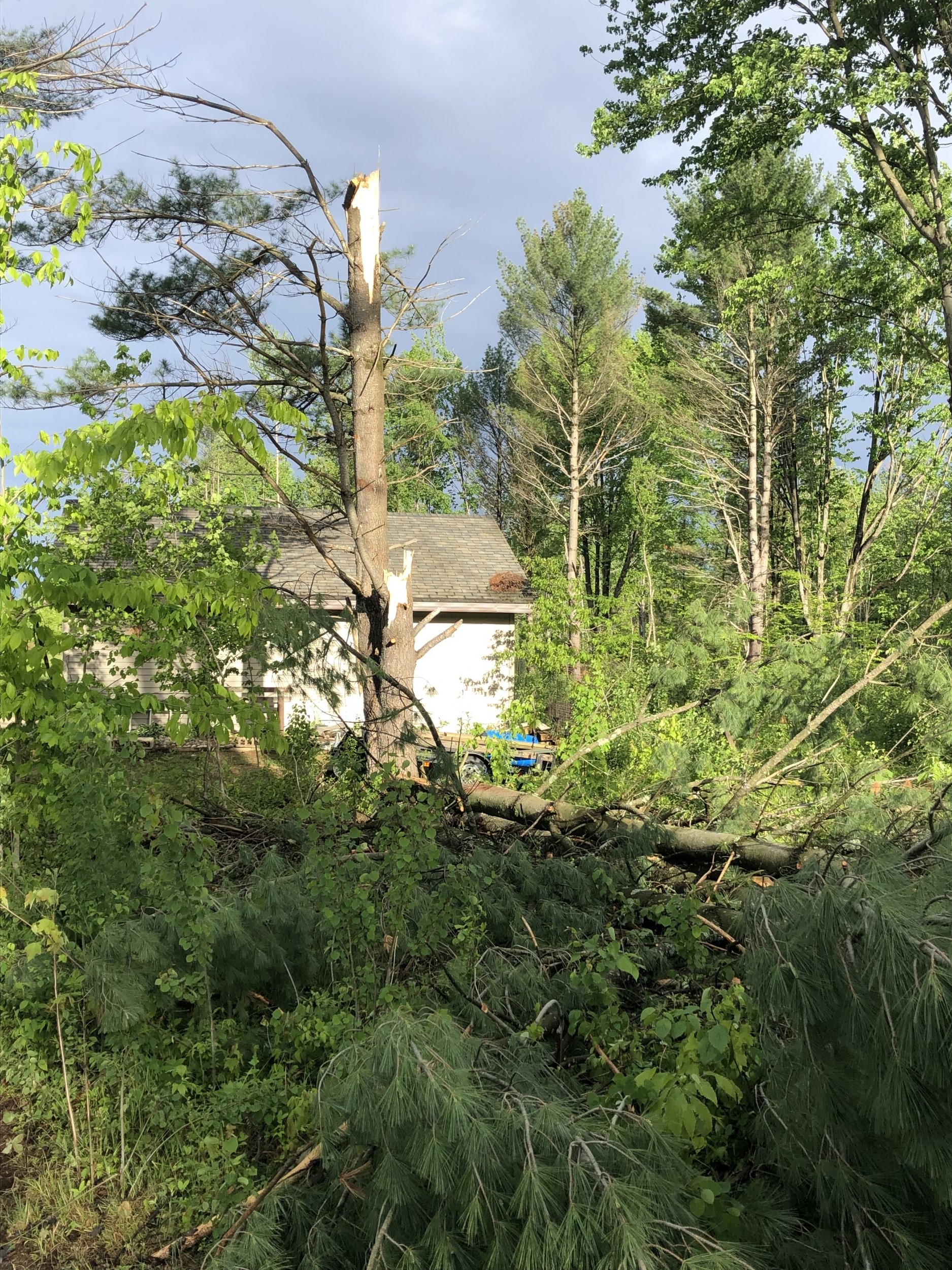

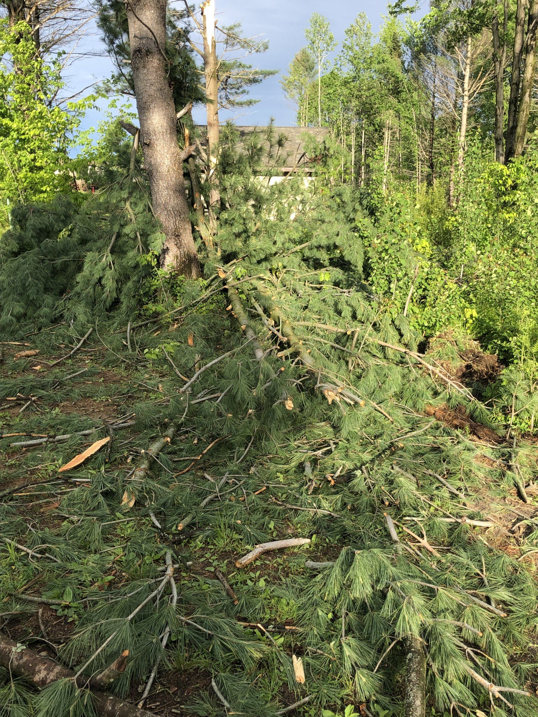

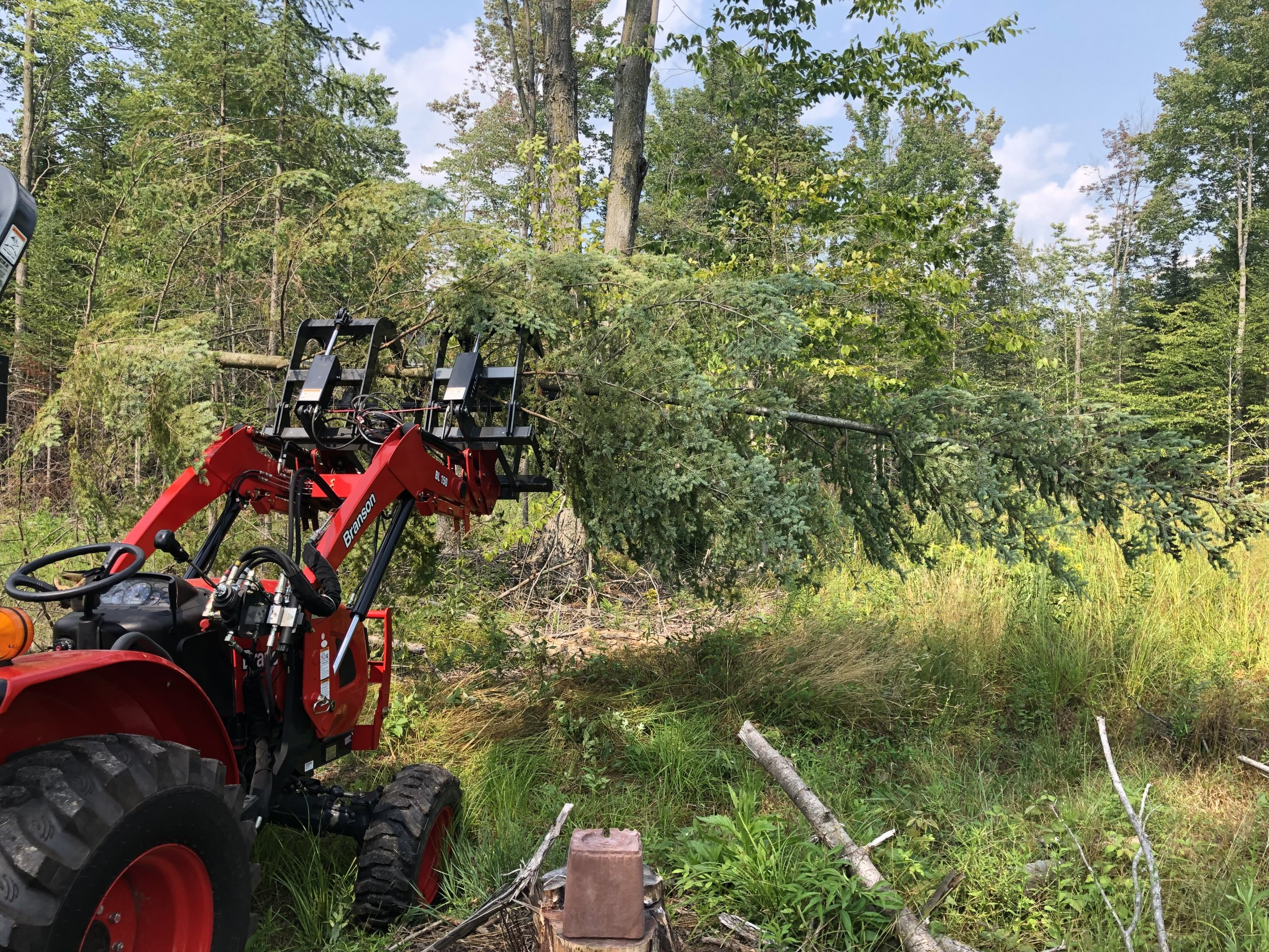

I agree with you if all your doing is move logs on a nice flat area. If your working in the woods it has many advantages moving logs . When I had massive storm damage I could grab the ends of the logs and drag them out. You are correct about the third function and it’s expense but when your a one man army I’ll take all the advantages I can get .
