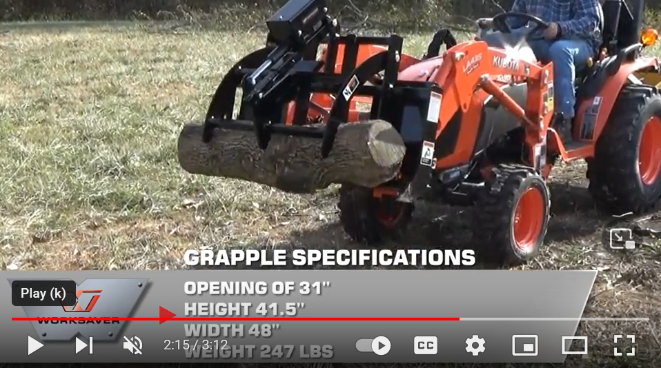

1277lb capacity at the pins. With clamp on forks your lifting closer to 24-36in from the pins. Your lifting capacity is greatly reduced.
With such light lifting capacity by the time you add the weight of the grapple you dont have much capacity left. Also a grapple is roughly $3k then add another $1k for 3rd function.. so $4k for something your alreaty doing with your tractor.

A CTA50 weighs 195lb, and is $1750.
That's less than the forks weigh. And the grapple will still be suitable if the tractor is upgraded.

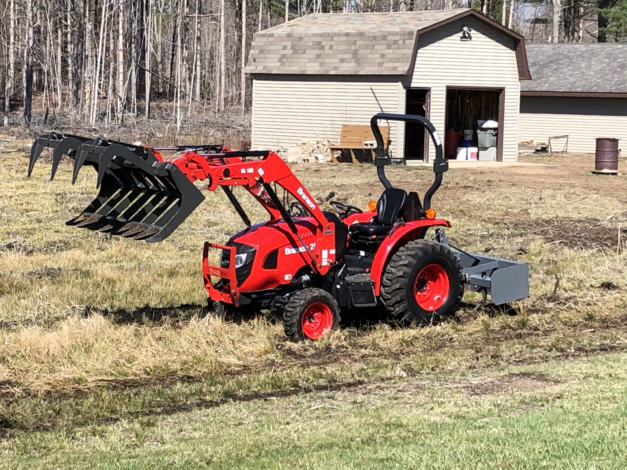

I have a Massey GC1723 which is only 22.5 hp and I am using a Homestead Implements subcompact grapple. The grapple weighs 190 lbs. and my loader is rated to lift 900 lbs. So I still can lift around 700 lbs. So far I've been able to lift logs as wide as the grapple and around 12 to 15 inches in diameter. I have the backhoe attached as my rear ballast and my rear tires are filled with rim guard.

With what I’m doing now I rarely max out my FEL. I am getting by just fine with the forks. I was just curious if the cool factor of the grapple was worth it. I use my forks to lift the logs off the ground to cut them into firewood size. I can see where the grapple would come in handy for that and you wouldn’t have to worry about them rolling around on you. I’d like to have a grapple, but any light enough for this tractor would likely be too small for my later addition. I still think a grapple is cool and may ”need” one anyway!
