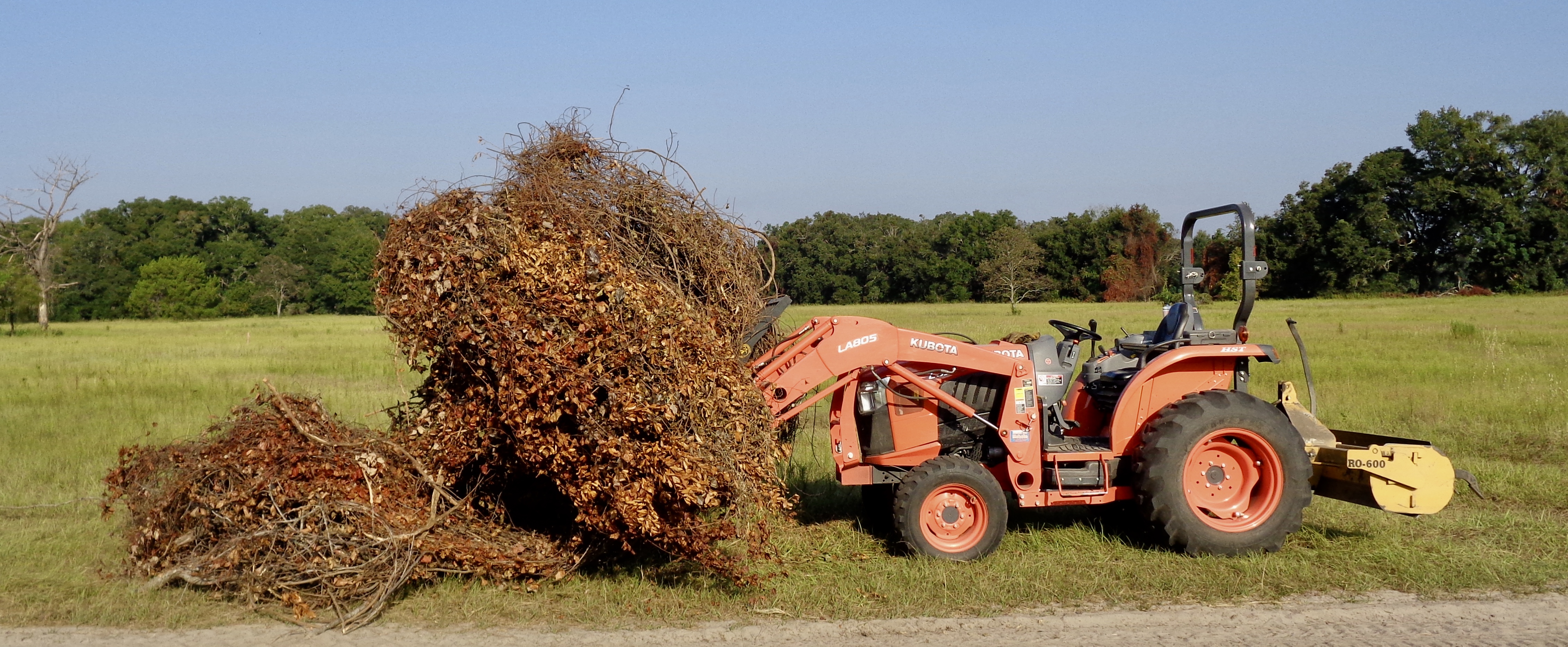

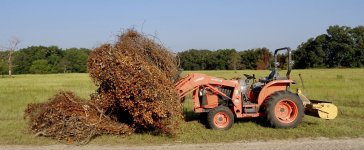

You might want to look at a forestry grapple, such as the Frostbite or Sundown GR40. I put one of those on my NH TC33D with a Woods 1012 loader. They are great for moving logs (not good for firewood or other small objects). They weigh a good bit less than other grapples, so you are not sacrificing much lift capacity to the weight of your grapple: my Sundown GR40 weighs almost the same as the bucket it replaces. The upside is that the grapple is heavy-duty enough to be used on larger tractors, so you could take it with you to your future 40-50 HP tractor.
I would not be without my forestry grapple. I do a lot of work in the woods and have shuffled a lot of logs with it. There are some downsides: while it works great for moving logs and picking up brush, it is not useful for moving smaller items (cut and split firewood, small rocks, etc.) As others have noted, the size and weight of your tractor will limit the size of logs you can handle.
