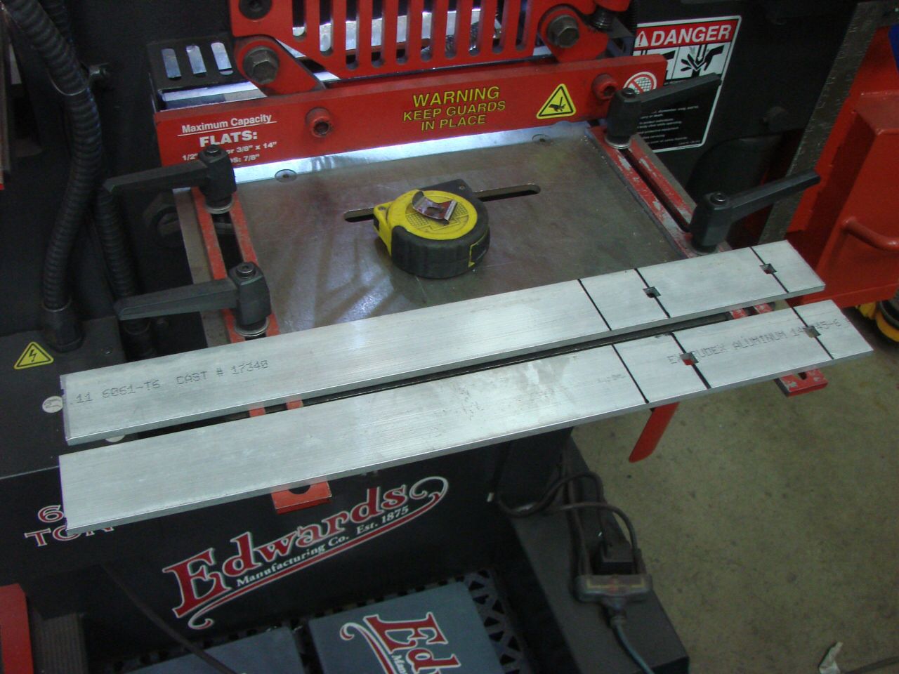

The modern "ironworker" is usually a "3 or 4 station" that with the same stroke of the Hyd cyl. you have a hole punching, flat plate cutting, angle cutting & a notcher, all moving at the same time for use at one station at a time. This might be different up in the 100 ton range but they have nothing in common with what I think a bunch of you guys are thinking of, that is a giant 15' tall WW II tank maker. It has more in common with a log splitter than those old stamping presses that worked off the inertia of a huge flywheel. My 55 ton edwards is maybe 1000 lbs. and takes up about 4'x3' of floor space. Completely hydraulic and yes, 3ph. A phase converter came with it. New they can be ordered single phase. They are super time savers. Just like wood working, all your time is in cutting & fitting the parts. Sticking them togher is the easy part.

I'd say yours is more than a 1000 lbs. My 60 ton weighs 2500 lbs. I ordered mine single phase. Also ordered it with the auto electrics. Wouldn't be without it now.

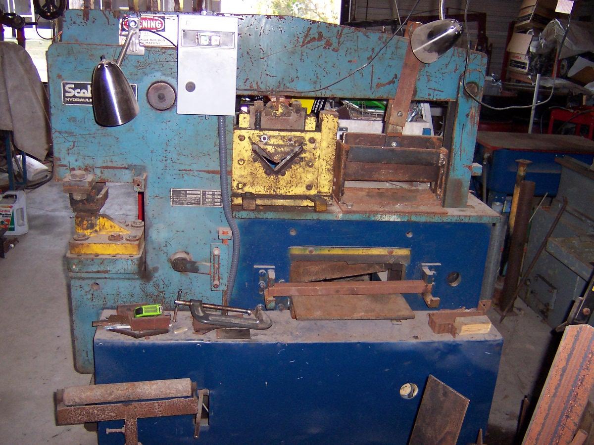

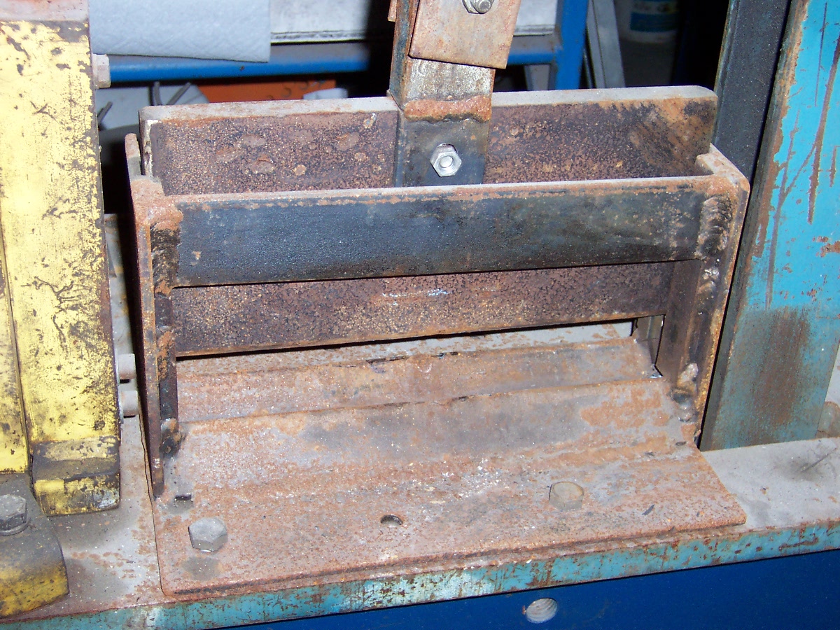

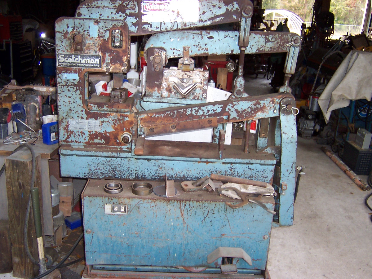

I have a 35 ton and a 50 ton Scotchman.
First pic is 35 ton, second is the 50 ton and third is the Brake that I made from scrap around the shop for the 50 ton.
I got the 50 ton first, I bought it with 2 other machines, a 6' stomp shear and a 10' Brake.
I sold the shear and brake and kept the 50 ton AND ended up with $600. additional cash!!
I bought the 35 ton on CL for $600. with plans to flip it but when it looked at me with those sad eyes I couldn't let it go!
Besides the 50 ton wanted a little brother! (That's my story and I'm stickin' to it!!) :)
I am running both machines on one homemade ($45.) static phase converter along with a 15" X 54" Cincinnati Hydrashift Lathe. I never run them at the same time anyway.
I know a guy with a 55 ton Edwards that he bought new. The pump noise goes right through me!! And when he punches thicker metal it goes "BAM" when the punch goes through!! My Scotchman just seems to ease through when punching thick material.
If anyone thinks that the Scotchman are too slow can just go back to their drill press and bandsaw!!
