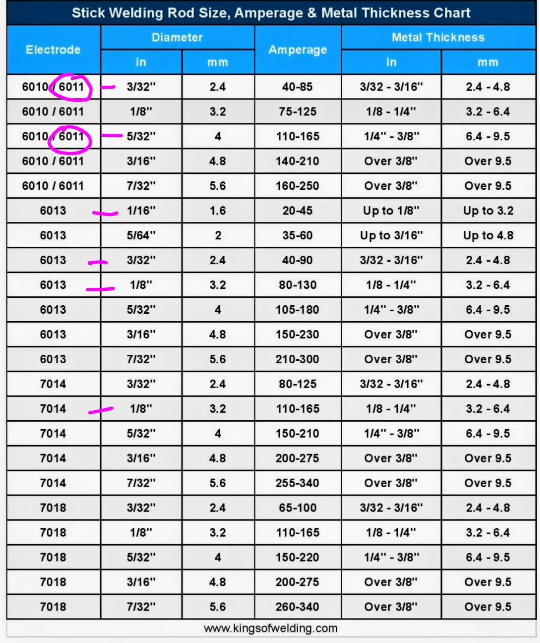

I have the little Hobart 160i ... My biggest problem is starting a full new stick (probably my inexperience!) ... Once started it's fine, I like 240VAC MUCH better than 120VAC, and like the 7014 rod ... And don't like the 6011, wish I didn't buy the "deal" of 25 Lb boxes of it!
Purple ticks are what I have so far ...
I can run the 240 in the garage, or out and about with my 7K portable generator, and only used the 120 setting once in the barn, better to move to the garage or bring the generator out ...

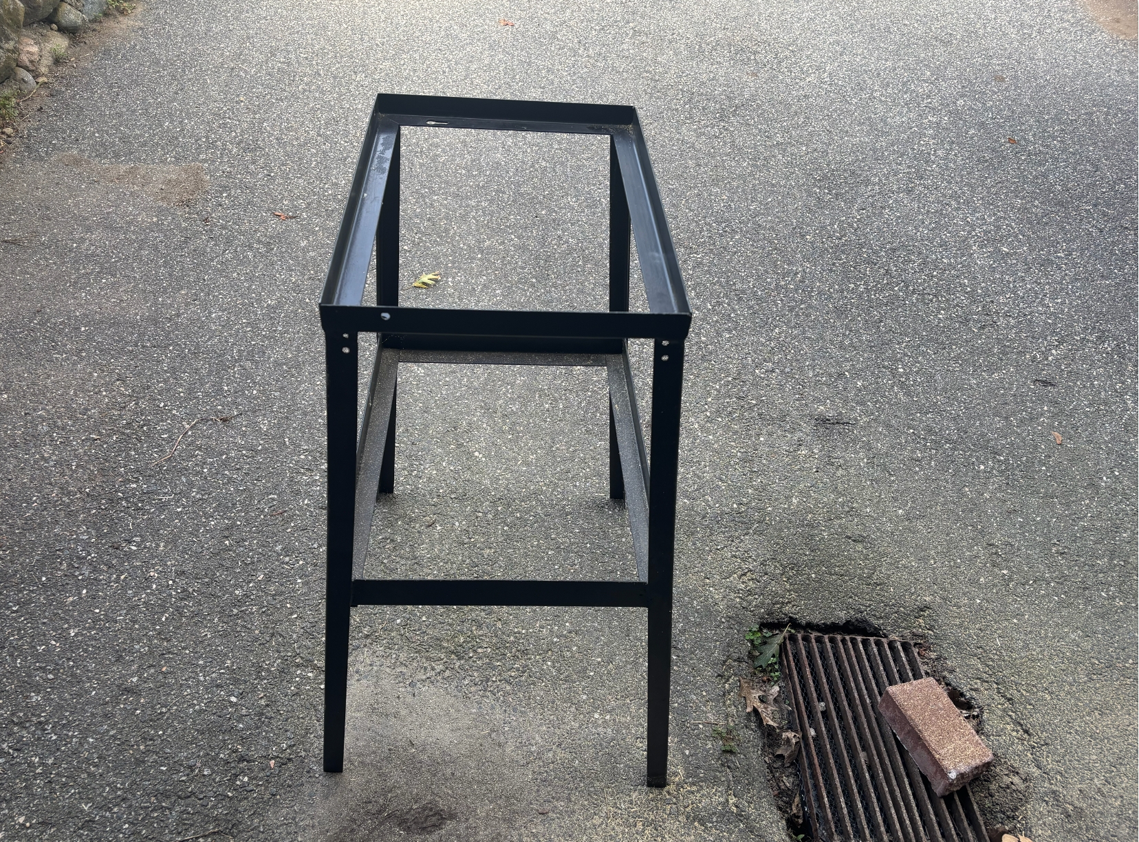

I have a little Century FC90 inverter welder I bought during the COVID shutdown. It’s a subset of Lincoln. It’s very light at 15 lbs I believe. It seems to do a surprisingly good job, but I’m not an experienced welder. Solid welds on this little work table I made from old bed frames I found in the attic.
That's a handy chart!
