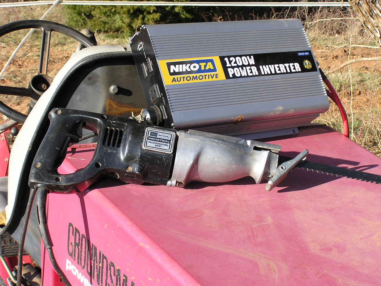

Bottom line: Most CUTS have very little reserve capacity in the Alternator. Some are as small as 30 amps some 40 and a few of the larger ones about 50 amps. Better hope your battery is in great shape if you are planning on putting an inverter of much size on one. While 180 amp alternators are very common on cars and many light trucks have even larger ones, uh, tractors, no not so much. A 1200 watt inverter on a cut?,.. Not so hot of an idea. A nice generator on the 3pt with a PTO hookup, yeah that can provide some serious tool power. And them some.
/ Inverter on CUT? #24
Here is text of my posting in a previous (2006) thread regarding experience with inverters on tractors.

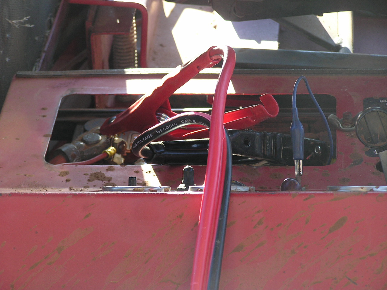

I have direct experience with running Remingtons 14" Limb and Trim on both Xantrex and Vector 1000W inverters. This has turned out to be a long term compatible combination. The saw is rated at 8.0A, 120VAC, which means it requires around 960W at load. The Xantrex has been mounted on our BX1500 hood for years and the Vector is on the Kub 2550 also long term. The invertors pull about 100A to run the saw so DC wiring must be good. This is more than the tractors alternators put out but with the engine running even on the little one you can do several continuous minutes of heavy cutting or 20-30min limbing before the inverter cuts out due to low supply voltage. I have had trouble with other inverters in these useage conditions. These are mechanically and electrically robust. Ive had no problem with the startup surge except when I had a poor DC connection. You can spot check those by running a 500W shoplite or other substantial load and measuring across each DC connection with a digital Voltmeter. This will allow you to compare the quality of each individual connection. You want very low voltage readings like 0.1V or less at this 60A load. If not, the higher loads inherent in startup will cause the inverter to kick out because it isnt getting high enuf supply voltage.
