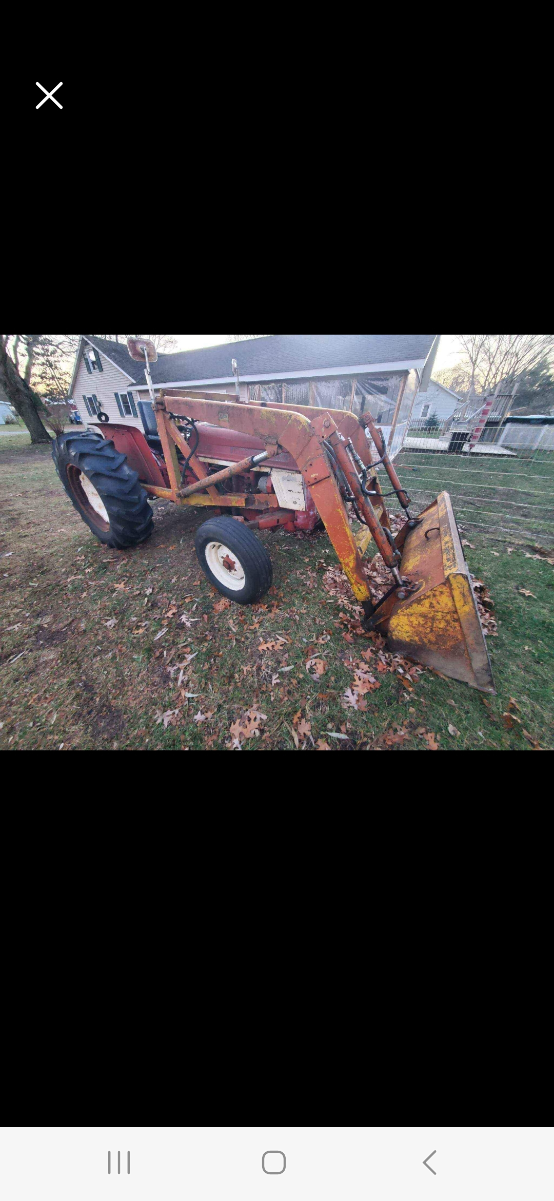

Hello,
I am looking for a decent tractor with a loader in the $5k range. I know that is a lot to ask for with used tractor price now, but I am willing to wrench on something and put in some elbow grease.
Came across this International 454 with a loader, brush hog, back blade, and 3pt hitch forks for $5000. It starts and runs so I am told.
Other than the normal mechanical checklist to cover, is there anything I should focus on while looking at this tractor?
Specifically to that series of tractor? Thanks for your help!

Not specific to the farmal, but, see if it will cold start and run under load without overheating. Look and see where the leaks are. Check all the fluids and see what it has been running without. Full lift and tilt while steering. PTO smooth engage/disengage. Compression and oil pressure test if you have time and access.
Drive up and down a hill in all gears and make sure it doesn't pop out of third.
Or check what you can, and plan to fix the rest, 5k for a working machine that doesn't leak like a sieve, is probably fair.
If you don't do anything else, run it under load, don't want it if it gets hot, and check fluids, don't want it if it leaks alot or has been run low.

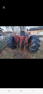

Brakes and parking brake are main weakness, if the parking brake doesn't work it's no big issue with the loader. The brake pedals are hydraulic brakes and can leak, they can be bled and might work for a while.
5k seems ok with all the attachments if it starts and runs and moves with out anything major wrong.
/ International 454 - With Loader #4
Doncaster built tractor with a direct injection 179 cu inch three cylinder wet sleeve diesel engine built at the IH factory in Neuss Germany. Probably a Bosch VA injection pump. There were gasoline versions with a British built engine too.
The replaceable cylinder liners had only one oring, so check for coolant in the oil to make sure the o ring isn’t leaking. Easy fix, and not normally a problem, but it is around fifty years old.

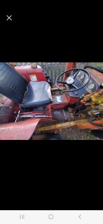

I went and looked at it today. It has good bones but it's a little rough around the edges. Everything checked out with the drive train. It has some typical old tractor leaking, but nothing to cause a steady drip.
The loader pivot joints are all pretty worn. It doesn't appear to have any bushings except the ones on the rod ends, and those should be replaced too. Maybe I could machine some new plates with bushings and weld them in?
I'm seriously considering it just due to my budget and the tractor itself is good mechanically. Thanks!

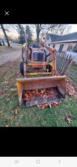

That one looks to have decent matching rubber on the back and automotive tires on the front. I do hope that the power steering unti is working well - check that. Those old ag tractors were borderline unusable without PS.
Is that bucket straight on the front loader arms? Is sure looks like it is sitting crooked... or is that just the photos (both photos). Too bad it is missing the original top link, but at least it has one. Fenders are a nice touch. I always like it when the original owner who ordered it new added a few little extras. Gives it some class.

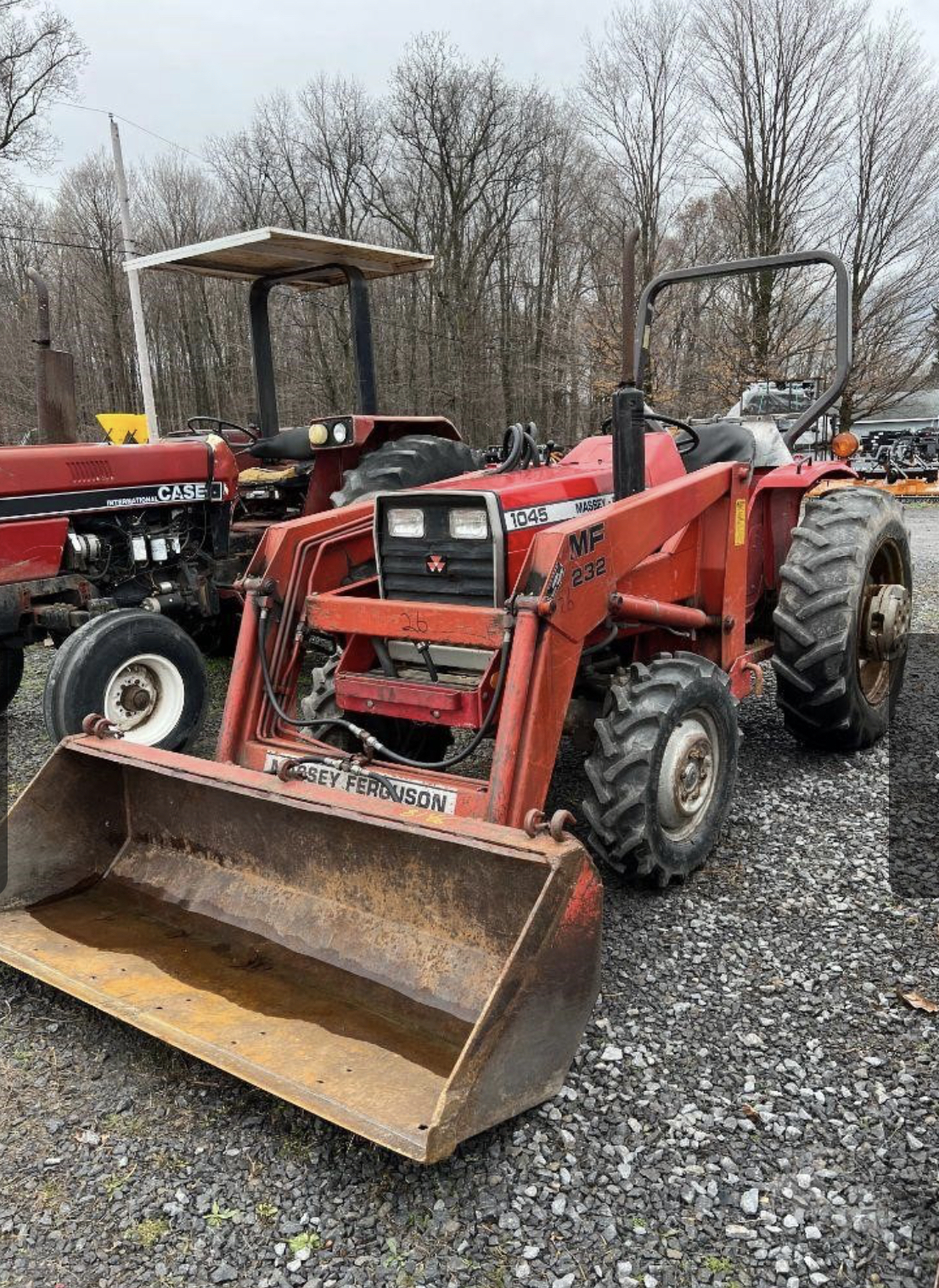

/ International 454 - With Loader #18
I’m in same line of thought. Don’t need a new Kubota L for 24k plus taxes.
My new budget is around 5k plus sale of my other tractor.
The only thing I can find is not green or orange but mid 80’s I think Ford and MF such as picture below.
I can fix a lot but not rebuild an engine.
Is this a good idea or just use the cash as down on a new Kioti Ck etc. View attachment 777124
This was at auction for around 8k - a little over my budget of 5k + 2.5k when I sell my other si
I agree with all that.
Also, something to think about: when I buy an old tractor for cash to do some project, I go in to it knowing that if the machine doesn't work out then that whole project may not move forward immediatley - but ultimately it probably will.
Now if I finance a new tractor the situation is different. Now the tractor isn't the holdup, but the project becomes dependent on my working to make extra money. The project gets put on hold until I have the time and energy for the original project. Plus the downside of what happens if my paycheck goes down for whatever reason.
Given those two options of cash vs finance, I feel better about the cash for an old tractor myself. At least it leaves me with time to spend on projects.
I can always fix the tractor, and then do the original project - getting two things done because I had more of my own time available.
Sounds like that might work for the OP as well. His plan sounds good to me. And that is the right type of tractor, even if that may or may not be the right one.
rScotty
Thanks guys, I’ll probably sell off a few things and go cash route. I don’t think my wife would approve of a payment for a new one but hey it’s the New Hear and you never know. 2023 is going to be a good year!
