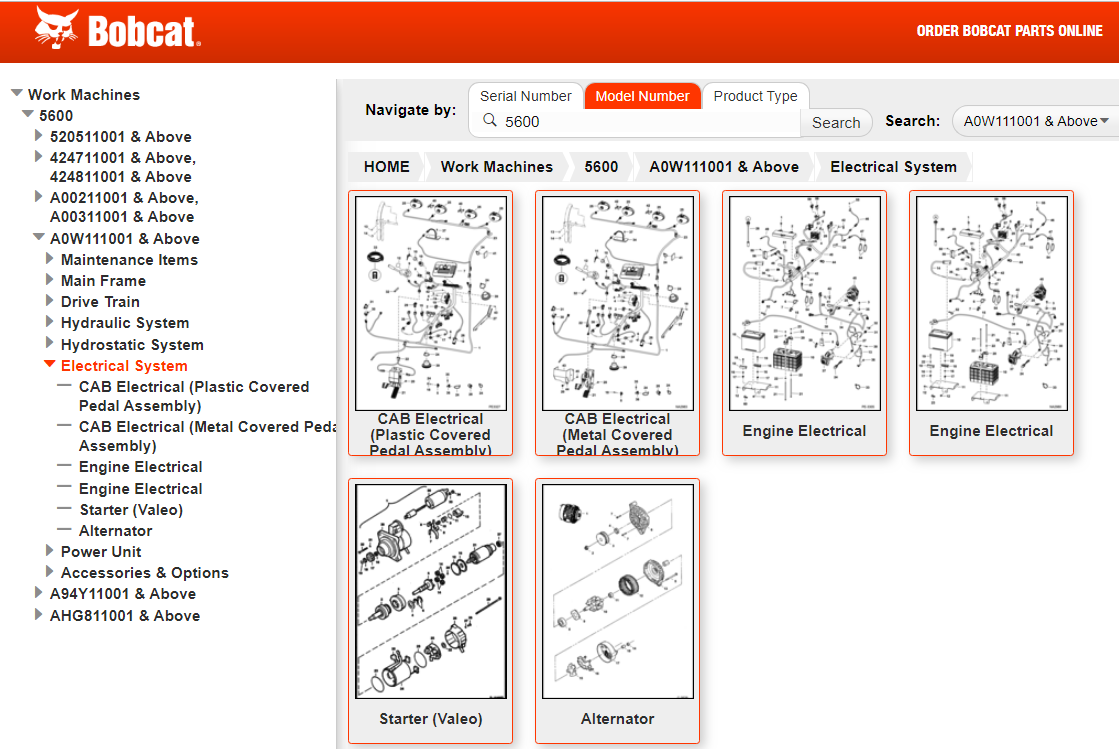

I have no experience with the D Series. You can see the electrical parts here: Bobcat Genuine Parts Catalog – Official Bobcat Company site
And order the service manual here: Bobcat Utility Vehicle, Toolcat, & Tractor - Service Manual
