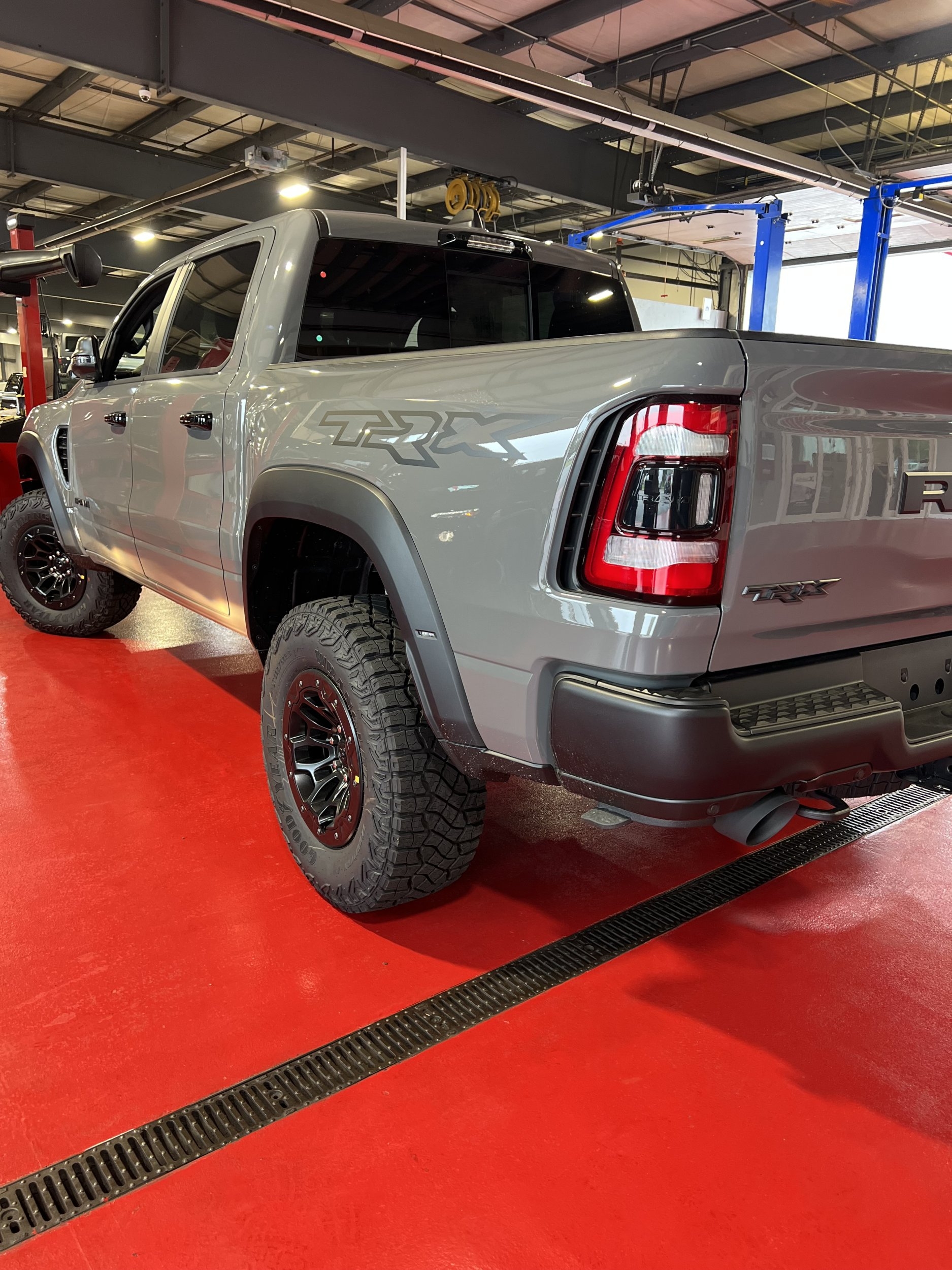

I saw one of them last week while having my Ram serviced. This one was only $130,000.
