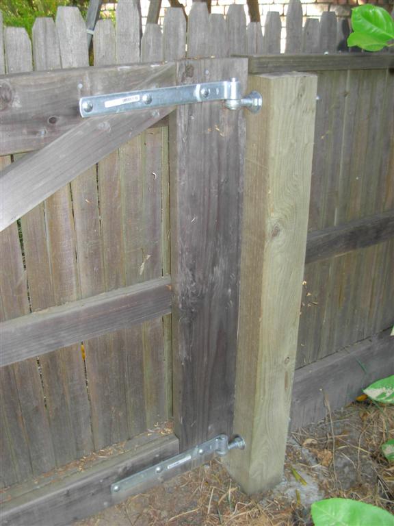

Similar to the way I build my gates. Only I built mine to only swing one way. What I like about these hinges is I can move either hinge by tightening or loosening the nuts on the sides of the post which allows me to move the gate a little to the right or left or tilt the gate up or down to dial in the latch to its mating hole.

/ Interesting 4 board gate design / hardware #9
Those are convenient hinge posts to have but I have found that when I build gates, they seem to be stronger if I run my diagonal from the bottom hinge upward instead of from the top hinge downward.:)
/ Interesting 4 board gate design / hardware #10
I went out and took a look and it seems I built all the gates that way. Then I tried to think back as to what my rational was at the time I built them. Now I remember I was thinking the brace was a replacement for a turnbuckle and cable. So given that I’ll bet you wouldn’t put a turnbuckle and cable as you describe, from the bottom hinge upward. :)
/ Interesting 4 board gate design / hardware #11
Diagonal bracing, board or cable, is designed to transfer the hanging load back to hinge stile of a door or gate to prevent sagging. The cable is in tension supporting the hanging load from the bottom and the board brace is in compression supporting the hanging load from the top...so yes they should be opposite of each other.
