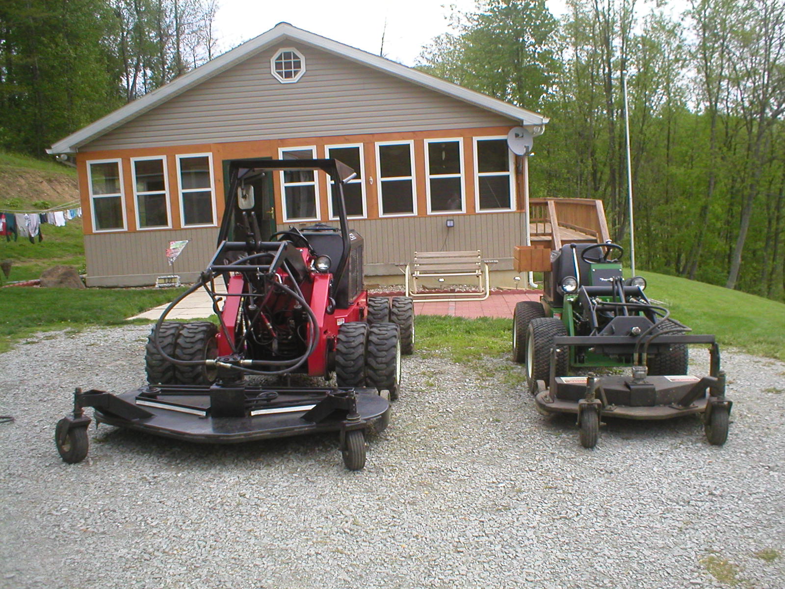

Hello,
I have a decent size farm, and several cutting implements. For mowing the grass I have a Deere zero turn 60" deck, and a 4WD Wide area mower. Neither one can handle the hills. I am thinking of getting a Power Trac. I measured the angles, and the steepest slopes are about 27 degrees. Both of my mowers become sleds when I try to go down, especially if the grass is long or wet.
Anyways, do I need a dual wheel mower like the 1845 or 1850, or will a 1445 or 1460 do the trick? Also, am I better off with turf tires or bar tires? Do the bar tires ruin the grass? How about with a dual wheel bar tires?
I would greatly appreciate any advice you can give. I want to mow the hills safely, but single tires would make the tractor a little more practical for other jobs, plus they are less cost.

I have an older 1845 that I bought used 2 years ago. It is great for mowing slopes either up /down or cross ways on . The steepest I mow is around 30 degrees and going cross slope you get slight sliding of the rear end. My tires are 8 ply industrial R-4 tread with tubes and they are inflated to more than they should be for maximum traction . There is little damage to the lawn from them. Traction would be better with the ag tires. On my 422 I have the turf tires and they give excellent traction in most conditions. What are you planning on mowing should influence your choice of tires. Lawn , I would go with the turf, if you are planning on mowing rough areas with brush probably the ag would be better. See my 2 pt's with different tires.

I have an 1850 with the dual bar tires. They are very easy on the grass particularly because the tractor steers by articulating. Sitting still and turning back and forth (like when grinding a stump) is what is hardest on the lawn. You get some compaction if the ground is soft.
I use my tractor often with just single wheels instead of duals. It takes 10 minutes to switch (if you really hussle, 5 minutes). The biggest reason i use duals is for wet ground.
Thanks. Do you ever take the 422 down the steep slopes? How does is do?

I often take the 422 down the steeper slopes with no problems, the only time it could become much of an issue is if there was ice, real wet mud or snow , now going up is sometimes a problem due to lack of power and if the tractor is hot it becomes more of an issue. On my 1845 I usually keep the dual wheels on as it makes it a lot more stable going across hillsides which I usually do mowing.
