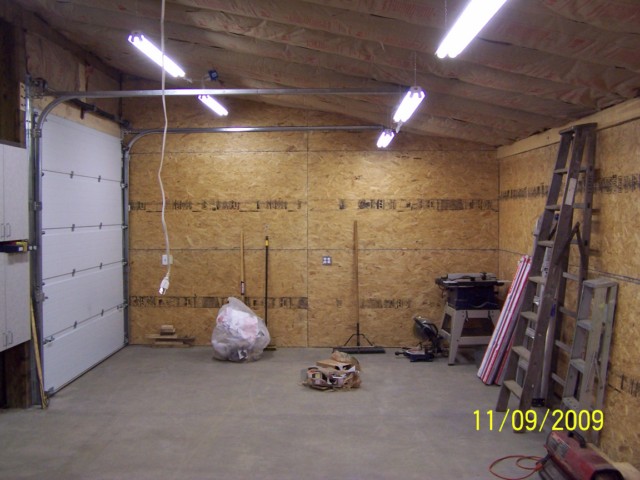

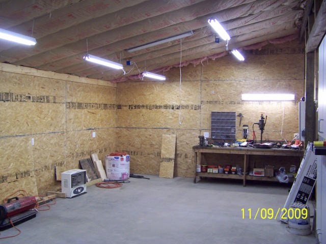

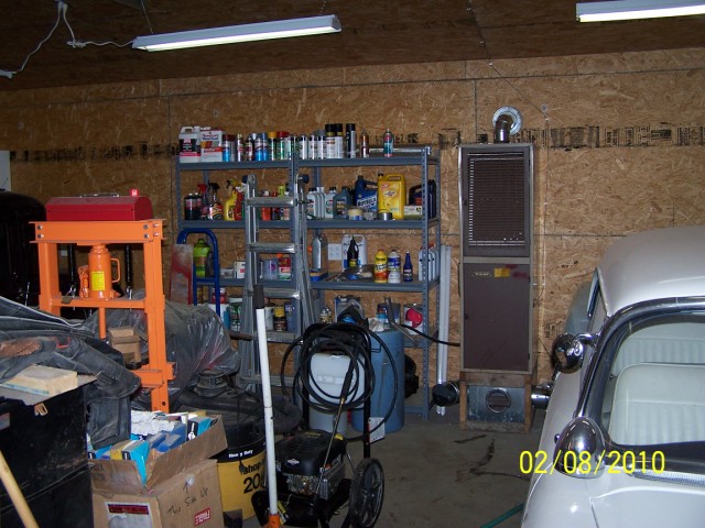

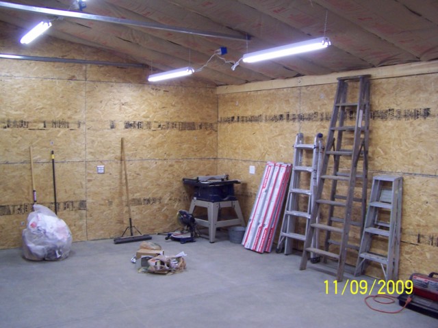

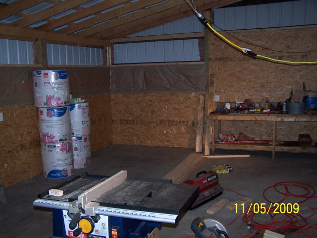

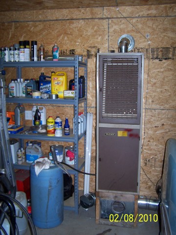

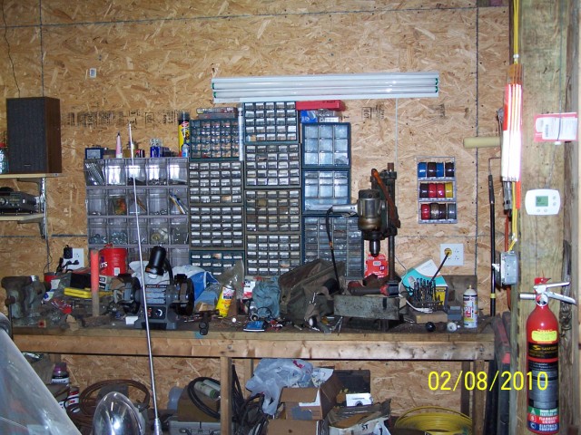

Deans,
I added a 16' x 32' pole barn addition to the back of my garage back in October. I insulated the walls with 6" x 24" rolled insulation then put up 7/16" sheathing. I did the bottom half first then ran all my electrical for lights, outlets, switches etc. I rented a sheet rock lift to do the ceiling. Last month I bought a used mobile home furnace that runs on kerosene and installed that for heat. I spend a lot of time in the garage and the heat sure makes it nice. The sheathing was on sale at Home Depot, the insulation was not (ouch). My posts are 6 x 6 on 8' centers. I ran 2 x 4's and 2 x 6's (left over lumber I had) horizontally on 2' centers for installing the insulation and sheathing.

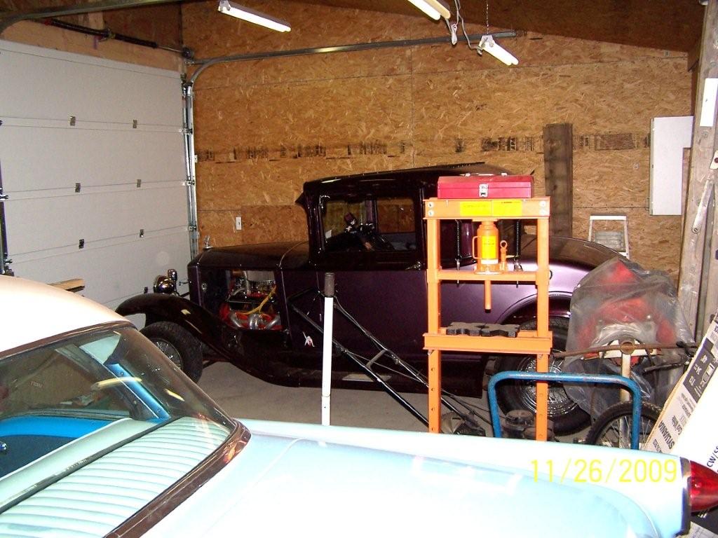

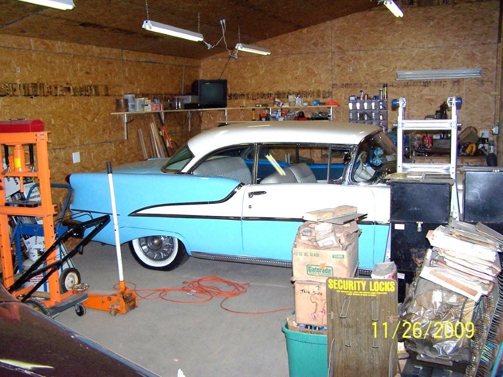

My garage was standard 2 x 4 stud construction, but I did much the same... inexpensive 7/16" OSB on walls & ceiling, after adding batts of insulation. One thing I did which really helped was to paint surface of OSB white before hanging stuff on it-- makes lighting much more effective.
George2615- is that a '55 or '56? Used to drive one of those old tanks just like that-- even the same color! The Olds I used was a '55. "Rocket" V8!
  • Garage interior 2:09.JPG
  • Garage wall 10:28:08.JPG
/ Insulating question ? #13
George, isn't it about time to buy a new car? :D
No, these two are paid for and easy to work on. No computers. That's why I built the barn, needed a place to store them in winter.
Its a 55 Super 88, all original and I just repainted it last summer in original colors. The other one is a 29 Durant street rod.
