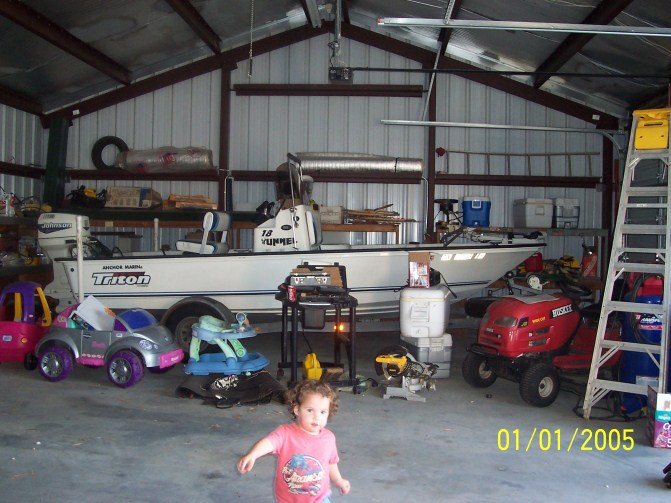

We built a 30x40 metal garage for our house, since our house is of all-steel construction to match. It is a red-iron with purlins running horizontally on the open walls. We didn't insulate the walls at the time, but the roof has the bubble wrap/foil backed insulation with vapor barrier.
What would be the best way to insulate now after it's been up for 7 years? We had a cold snap and it was 35 degrees in there and I'd like for it not to be. lol I'd also do this on the overhead doors 9' x 18'.
Could a person somehow glue the blue foam board? Referring to something similar to this: R-Tech at Lowe's: 2" x 8' x 4' Insulated Sheathing
Or should I get some of the same I have on the roof and just start pulling side panels loose and use that?
Any ideas or suggestions? Anyone done this before?

You don't think that global warming will fix that problem, eventually? :)
A pic or two of what you have might help a lot.

I don't have a good one, but here's one when hurricane rita was coming a few years ago, thus all the chaos.
I don't plan to stud it out so it would have to be something kinda tough or not bulky.
