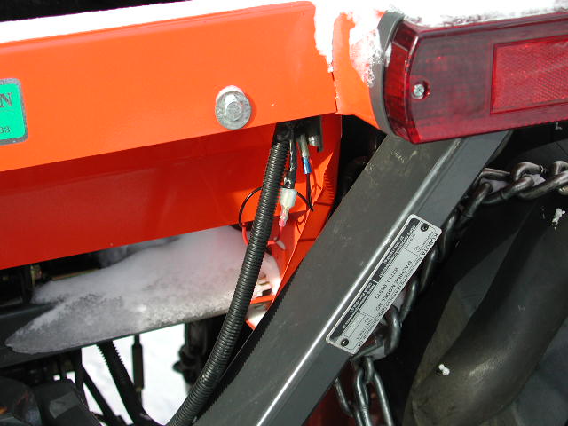

/ Instructions for installing work lights #9
Here is a close up of where the electric hookup is on the 2910. This is from the rear right.It may not be the slickest setup but it was quick and easy, The lights only cost $20 and they put out more than enough light. I can also swivel them up and down as needed, great for working on the PTO when a pin shears at night.

dlabne
thanks for the pics, I like your setup. I found the wires. Did you run two lights off the one set of wires at the right rear? Also, did you run the wires on the outside or inside of the rops?
