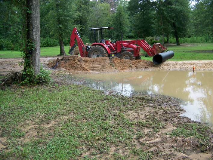

I purchased an 18 inch culvert today and spotted it close to were I will plant it. Got to wait a few days for the water level to go down and the dam to dry out. As of now, any tires on the dam leave very deep ruts. So I wait.

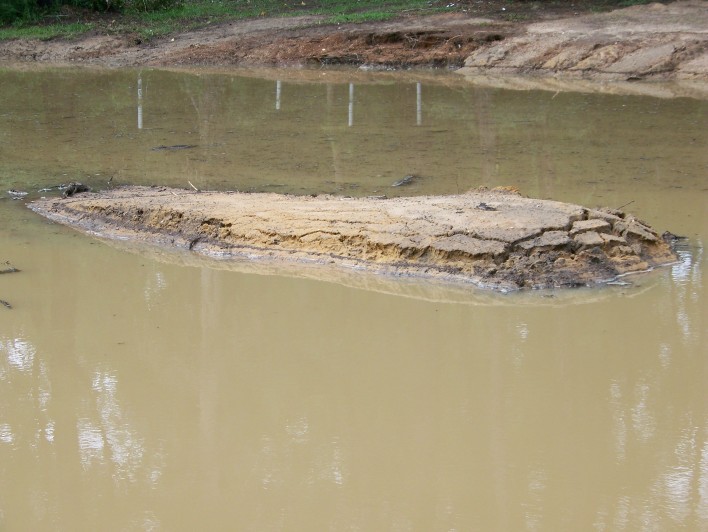

The last photo show the island crumbling at this high water level. I will definitely need to pump out the pond, if nothing else to finish the island.
hugs, Brandi

Wow Brandi! You really have been busy. Too bad you got rain dumped on you so quickly, but at least you had most of the work done. I'm sure jealous of your rain. Last night it rained here. We had a heavy downpour for about 7 seconds, then it stopped instantly like someone shut off the spigot.:( Like the American League in the All-Star Game, I've been shutout for rain lately.
For your pond, I'd expect an 18" culvert to be plenty, but certainly a 24" will do. The problem with the 24" is price. They are almost twice the price of an 18" culvert here. I think I paid $420 for one 20' section of 24" culvert pipe (PVC). Metal is even higher.
Jim,
The 24 inch culvert was between $320 and 349. I bought an 18 inch one for $199.
hugs, Brandi

Looks good. The spillway you cut was exactly what the state of Arkansas requires rather than overflow pipe. We have an overflow pipe in our large pond and also an upper end spillway to take of the excess when the overflow pipe cant handle it all.

I really need to drain down the pond to at least finish the dam. It is eroded more with each new rain. 1.5 inch thunderstorm this morning. The top layers never were compacted. That makes 5 inches of rain since Tuesday afternoon.
hugs, Brandi

Anybody got any good ideas on pumps? Water pump or Trash pump? 2 or 3 inch? Best place to buy?
hugs, Brandi

Rural King or Tractor supply will have 2" pumps with a Briggs motor for around $250, hoses will be extra. 3-4" will cost a lot more. If you were closer I would loan my 2" pump to you. It will probably take a day to pump it down with a 2" pump. Nice job on the pond, you have a good eye. I took almost three summers to dig my pond. I would work on it in my spare time inbetween repairing dozers, tractors and the pan. I ran into a lot of hardpan which I had to chip out piece by piece. Mine turned out about 4 acres in size and we have really enjoyed it. Good Luck! Wish we had some of your rain.
