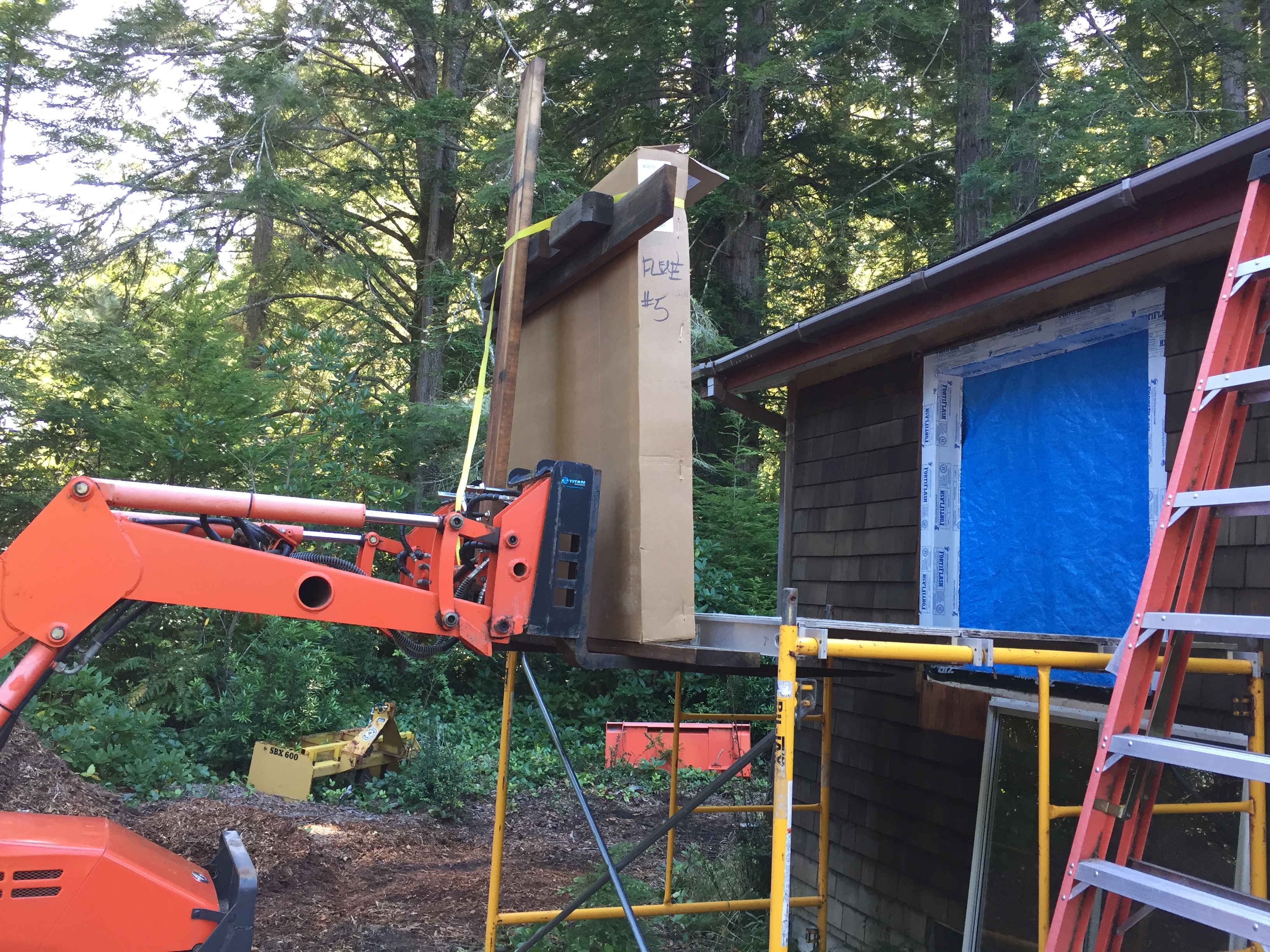

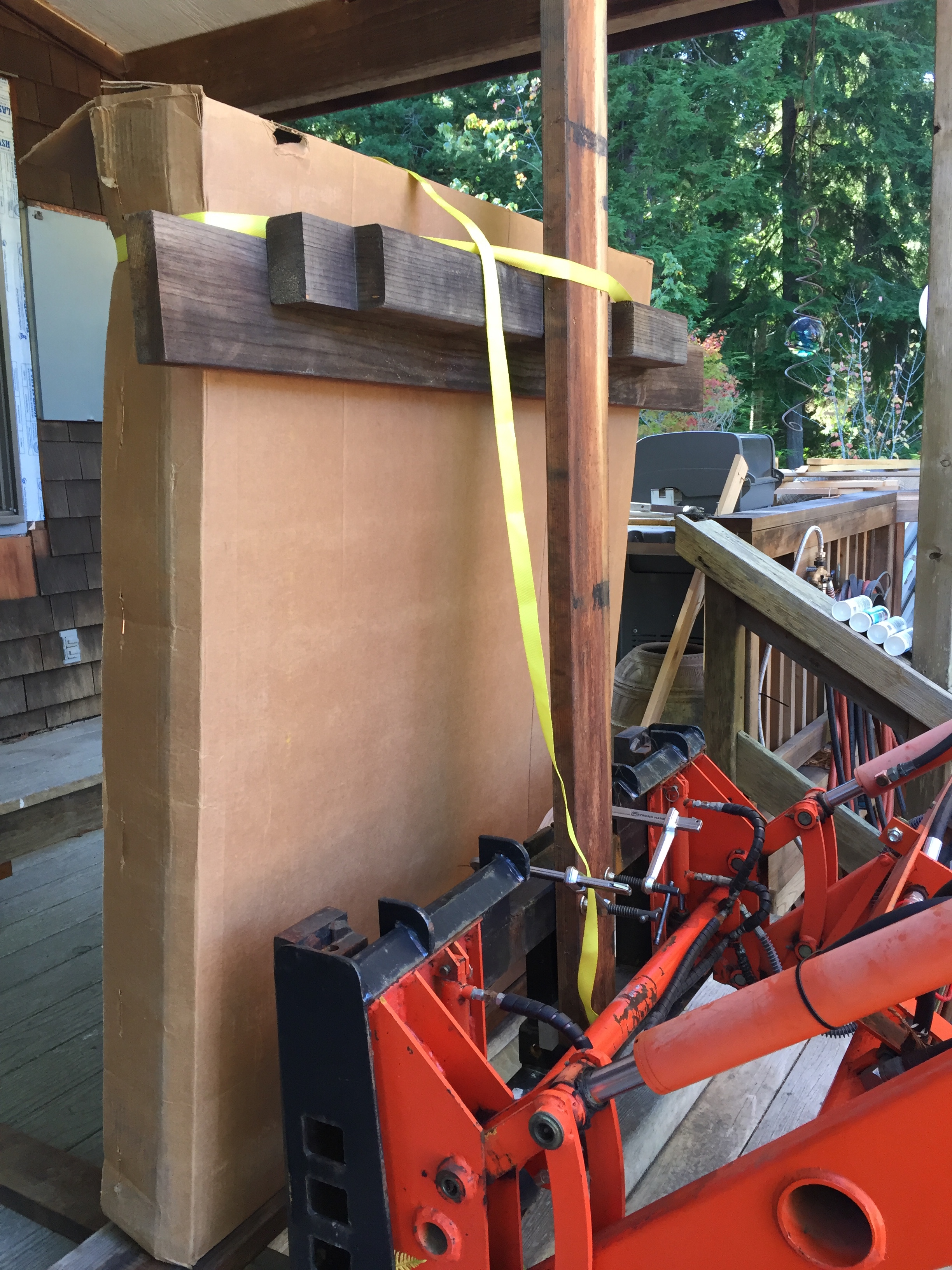

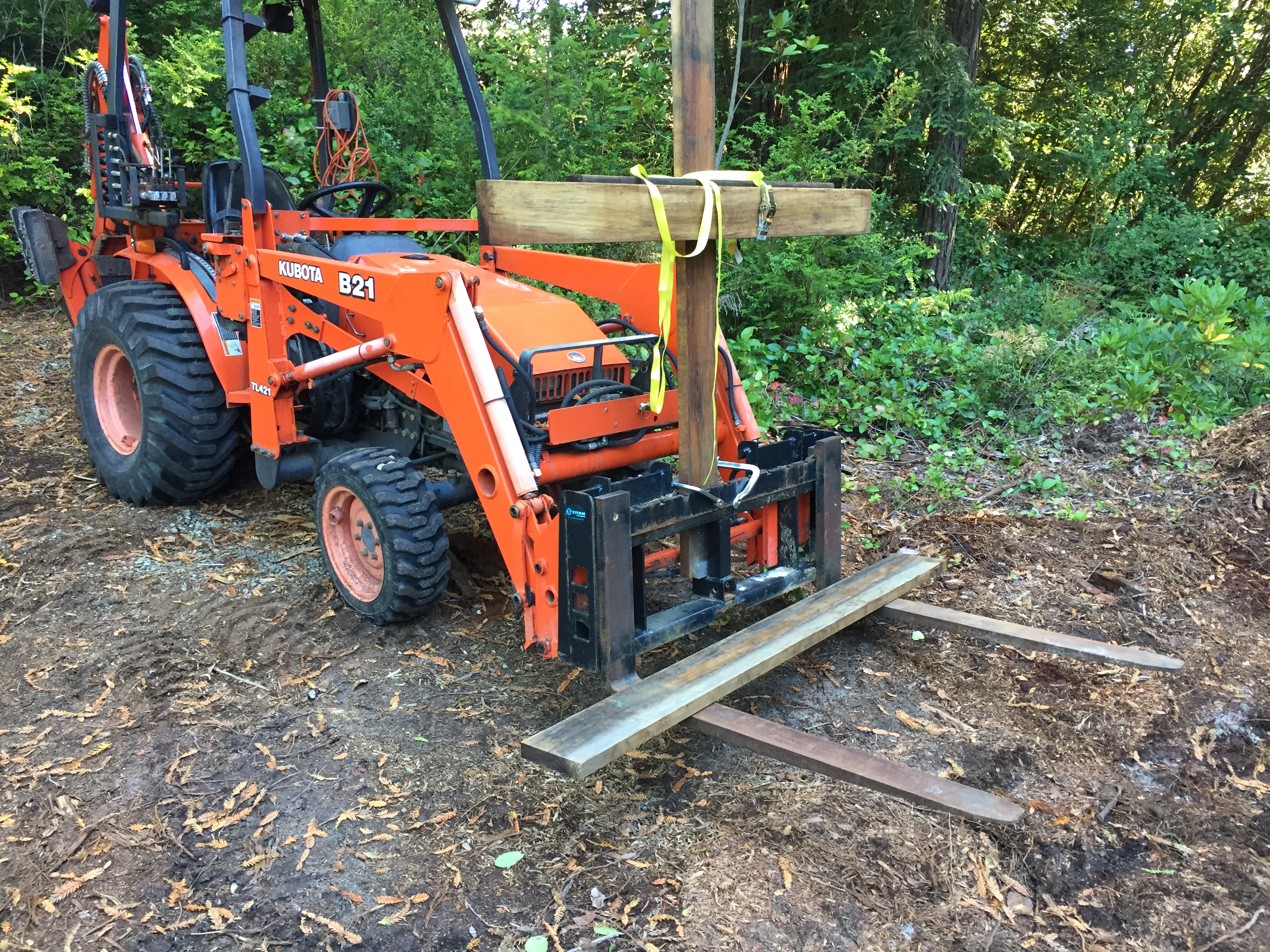

I am replacing the windows in the Mendocino place, they were cheap aluminum sliders 25 years ago and have not aged well. The new windows are double hung, I think about 60-70 lbs each. Getting them into the openings, sill height 5-6 ft, is not easy. Using pieces of lumber from the scrap pile, I made a simple brace, then used welding clamps to attach it to the pallet forks. With the brace I was able to safely carry the windows over rough ground around the house. The loader forks then make it easy to get the windows into working position. Once on the scaffold, installation was a piece of cake.

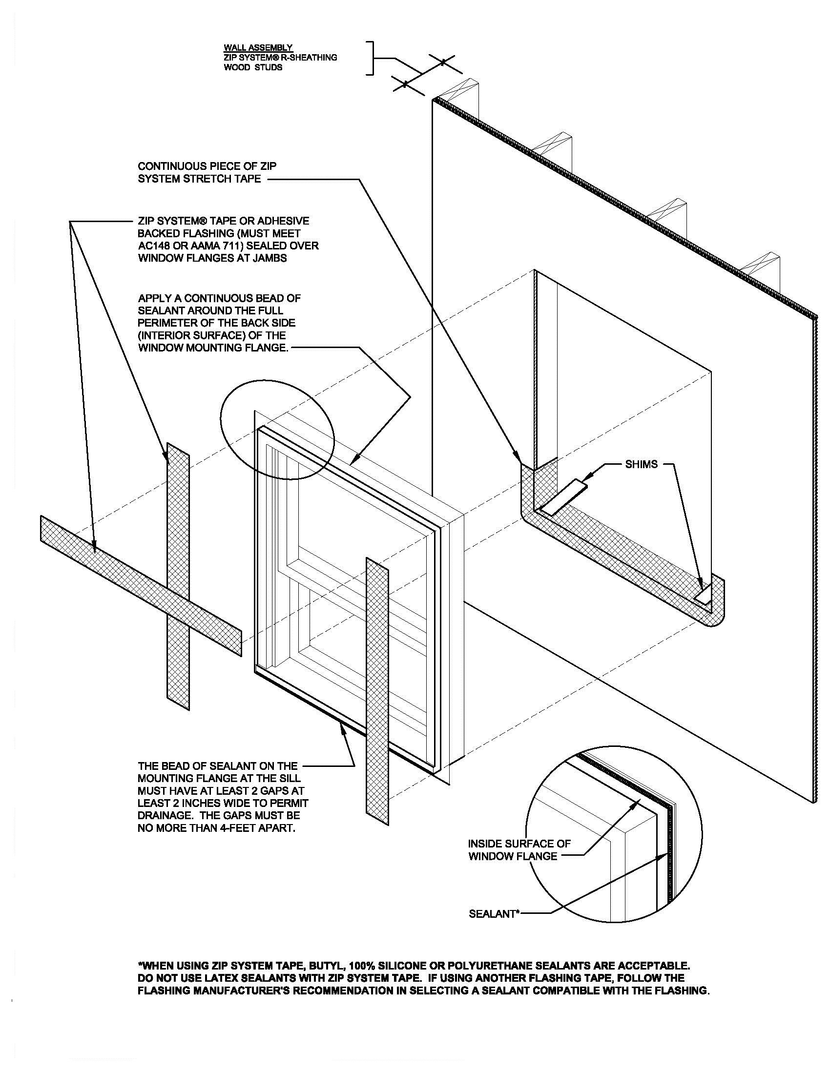

Nice job with the flashing tape around the opening. Did you use tape around the window after it was in place? I've tried quite a few different brands of flashing tape and wasn't overly impressed with any of them until I discovered Zip Tape. That stuff is amazing!!!!!!

Thanks Eddie. Yes, I used Zip tape for the bottom pan, you are right, it is amazing. About 4 inches up on either side plus the bottom, all corners, no gaps, no wrinkles. I used a product called Fortiflash for the sides and top flashing. It is thinner, stickier and more flexible than the usual window flashing tape. Then I caulked behind the top and side window flanges with siliconized caulk, I like it better than pure silicon. I got some ordinary 4" sticky rubber flashing, and will use that temporarily over the window flanges to cover the screws and flange edges. After the winter I will be replacing the siding, so at that time will replace the 4" tape with the wider Fortiflash tape which I really like.

That is what the stretchable Zip tape does. In the diagram attached, it shows how to use it for a one piece, no seams, no gaps, no wrinkles installation. I am not sure when it came into use, this is the first time I have used it.

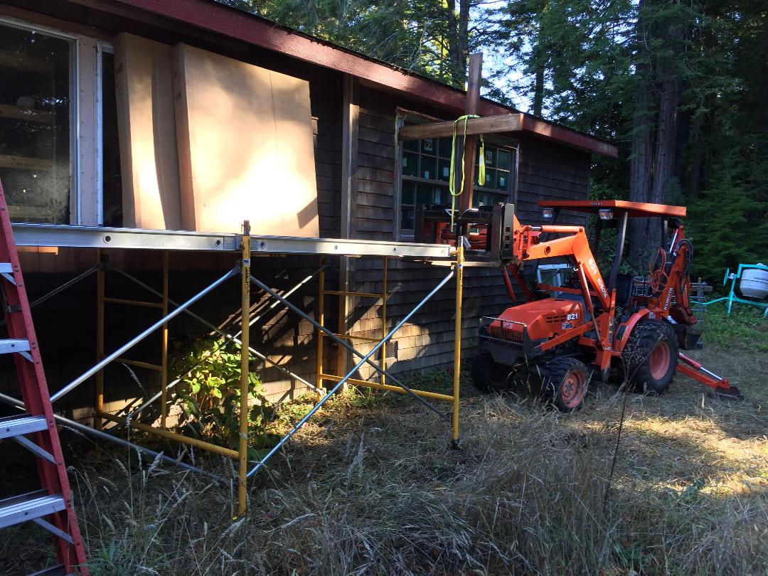

Last two windows positioned for installation tomorrow morning. I got three stages of that lightweight scaffolding decades ago. Do not need it often but sometimes it is about the only way to get the job done. Now, the three pieces of scrap lumber that made a makeshift brace for the pallet forks. They have served with distinction and can go back into semi retirement on the lumber scrap rack.
Nice diagram. The more I use Zip tape, the more I like it. Foil tape is good for some things, but Zip tape is what's impressed me the most!!!!!
McCoys sells it for $25 a roll, and the only other lumber yard that has it in my area sells it for $35 a roll. Crazy how much more they get for it, but when McCoys is sold out, I've gone and paid the price for it when I really need it.

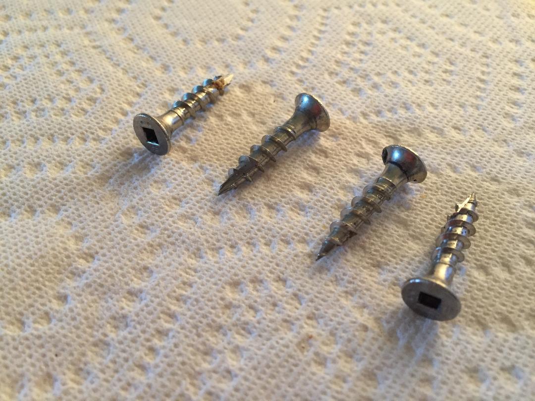

Screws did not come up. Each window gets 42 screws, every three inches on the top and every six inches on the sides and bottom. Having the right screw can make a difference. I used these #10 x 1" stainless steel screws, square drive, with a "auger" point. They drive in straight and quick with no cam-out.

Those look like good screws. My new favorite all around screw that I use on just about everything that doesn't need to be 3 inches or longer are Hardie Screws.They have a thick shave, an over sized head and they are coated to deal with the elements. I like them a lot!!!
