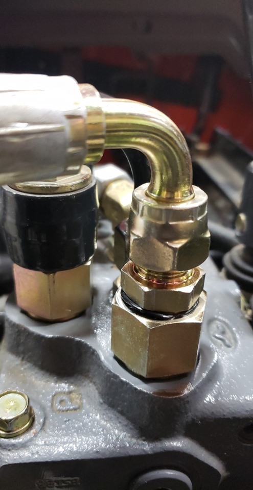

This is the offending fitting. The adapter was there from OEM. The top of the hard pipe that connects to the rubber hose stops the detented rear remote lever from moving all the way back now. Maybe there's another way to do this or just leave it since it isn't leaking....yet?

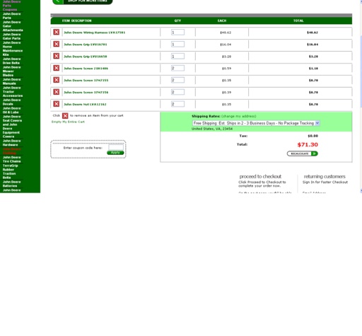

View attachment 623080View attachment 623081
I do agree that the JD handle is extremely comfy. My dad's 3046R has this handle and it is rather intuitive on the button layout. The NX I test drove prior to purchasing mine was 'acceptable' but not as 'natural' feeling as the JD UP/Down button location via the thumb. If this is something I cannot get accustomed to the pointer & middle finger layout I'll for sure be switching it over to the JD handle if it's only a $75.00 switch. I did not even think something from JD would be that cheap, lol.
What are the actual JD part numbers in your cart? The picture will not blow up clearly enough to read them.
/ Installing the Kioti 3rd function kit? read this #16
