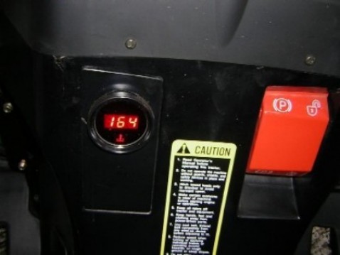

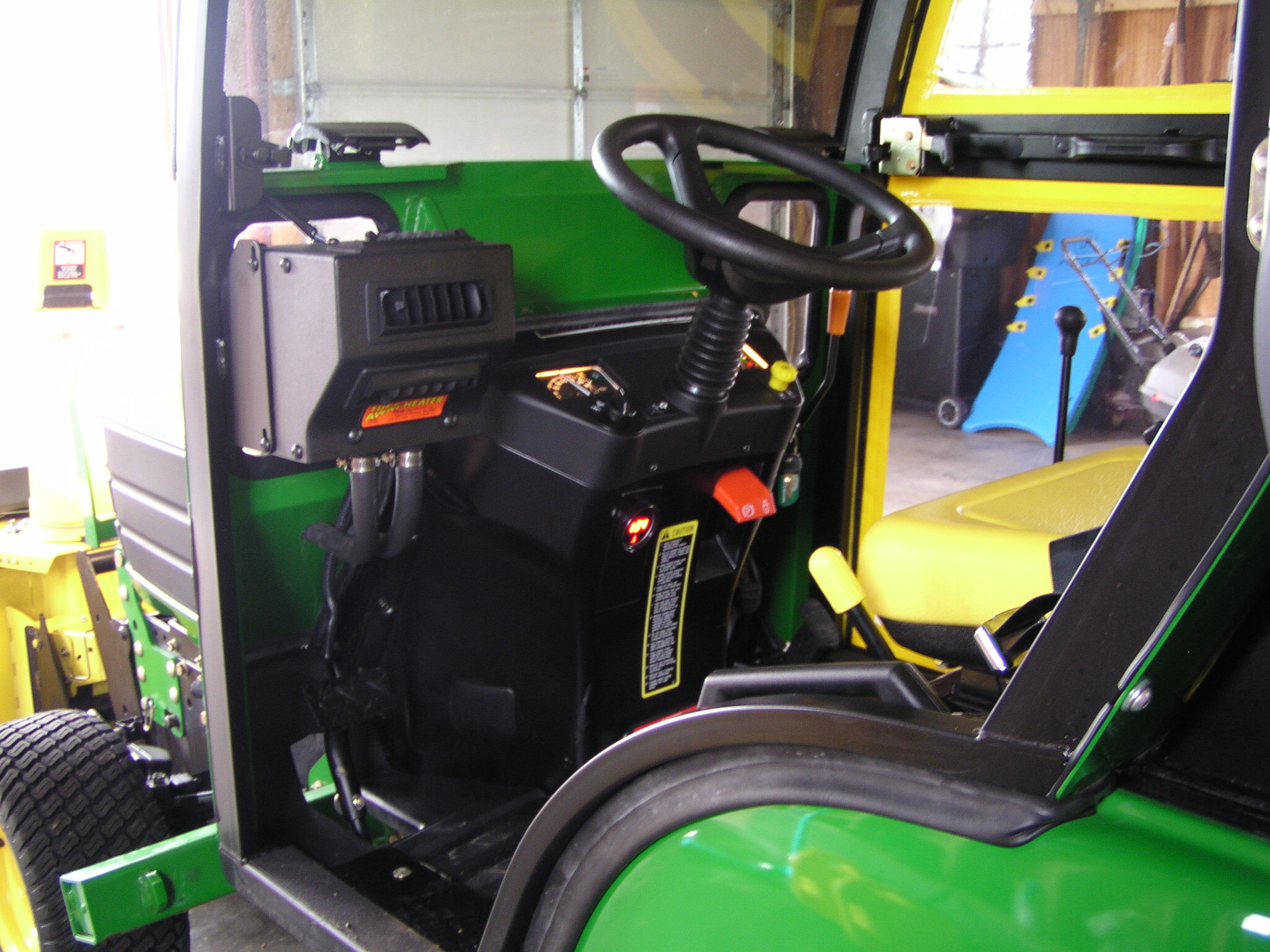

I installed a cyberdyne on my 2210 about 4 years ago. Got it from JC Whitney. I drilled and tapped the plug below the T stat housing. No problems so far. The unit came with the sender, the reason for digital was I couldn't read an analog gauge from the seat.
