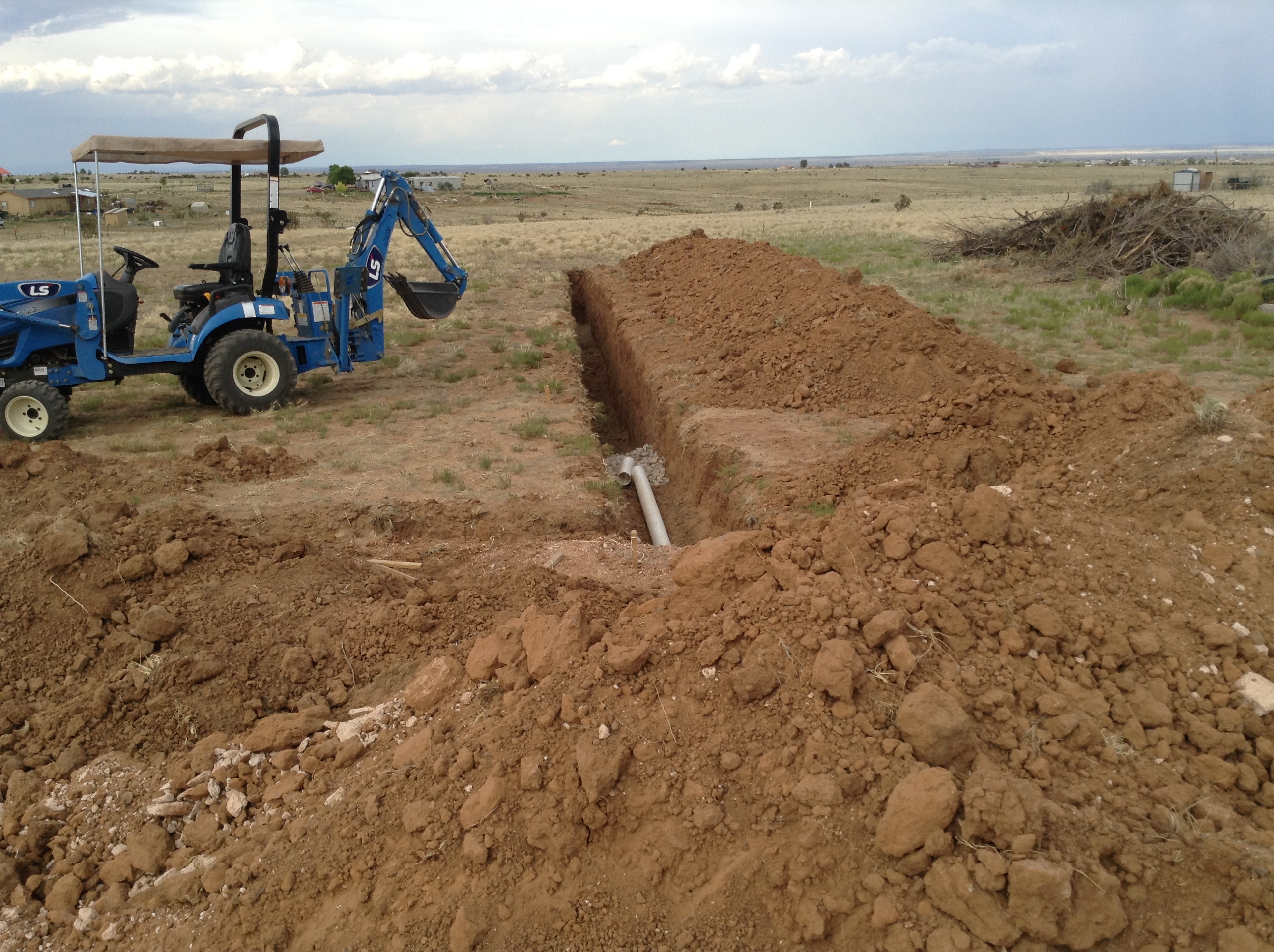

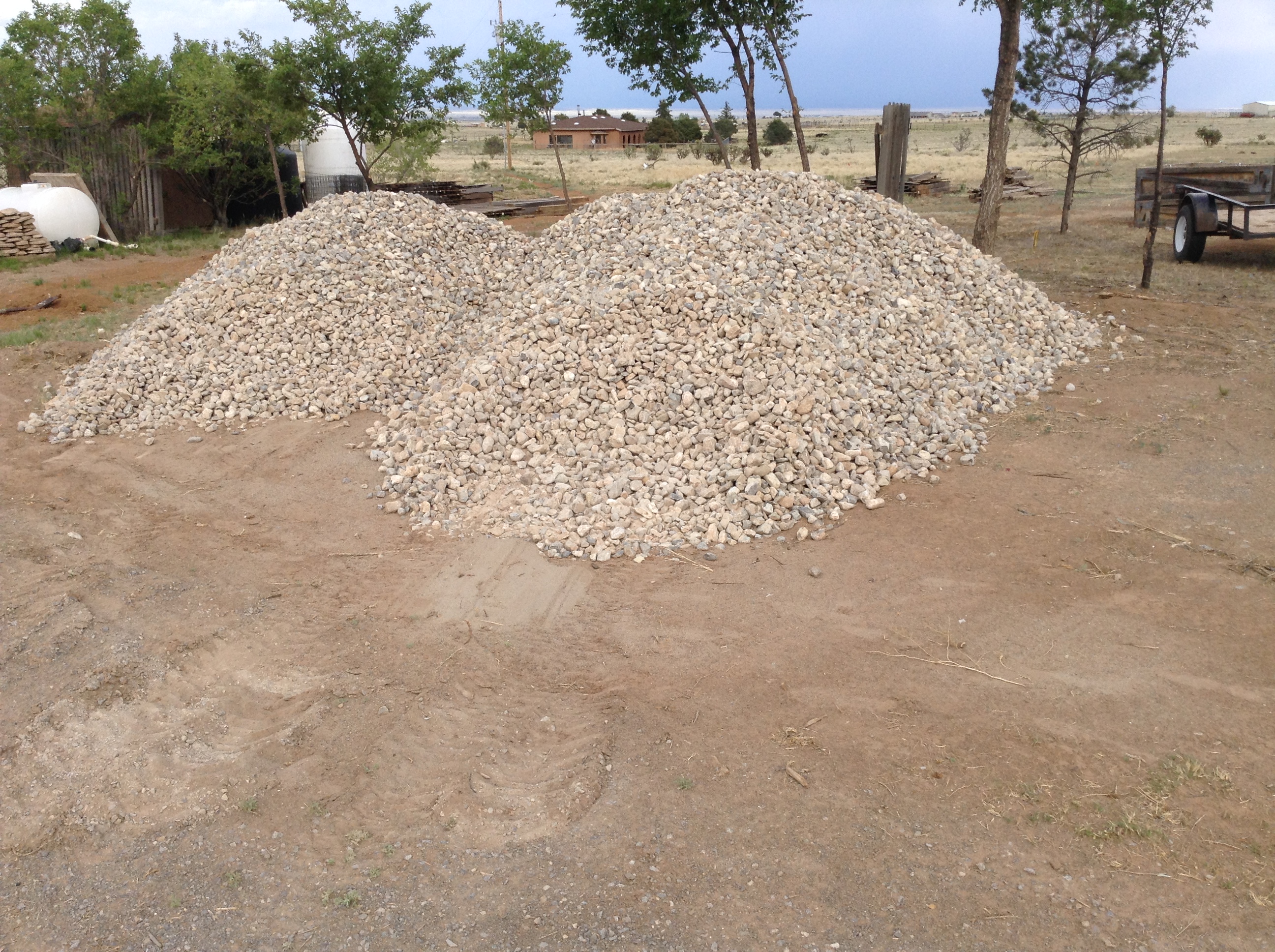

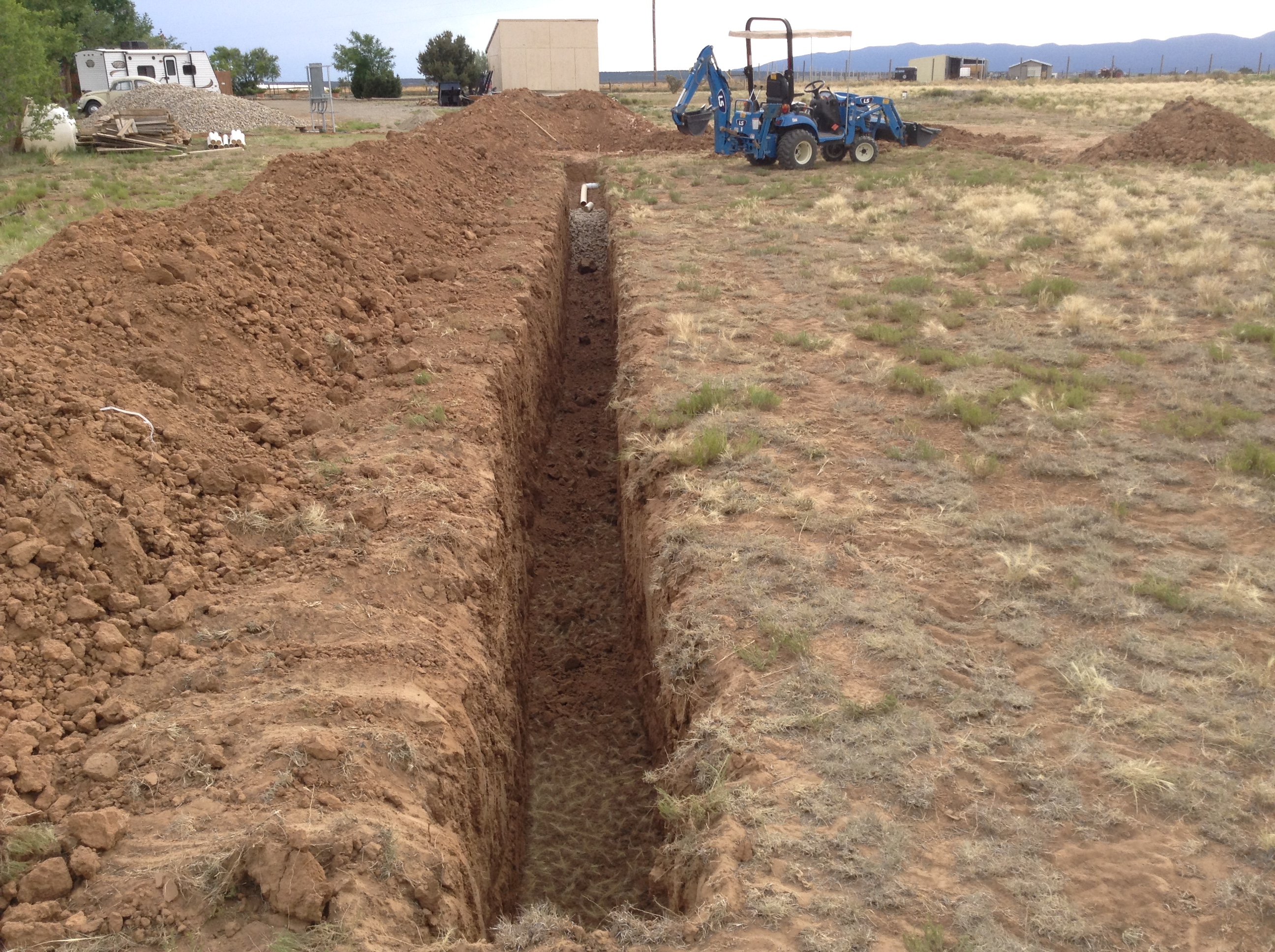

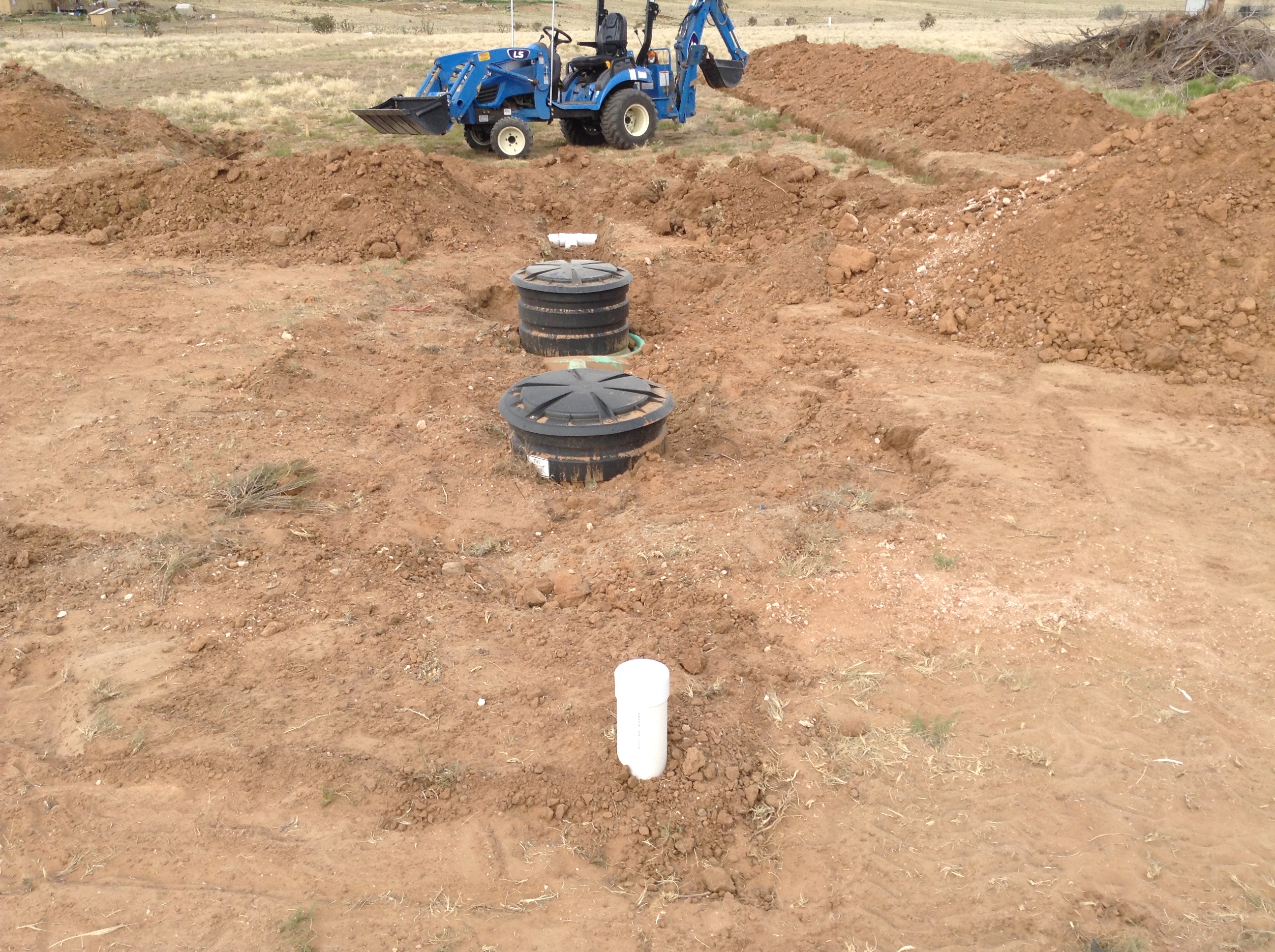

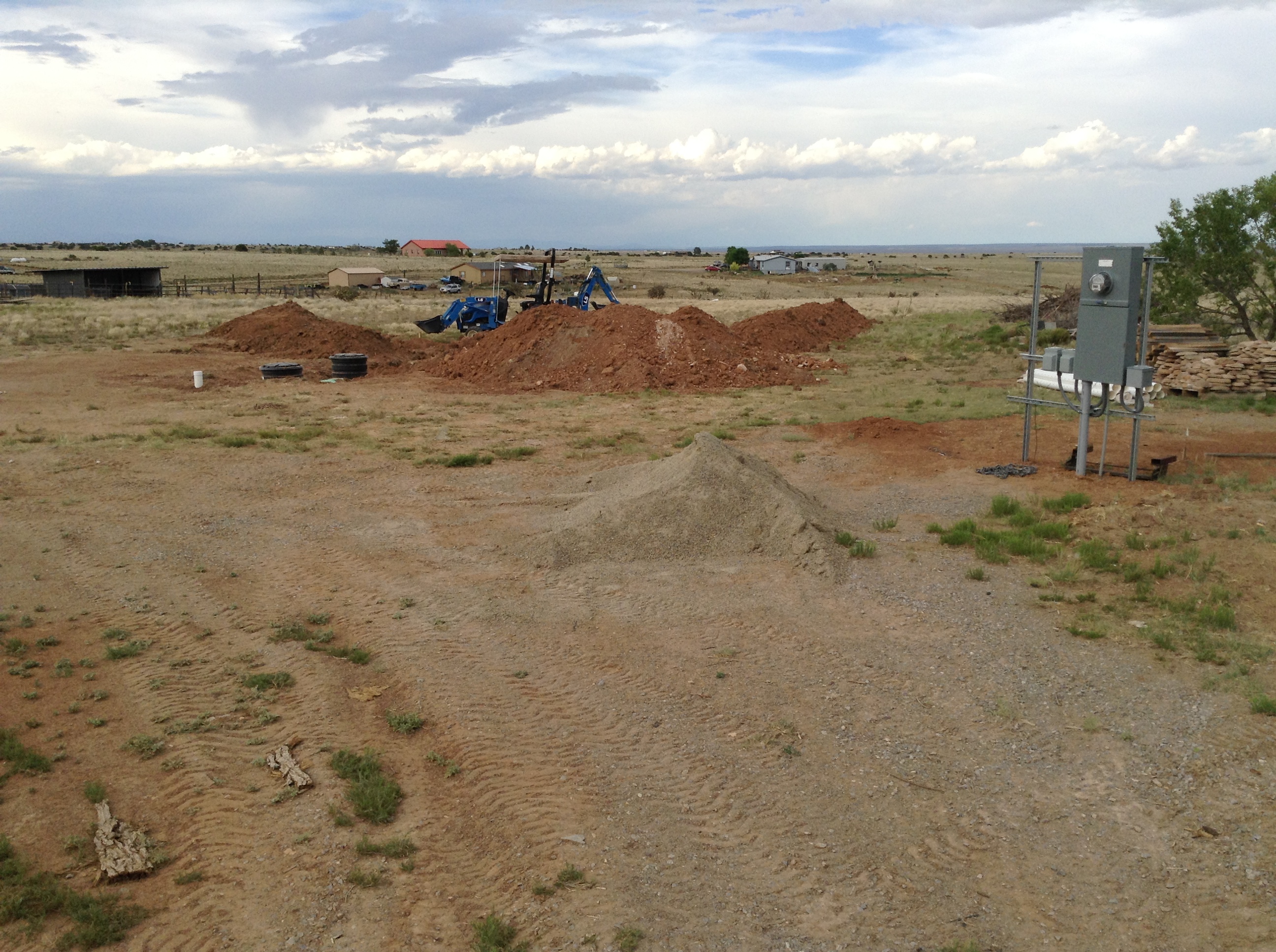

Here are a few pics of the septic system for the new house I plan to build. So far I have the 1000 gal tang in and partially back filled ( the hole was 8'w, 12'l, and 6' d). 1 of 2 trenches for the leach field is dug ( 56' long, 2' w, and 5' deep. There is a pile of 38 tons of rock that will go in the trenches. This little tractor has not let me down and does not cease to amaze me in what it can do! I have to go back on duty for the next 3 days, but can't wait to finish the system next week.

Instead of caps at the end of the leach lines do 90° and daylight them. I would also do clean out fittings at the beginning (tank side) of the lines and daylight those as well. Makes for easy inspection, maintenance and it's just nice to know where things are.
It's hard to tell but it looks like a simple T between the two lines. Remember the flow out of a septic tank is very minimal. With that thought the tee will have to be perfect or better to ensure even distribution between the two lines. Most would opt for a distribution box so it's easier to adjust as things move over time. You will want to mark that location too.

Looks good! Nice work. It's looking good out there! The panel etc also looks good! The dream is near.....

Probably not in NM but around here you'd have to fill that tank so a big rain didn't float it out of the ground. Nice views, and a nice straight trench. Must not be many rocks!

Yes this standard practice. It also provides some outward pressure as you backfill- this is more for the plastic tanks.

Already planned on all of the above except for the D-box. I initially drew the plan and submitted them with a distribution box, and the engineers at the environmental dept changed them and said to use a "T" instead. It sits on a concrete block which is dead nuts level. The D-box would have been easier. Your right about the size.... 3br system, but I'm building a quaint cozy 2 bar now that the kids are grown and gone.

Yes it was filled before backfilling. We will rarely get torrential downpours / storms that cause flash flooding and will float out a tank. The environment dept recommended to fill it and also the manufacturer. The property is on top of a hill so drainage is good. You reminded me of living back east in Bucks Co Pa when you mentioned the rocks, couldn't dig there 6 in without hitting shale. The whole trench is 5 to 5 1/2' deep and I didn't pull up 1 rock, not even a pebble bigger than a 1/4".

Unless you're building on sand around here there's no way you would get away with the leach field lines being that deep. They line them just under the surface so they drain well. 5 foot down would be hard pan on my property. You can do the work yourself still here but you do have to get a licensed engineer to design it as well as a perk test.
