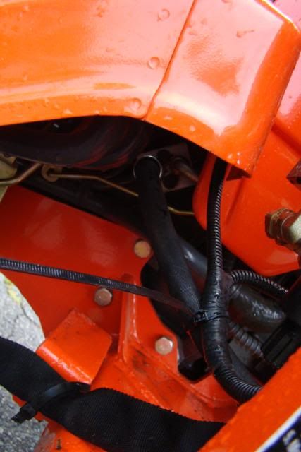

We I just finished getting everything working. I was having a problem with my quick connects. The were restricting the flow of hydraulic fluid and it took me a bit to figure it out. I wound up eliminating them and It works great now. I went and changed all the fluids and then pulled a couple of stumps up. I have some more welding to do tonight and I will be good. I will continue with my pond tomorrow

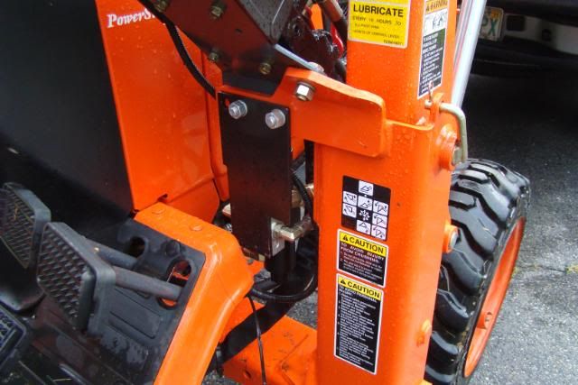

WR Long Diverter
Power beyond line
New loader control switch to operate Grapple

I love it, it was very easy to install & WR Long is very quick to answer questions. There is a lot that is very vague and that is why I posted the 3 video's. The installation of the WR Lond diverter is exactly the same.
