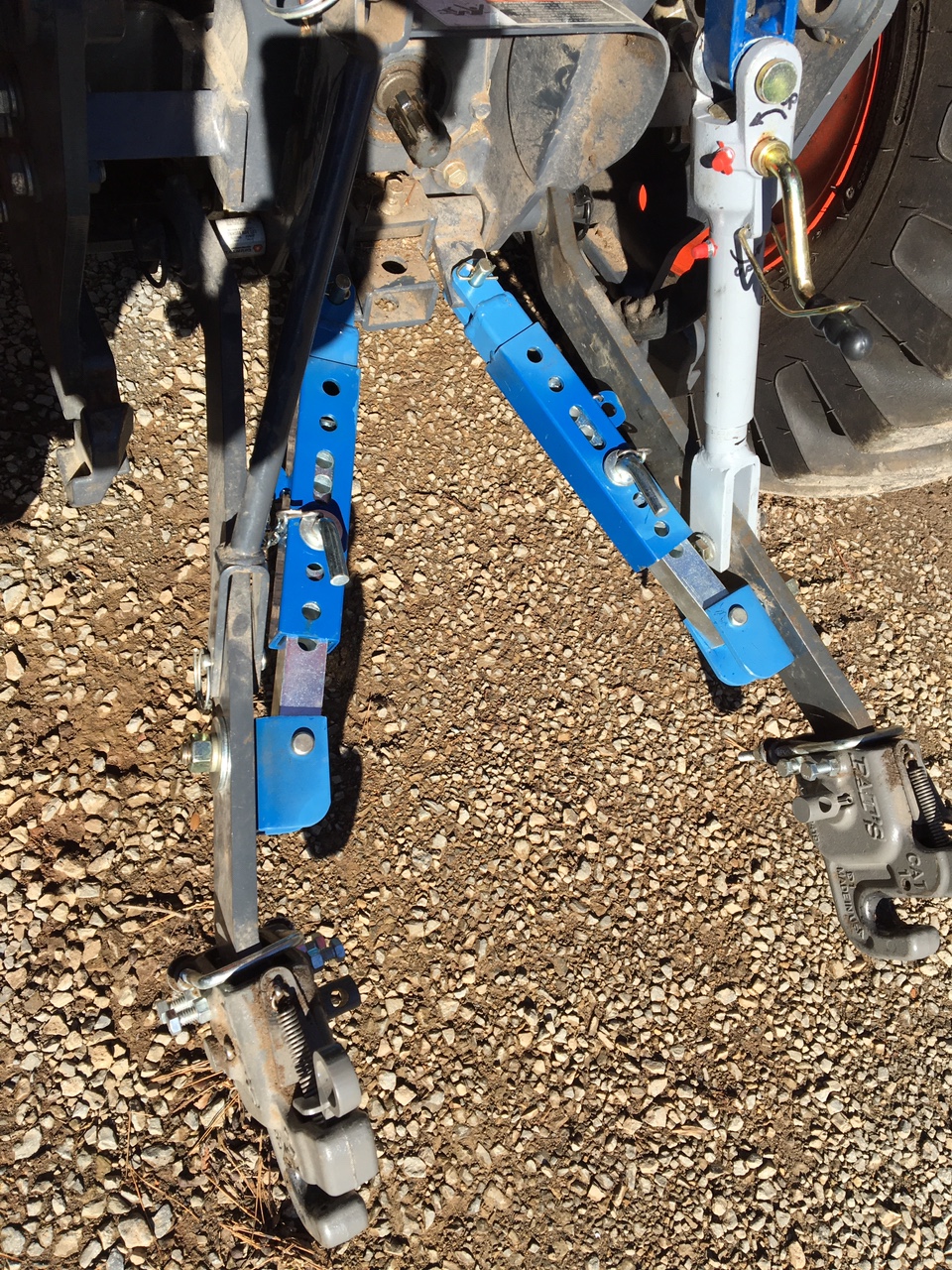

Excellent work by downsizingnow48. SurplusCenter.com has got plenty of my business. Good specifications and are quick to answer questions. Top quality hoses if you can use them.
Agricenter top link dimensions don’t specify min/max length as center of holes but probably are. Good question to ask them.
The 3pt hitch is bigger on my B26 than my old B20 with higher lift capacity. Pat’s quick hitch also requires longer top link length.
Never cared for turnbuckle sway control or side link adjuster. So if in the fabrication mode make some telescoping sway bars. Together with Pat’s makes changing implements easy. IMG_0669.JPG
