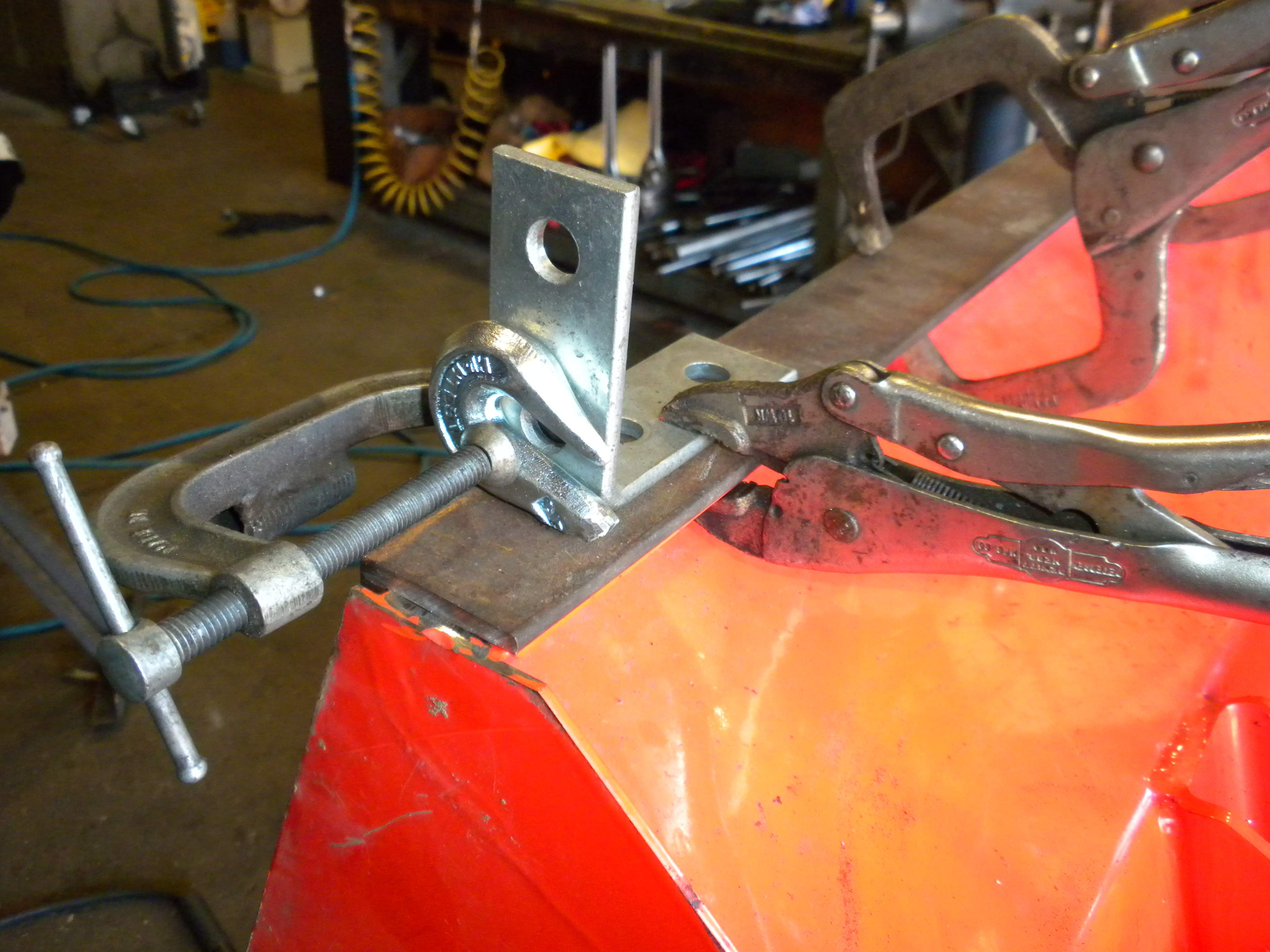

What is the best way to add hooks to my fel. Welding or drill a hole and use clevis style.
/ installing hooks on fel #2
I plan to buy some weld on hooks and weld them to a plate which I will bolt on the loader bucket.
just cann't seem to find bolt on hooks in ontario. might have to order them.

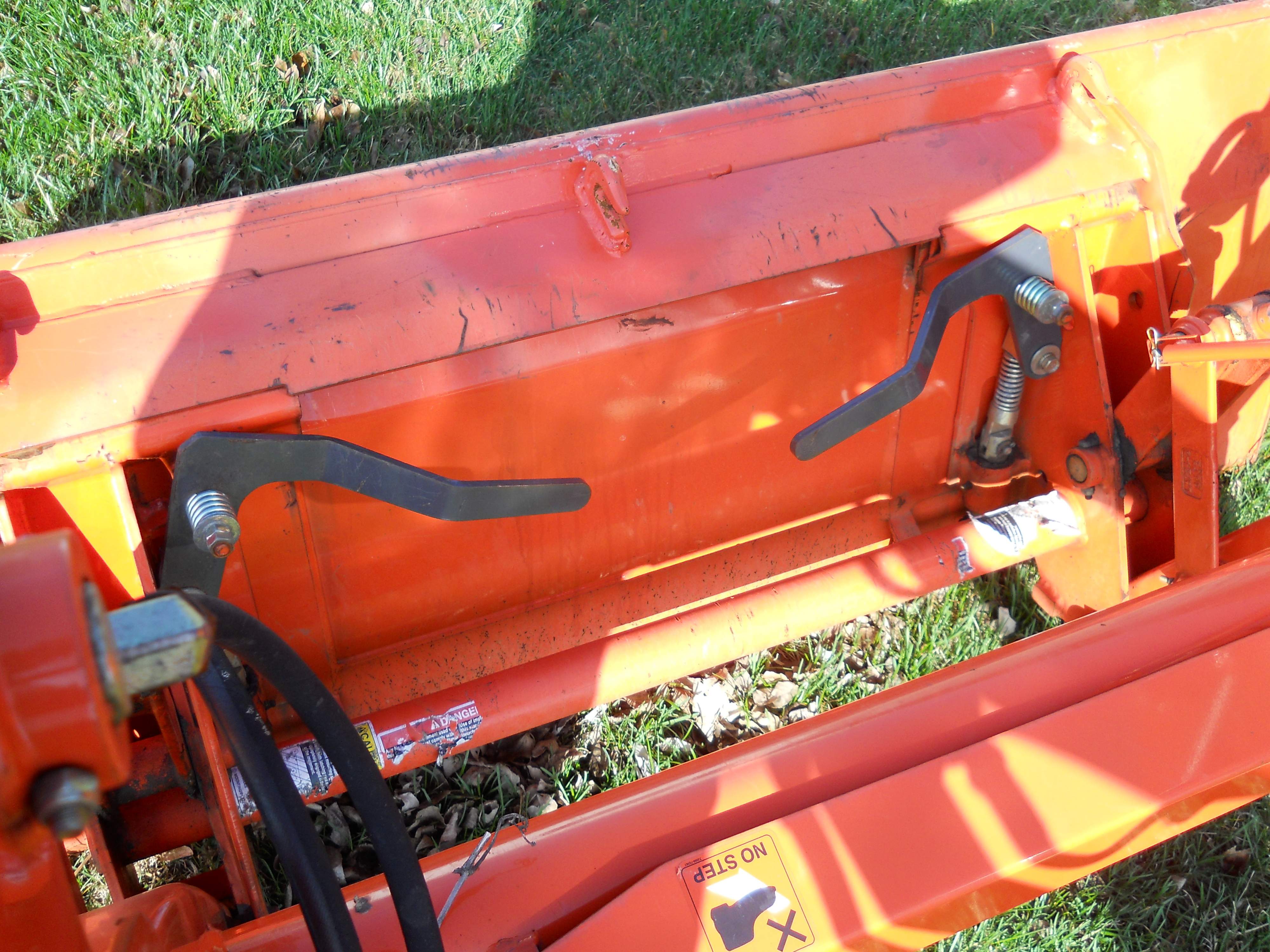

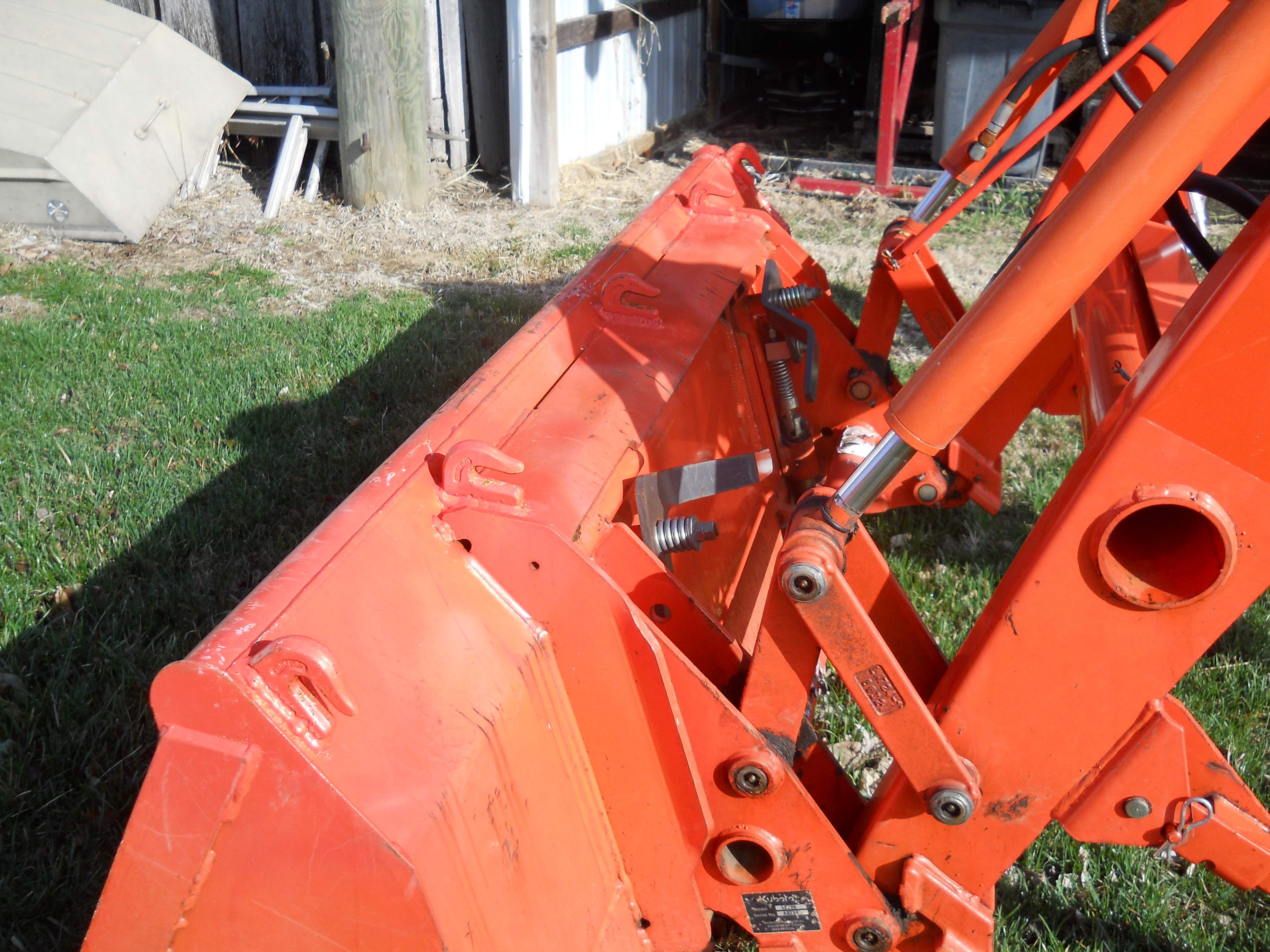

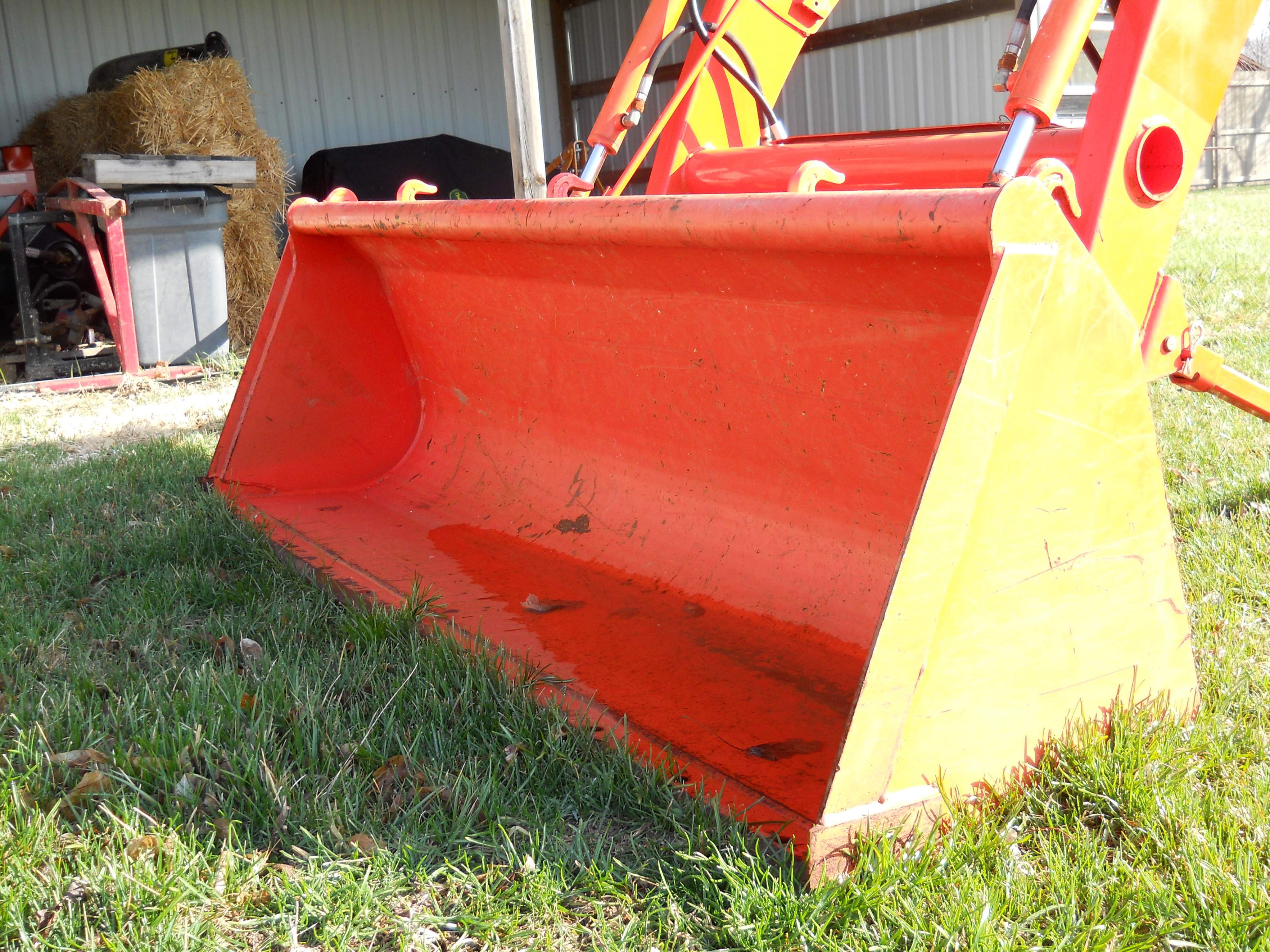

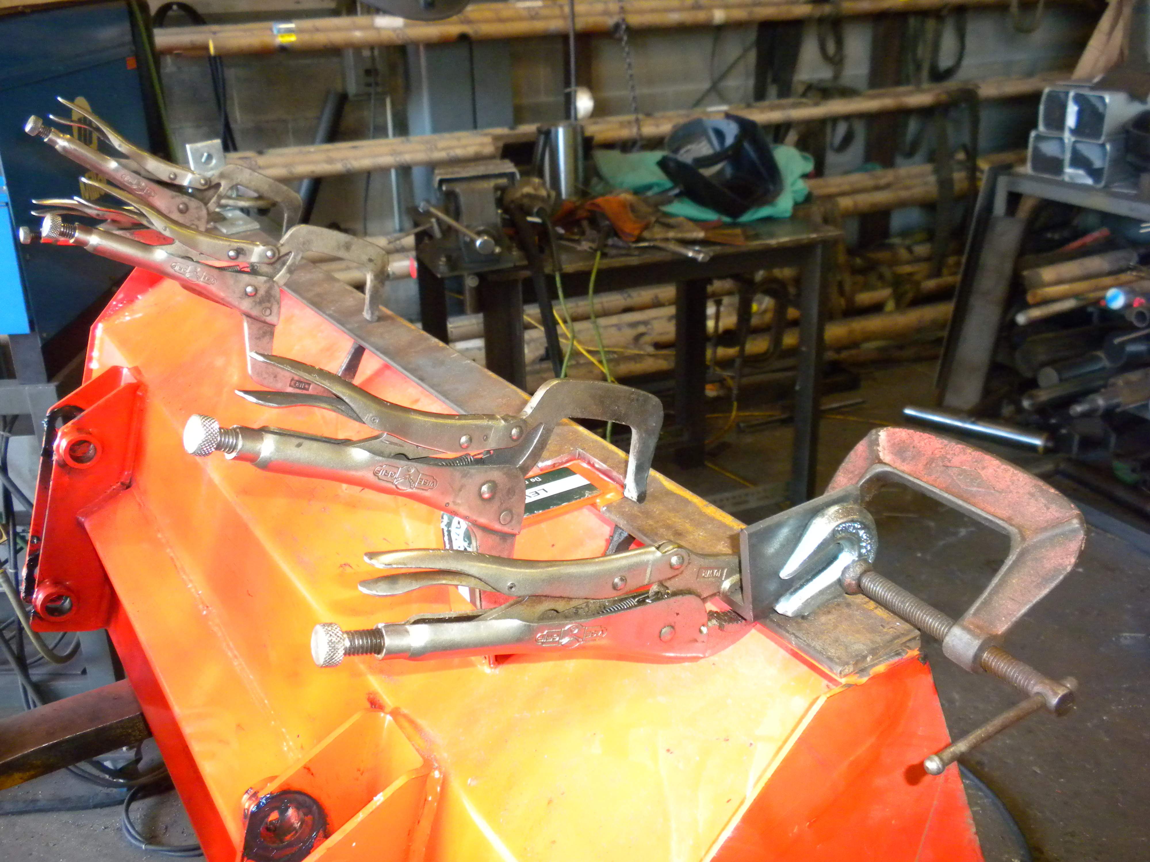

/ installing hooks on fel #5
/ installing hooks on fel #6
I did the same as the previous post except I turned the angle iron around 180 which closes the back of the bucket. 2x3x1/4 angle. This also gives the top of the bucket more srength. 5/16 hooks on each end and 3/8 in the middle.

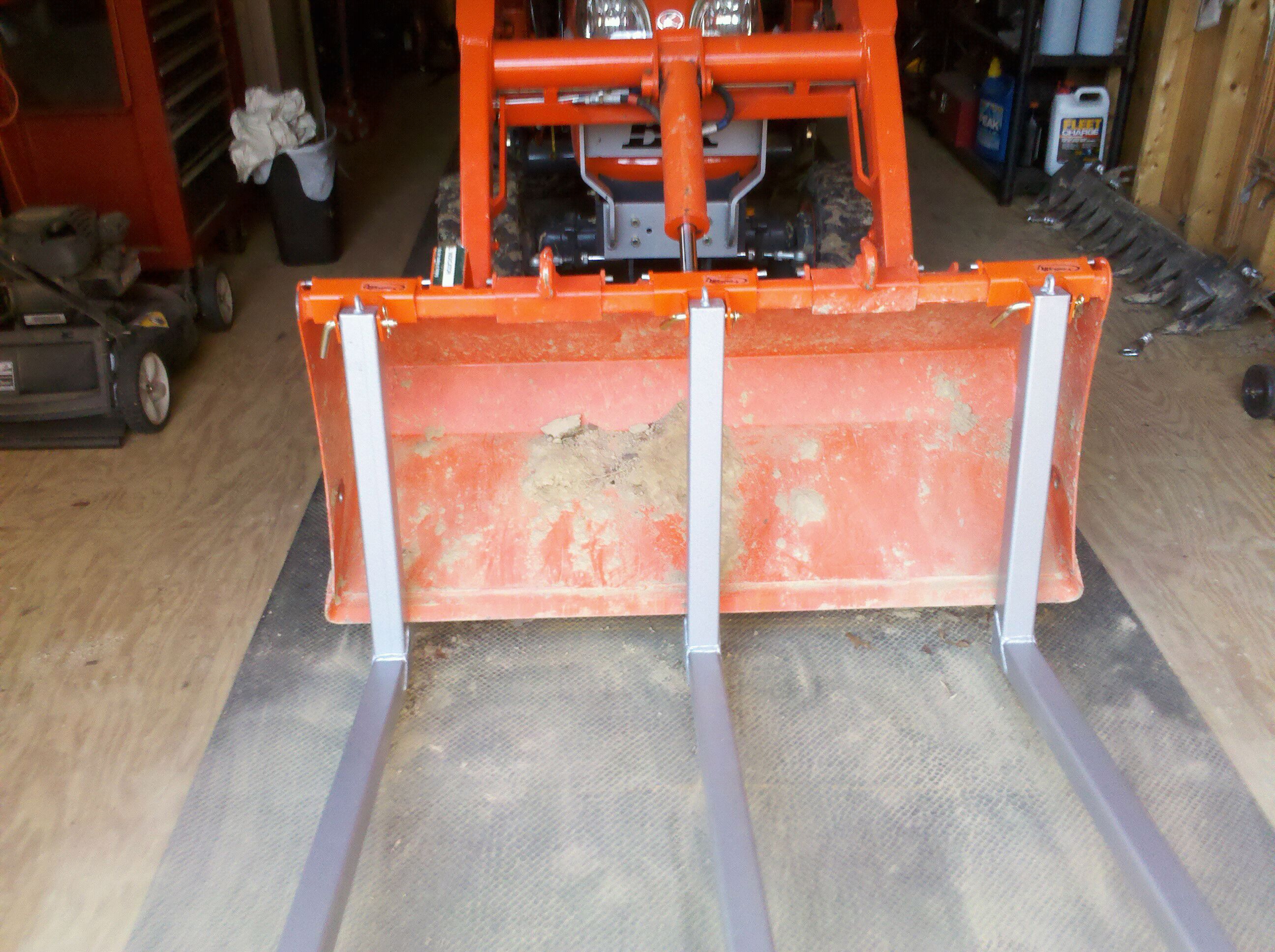

I see that you have a BX2660. If you are looking for a different option other than welding or drilling a hole, you may be interested in what BXpanded has to offer Bucket Hooks. They mount and dismount in seconds. Attached is a picture of mine along with their brush forks.
/ installing hooks on fel #9
Those look great, I went to the website but still can't figure out exactly what holds them on. Do they wedge themselves in behind the top edge of the bucket?

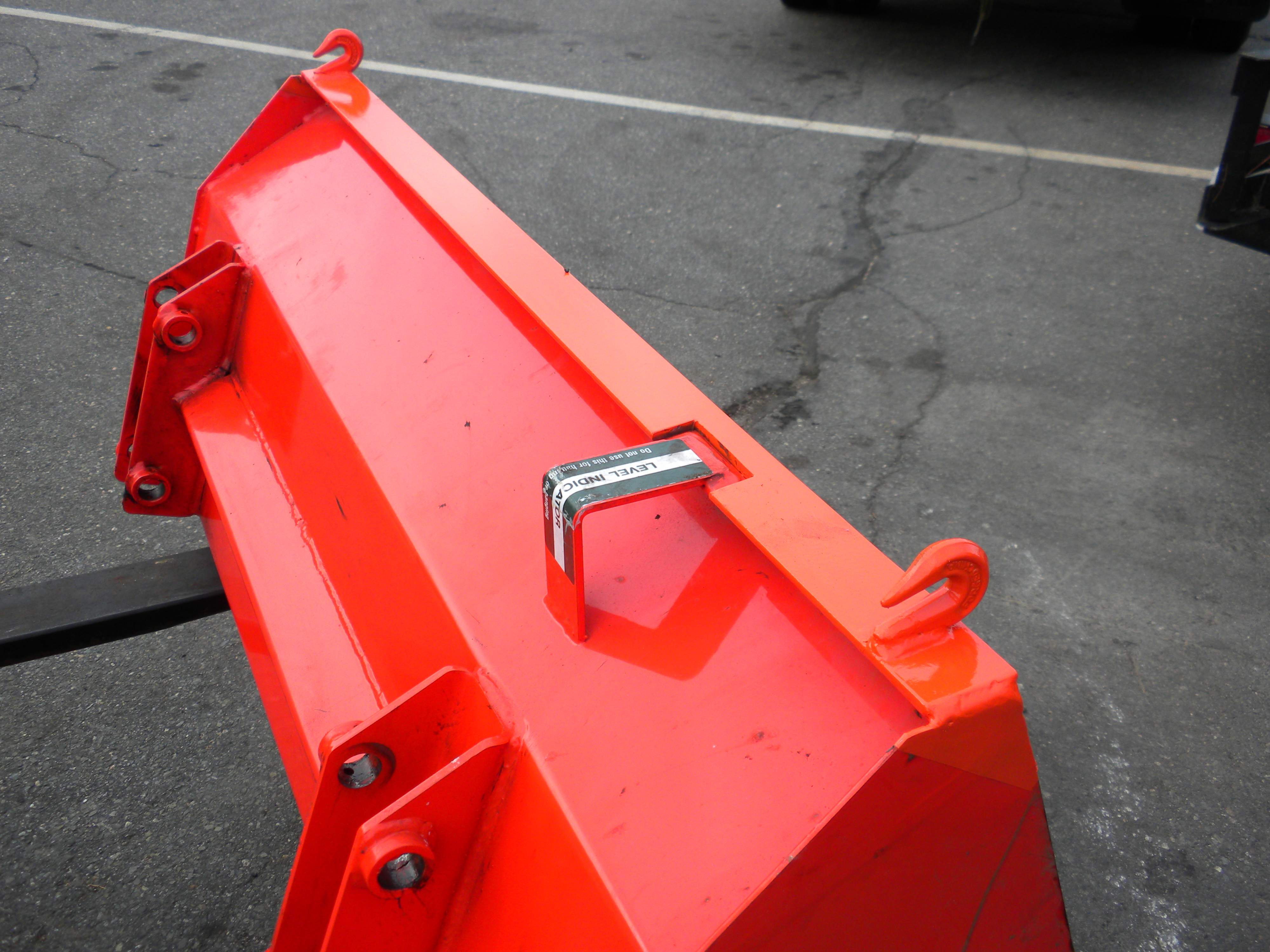

/ installing hooks on fel #10
Heres mine. Philip.
You are correct on how they mount. They fit very snuggly around the top edge and have triangle shaped supports to fit on the backside of the bucket. Attached are some photos of my ratchet rake but you can see how the bucket hooks mount. It is locked in place with the V shaped bracket.

I welded my chain hooks to my bucket after welding on some mounting plates to stiffen the bucket lip. If I was to do it again, I would still weld on the mounting plates for stiffness but I would weld the hooks onto steel bases with drilled holes and bolt them on. I would make the holes the same spacing as 4x4 tow hooks so I would swap them out if needed.

/ installing hooks on fel #20
truckntow
TrucknTow - Weld-On Grab Hooks (Pellican Hooks)
I got the 5/16 hook, it actually works with 1/4, 5/16, and 3/8 chain.
With the heavy duty round back bucket that has the pipe upper edge, there was no need to add additional support plates.
Philip.
Thanks, yeah my L5030 bucket is just like yours. The dealer put hooks on our 8540 and before I could get my son to reinforce it, the center hook was bent. I don't lift anything heavy with the center hook, but my sons do.
