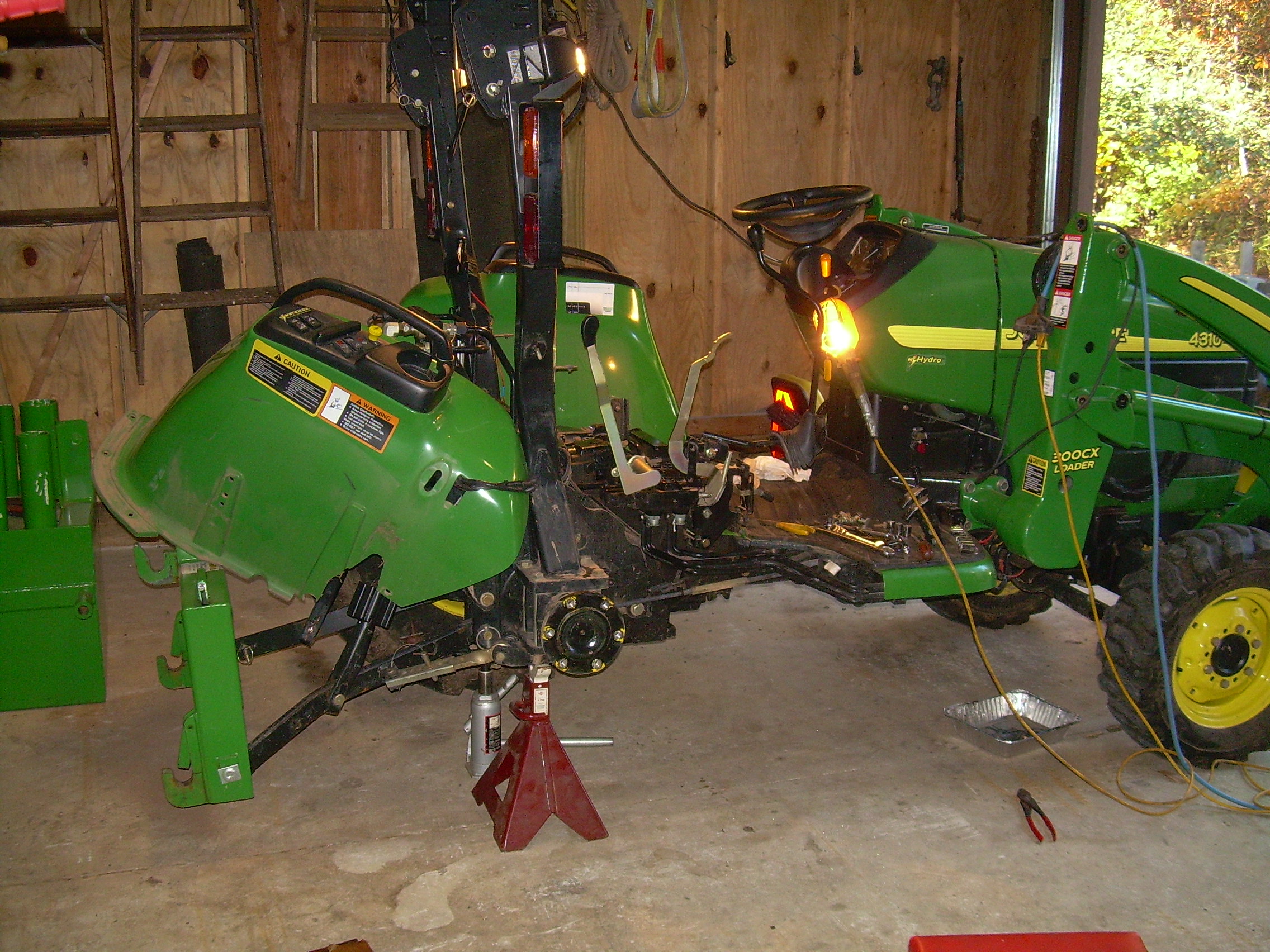

I upgraded my 430 loader for a 300cx with a dealer in upstate NY on the Mass border I believe, I'll try and find there name. anyway they sent a guy down with a small trailer with the loader on it, the guy did the swap in about an hour and a half, they charged me very little for the install and drove all the way to CT to do it.
Does your tractor have a loader valve already or do you need that also? assuming you have the valve, installing the rear 3rd scv remotes is a little involved, see picture
