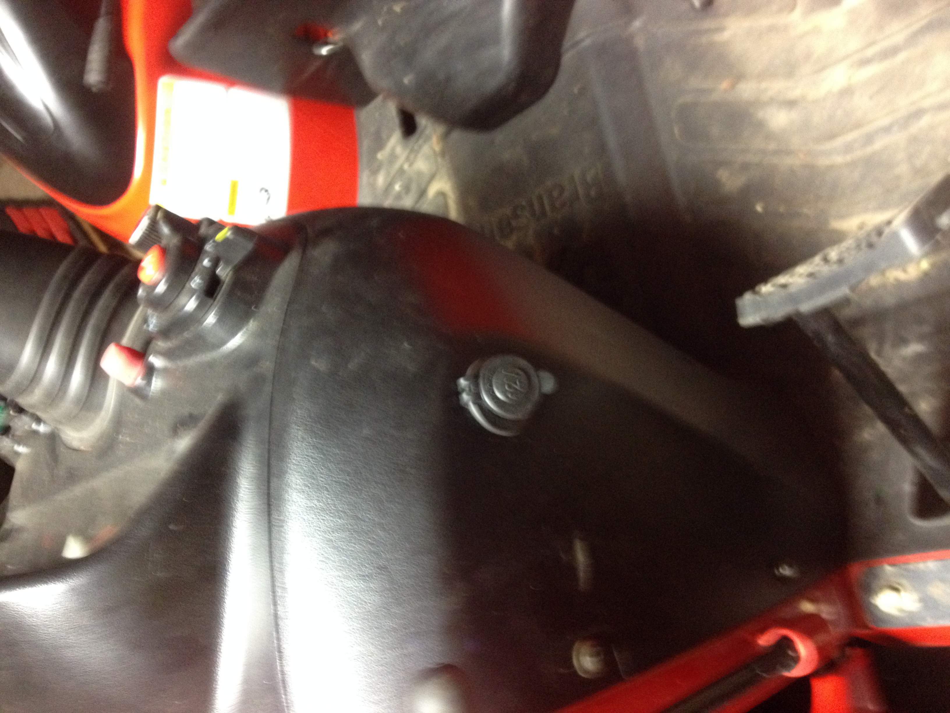

Hi all Kioti owners. I am debating on installing a flush auxiliary ( cigarette lighter) plug on my tractor preferably just above the fuse box. I am not too electrically inclined. I see the fuse box has a CUSOTMER breaker slot and I was wondering to what that means. I want to install a 12 volt circulating fan that has to have a 15 amp fuse. I have the fan just wondering what I need to hook it up. If anyone here has or knows the easiest way to hook this up, please share.

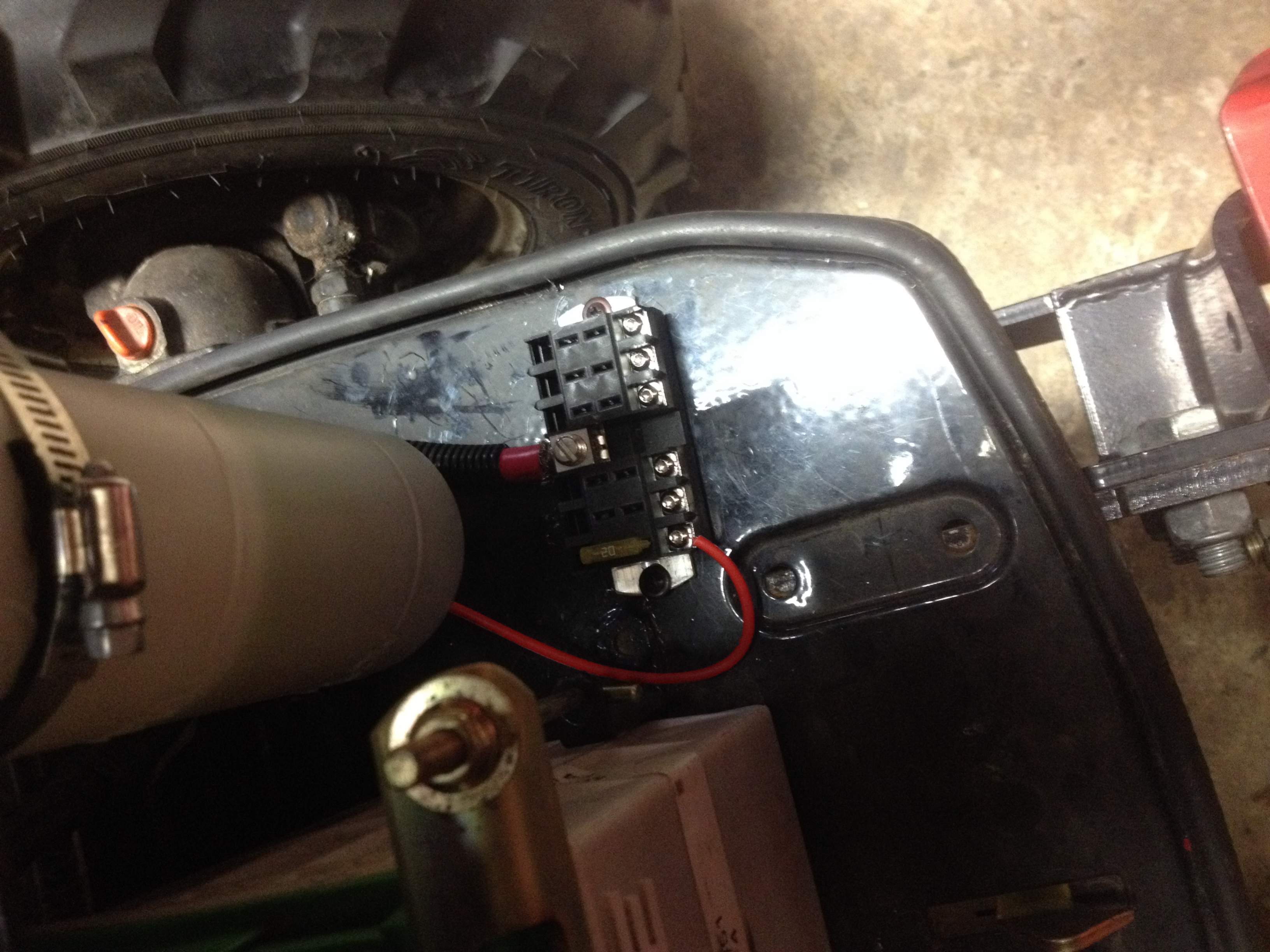

I would run a 12ga wire right to the battery with an inline 20a fuse and pick up a ground along the way. This way it is totally isolated from any switches or relays on the tractor. Since it will be unstitched and always energized you could also use it to plug in a battery tender. Just wire a male 12v lighter plug to the tender and plug it in, no more opening up the hood.

Plus 1 on this,View attachment 449513View attachment 449514

Thanks ecbaatz. Could someone post pics of the same set up from a Kioti tractor.
