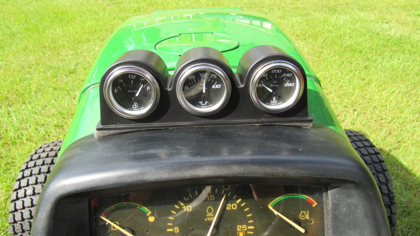

I decided to install some generic gauges. One of the biggest hurdles was to find an aftermarket fuel gauge that would work with the stock sending unit. The JD sending unit is a 5-100 ohm with 5 ohms being full. The closest gauge in ohms was 0-90 but it worked in reverse with the 90 being full. Turns out some old Ford and Chrysler products used a 73-10 ohm sender and a gauge was available for that. It has full sweep with the stock sending unit but just reads full and empty a little before the sender is at either extreme. Kind of like a built in reserve.

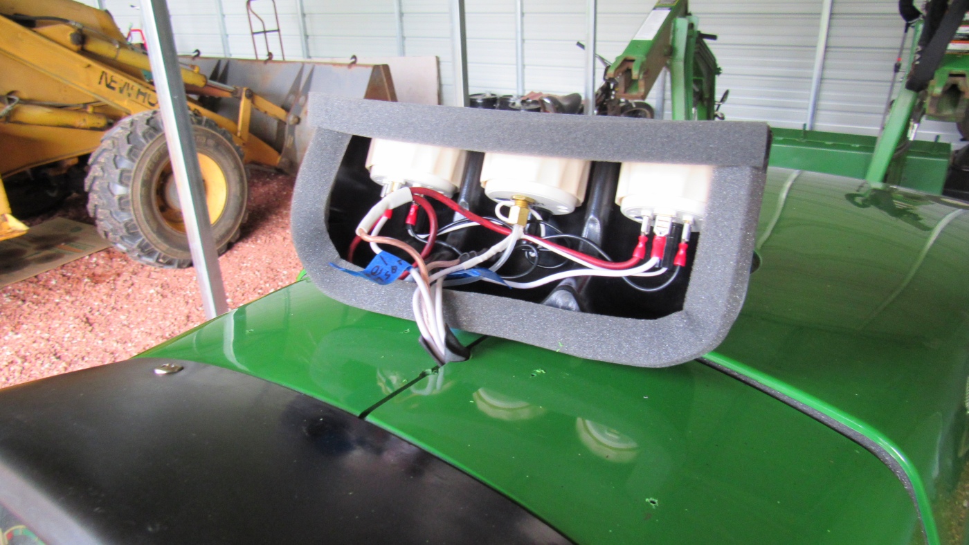

The bottom of the pod was flat and I wanted to mount it on top of my cowl so I used some poly foam insulation to compensate for the curvature. I had to cut screw holes with a hole punch to prevent the screws from bunching up the foam.
The oil pressure sending unit is in a tight spot. I had to turn the street tee just right to get the light sender back in and also attach the pressure tube. I always use a dab of Aviation Permatex on pipe threads when going into oil or gas applications.
I wired it all up proper with the gauge power to key on and the lights to the light circuit.

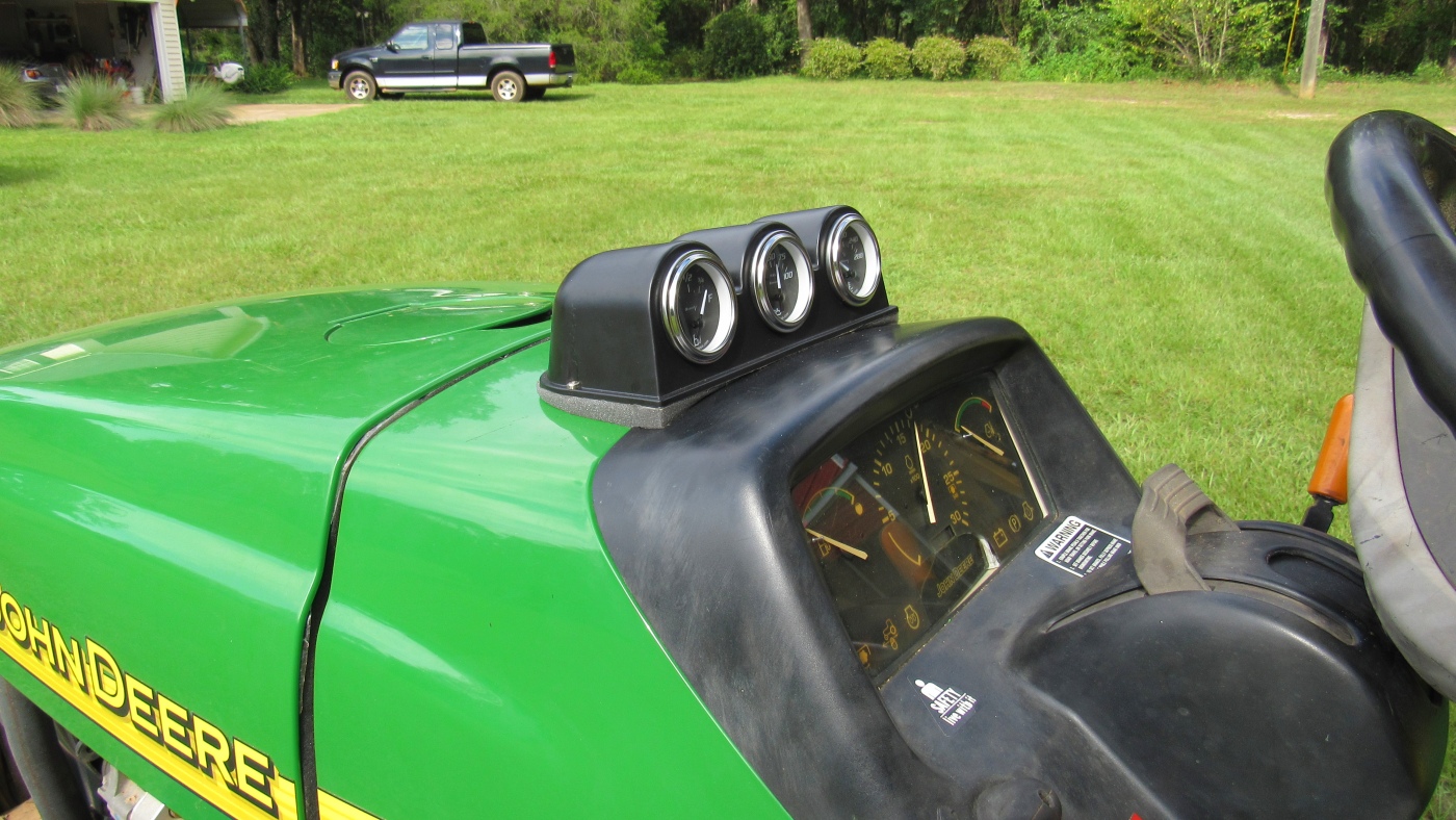

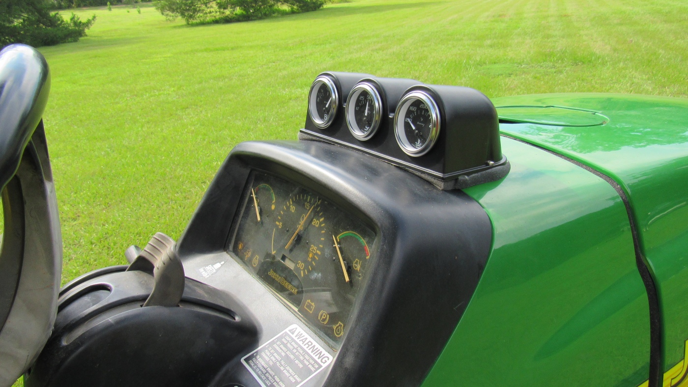

Here are some shots of the finished install.
