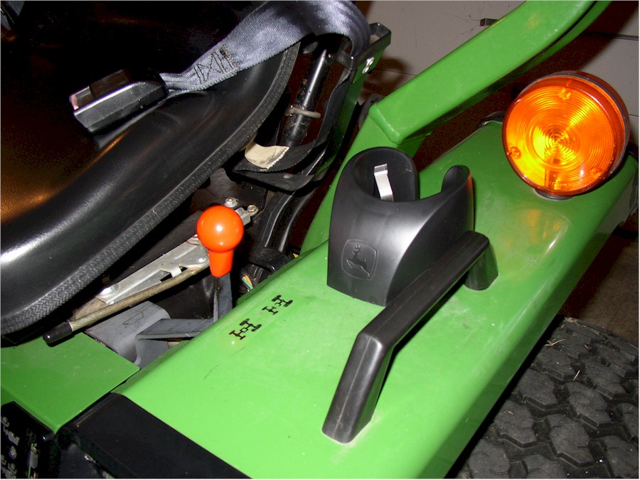

Now I need to find a cup holder I can hook up to my ROPS. Anyone got any pics or ideas of how they did theirs?
I have an adjustable and magnetic cup holder. Sticks to the fender when I want to carry a beverage along and removes so I do't destroy it in the rough country.
One of a kind, I used an adjustable cup holder I got many years ago at WTMart and glued some microwave magnetron magnets on the bottom with a bit of duct tape to scratch things a little less.
Works well.
