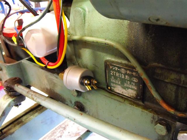

Gary, when I replaced my oil pressure sender I discovered that US and British pipe thread standards are similar. Apparently the pipe diameter and threads per inch are the same but BSPT has greater taper toward the nose of the sender. So a Japanese/BSPT sender will always thread into the smaller BSPT hole in the Yanmar block, but some USPT fittings are large enough at the nose that you can't catch the first thread.
I went through all this and tried the various combinations a couple of years ago. I posted my results in this (longwinded!:)) thread about replacing my oil pressure sender. I found that my various brass fittings weren't distorted after threading them in securely in the Yanmar block, and my experiments didn't hurt the block. But about half the fittings in my (US) brass fittings collection were too large at the tip to catch the first thread.
My point here is that you might try a USPT brass 'street elbow' (M to F threads) and aim that sender upward instead of sticking it straight out where it can snag on brush.

Well, here is how I wound up mounting it. Mostly because it tightened up at that angle and also because I would have to relocate the wiring. The photo doesn't show it but the sender is at the same level as the steering rod. Now that the loader is on there is a lot of steel in the way of limbs and such so hopefully it won't snag the wires. If it does then I'll have to come up with a shield around it.

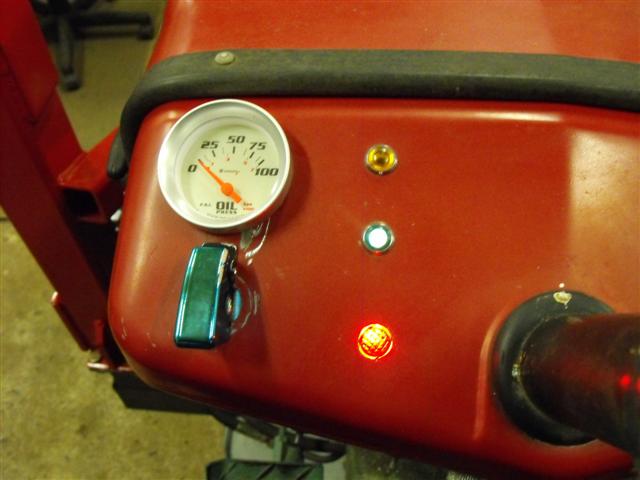

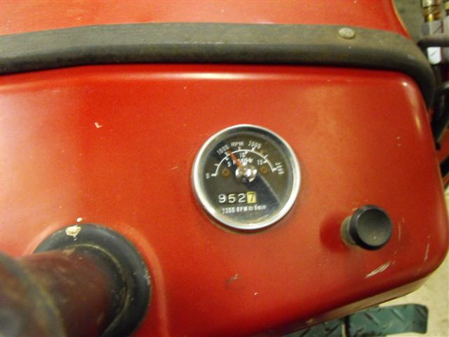

Got the gauge installed. I like the fact it came with the ability to keep the light too. Built into the sending unit. Here are the pics with the engine running at about 1100rpm. It is 68 degrees in my garage so the oil pressure will drop I'm sure when it gets hot. At least it seems the oil pump is working fairly good. I run Rotella T 15-40 and so far it seems to work ok.
And yea, I let the grinder slip when I was enlarging the hole to 2" so I get to repaint the dash again:D
The switch below the oil gauge is the TS. I wanted something to remind me if it was not off.
