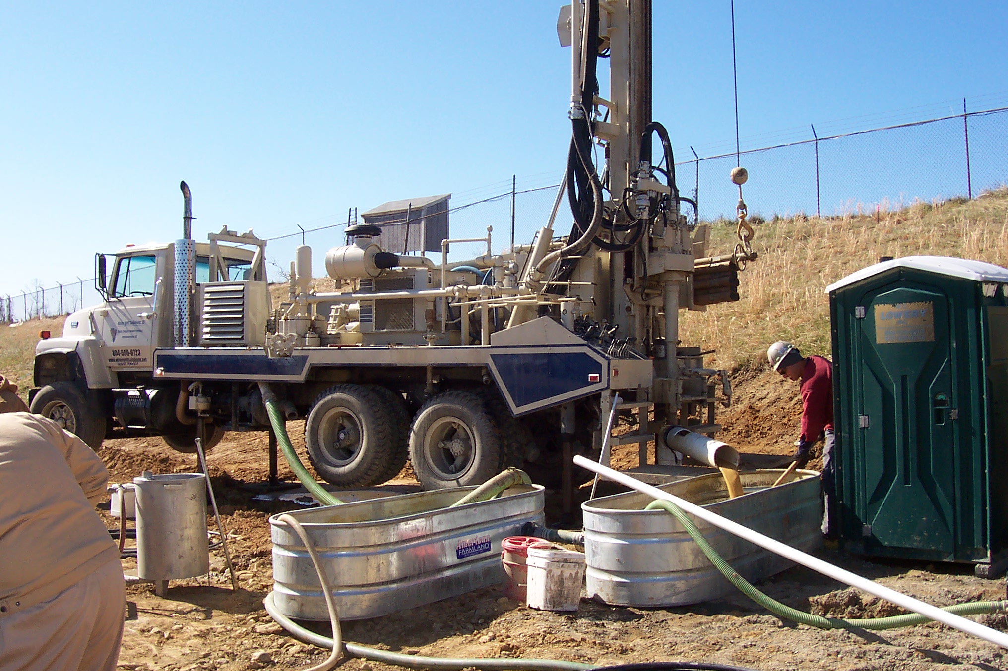

100_0565.JPGYou can do that hole easy with that pump, you could cut a 10" hole to 400' with that pump. What size casing? General rule of thumb is to drill a hole twice the size of the casing, or have at least a 2" annulus around the LARGEST OD of the pipe you want to set. Biggest thing people do wrong with mud drilling is go too fast. Drill slow, maybe 2-3' per minute on 6" with your pump, and wait long enough for the cuttings to come back before adding another rod. You may have to wait 20 minutes or even much more on deep to clean the hole, but it's well worth the wait. Build a bigger pan, get up to 300-400 gallons and it will make life much easier. If I loaded the picture right, you will see 2 farm tubs, discharge into the first, which contains most of the cuttings, pickup from the second. There is a connector hose between the two. With a 2 pan setup, you can keep most of the cuttings in the first and have clean mud in the 2nd. This holds about 400 gallons combined.

More great info! Thanks! Yes, I can see the tubs and I am sure more settlement time make good sense. 400 ft is good news even if axtreemly seldom needed.
I will keep this pump I currently have because a change to a lesser pump will not save much and the old pump? It shut down flow at about 34PSI - just no room for any issues.
Nice, clean looking rig you have and looks like huge power on the drive. The rig only gets about 2 ft per hour in hard rock and 5.75 inches? I was drilling through ignious rock on the last job and it was work. Because I am drilling much smaller bore holes, I hope to be able to use less settlement pans? How do you seal the bore hole collar to keep the mud from leaking out? This has caused me trouble.
