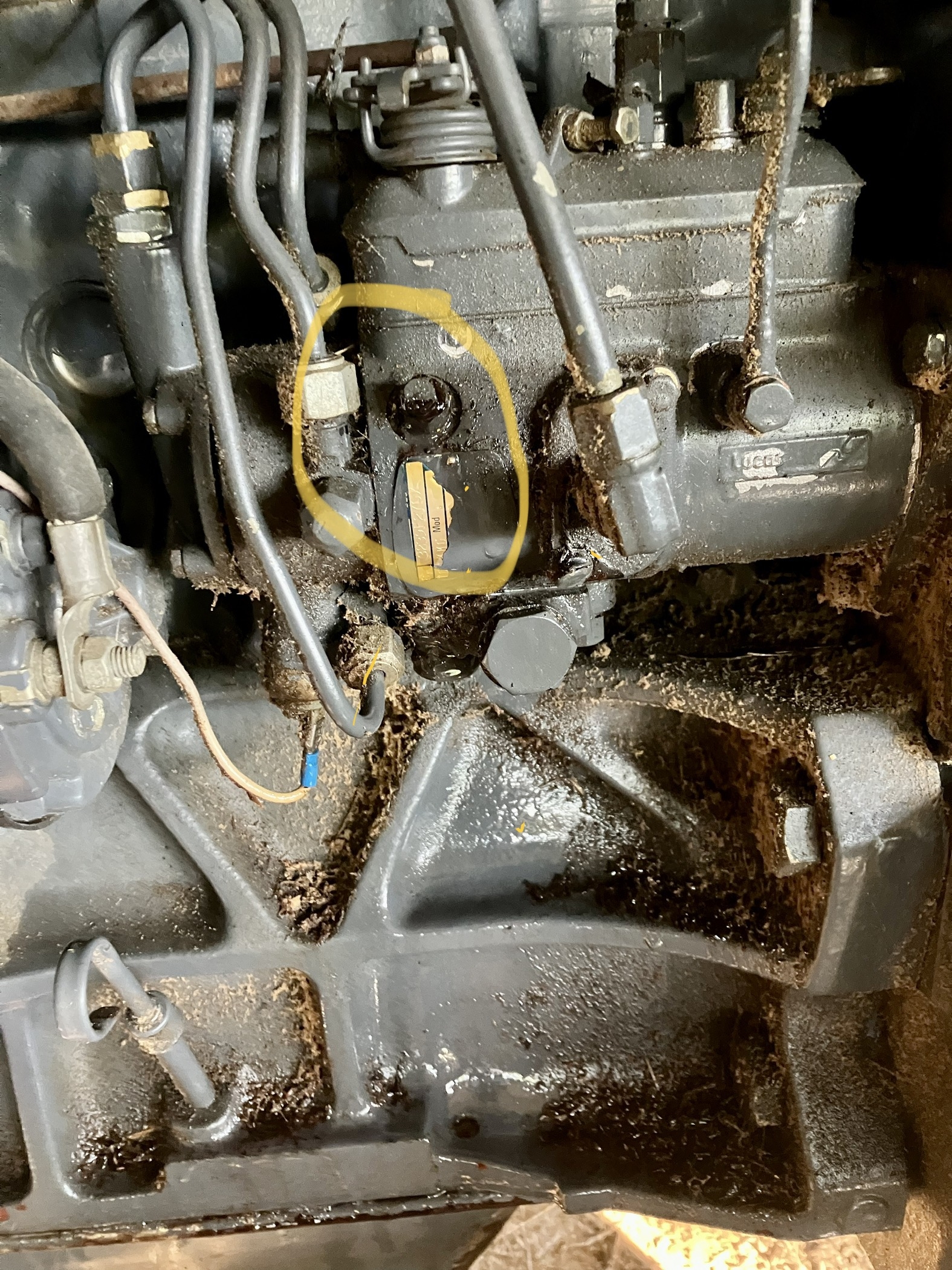

I have a 95 ford 4630 that leaks fuel from the injector pump when running i have circled in pic not sure if it is something i can fix or do i need to carry to repair shop.

That is the bolt that holds the head on the pump. You can unscrew the bolt and replace the copper washer. That should seal it.
WASHER​
Part # 81811703
380427S
-replaces #380427S COPPER WASHER

R u sure its coming from the copper gasket.??
That screw should b a double screw.. w a 15/16 center screw as a bleeder screw..
U may find either or, if u look up a CAV DPA pump..

Same copper washer assuming the bleed screw is tight. 5/16" btw not 15/16"
   / injector leaking fuel #5
Lol.. u r correct, 5/16.. lol
I couldn’t tell from the pic if the bleeder was broken off or not..(leaking)

Yeah, me too. Too much dirt on it.
No problem on the size, just typo

I'll try that.
Thanks guys.

U wouldn’t believe some of the filthy pumps I get.!!
Just DONT DO IT while it’s running.!!
The extreme temp change will lock up the head and rotor.. (main pumping unit)
The place I used to work at charged 50.00 for bringing in a filthy pump.!!
I use to warn the customers to go spend .50 across the street (car wash) or risk an extra 50.00 added to their bill.!!
