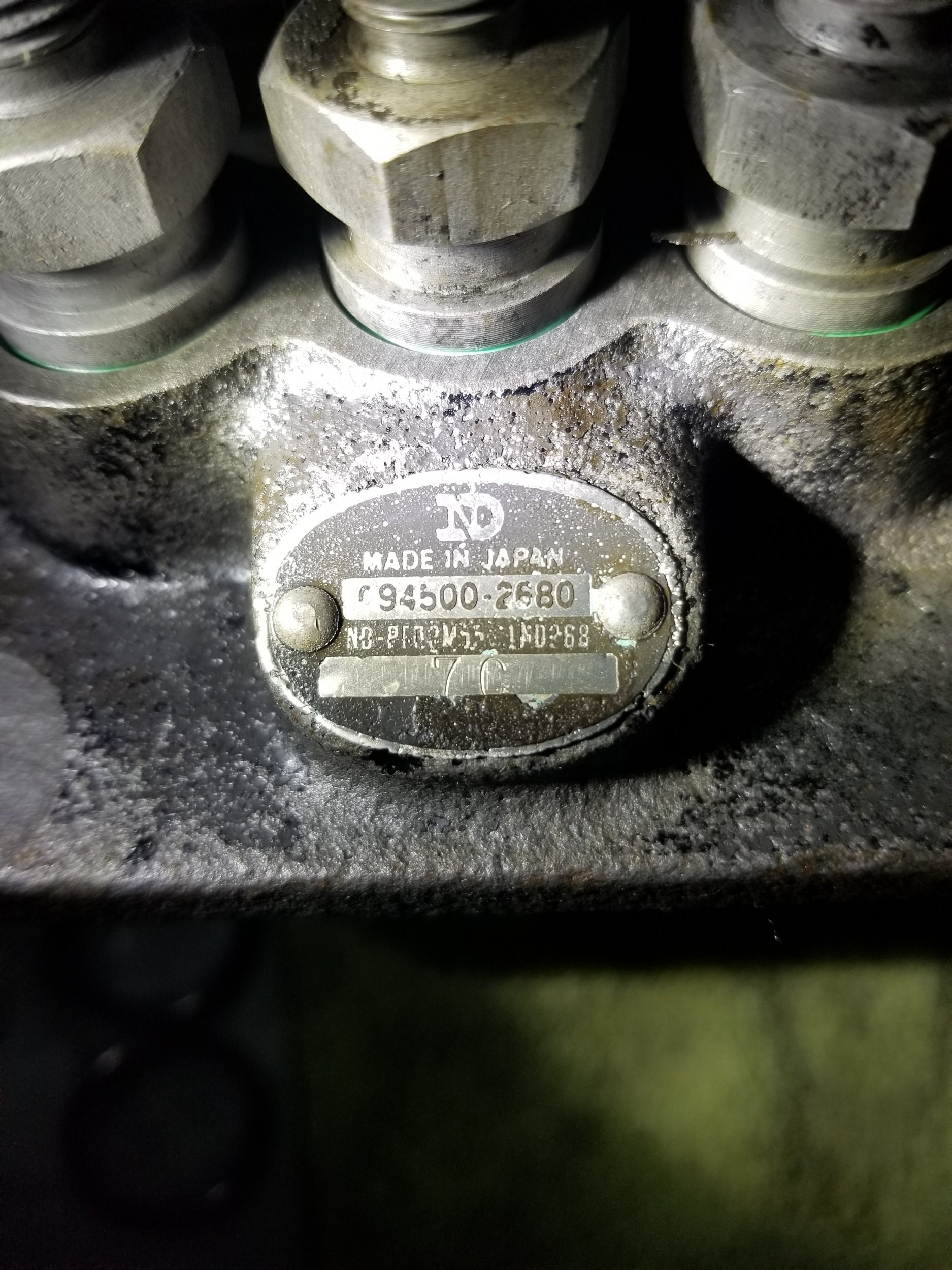

Hello everyone! I've been lurking in the shadows on this site for a little while and finally decided to join up. Thanks to the moderator and everybody that posts here. lots of great information! Now down to business. I Have a MT160D tractor with a K3A engine that has been threw a barn fire. Everything on the top of the engine is burnt. I was able to get a complete rebuild kit for a K3C engine from a MT180D. Its a very complete engine kit. Rings, pistons, wristpins, bore liners, main bearings, rod bearings, valves, valve seats, valve guides, valve seals and full gasket set. Everything is the same except for a larger cylinder bore. same stroke same Wrist pins. same crank and rod journal size. So back to my new dilemma. I'll need more fuel. the factory Denso pump for the K3A engine is a 094500-2680 model number. it has 5.5mm plungers and barrels. I have been led to believe that the K3C engine has a pump piston and barrel size of 6mm. However I don't have the the factory model number for a MT180D injection pump. My question to all of the wonderful MT180D or K3C owners is what is that magical little number on your injection pump?

Specifically the only numbers on the 180 injector pump are in the attached image. The other number is an engraved serial number.
/ injection pump identification help Please
#11
this is the pump ID tag on my machine. Ive also talked to Portland diesel injection. They are the closest shop to me. Don't remember who i talked to, but i was told that Denso changed their par numbers a while back and its really hard to cross reference to new part numbers. I also called and Fair Valley Performance. They Specialize in tractor pulling fule systems. They couldn't find anything to work with the factory denso pump. They are currently looking into other options for me. Not the cheapest route. But ive been toying with the idea of super charging this little engine. I have an AMR500 that would be a nice fit.
/ injection pump identification help Please #12
View attachment 719917this is the pump ID tag on my machine. Ive also talked to Portland diesel injection. They are the closest shop to me. Don't remember who i talked to, but i was told that Denso changed their par numbers a while back and its really hard to cross reference to new part numbers. I also called and Fair Valley Performance. They Specialize in tractor pulling fule systems. They couldn't find anything to work with the factory denso pump. They are currently looking into other options for me. Not the cheapest route. But ive been toying with the idea of super charging this little engine. I have an AMR500 that would be a nice fit.

Is sparex another manufacturer for a pump? I figured that finding parts under the Mitsubishi part numbers would be about nonexistent. I think they discontinued these little tractors in the late 90s. I am still hoping to find a viable doner parts from Denso numbers. Just haven't had any luck yet. On Monday ill call valley power products and see if they can help cross reference any larger pistons and barrels. Thanks everyone for the helpful advice! Im not done yet and ill definitely post what i find on here.

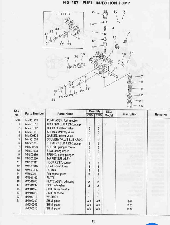

Our polish friends: FUEL INJ. POMPA PUMP.
Indicate: MM413227
INJECTION PUMP MITSUBISHI VST MT180/224
Wtrysk paliwa Mitsubishi VST MT180/224
Injection pump Mitsubishi VST MT180/224.
(M01:C25)
RZE E67 36/57
If the image is correct:
Bosch 9 410 030 523
BDC = 76 +/- 0-0.5
Finding the Bosch heavy duty cross reference is a bit harder. Maybe it can be done from your Denso number.

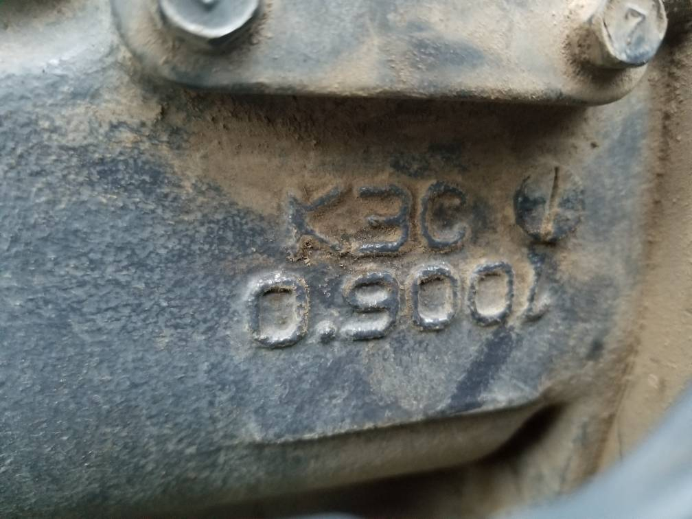

I should also mention, since you have two, is one apart?
If so, can you see if it matches the Perkins 403D pump?
Aside from the increased price for the Perkins name, as far as I can tell (without pulling mine out), they may be the same design and possibly fit the same mount. I would be curious to know if that is the case in order to add or rule it out from my list of matches.
