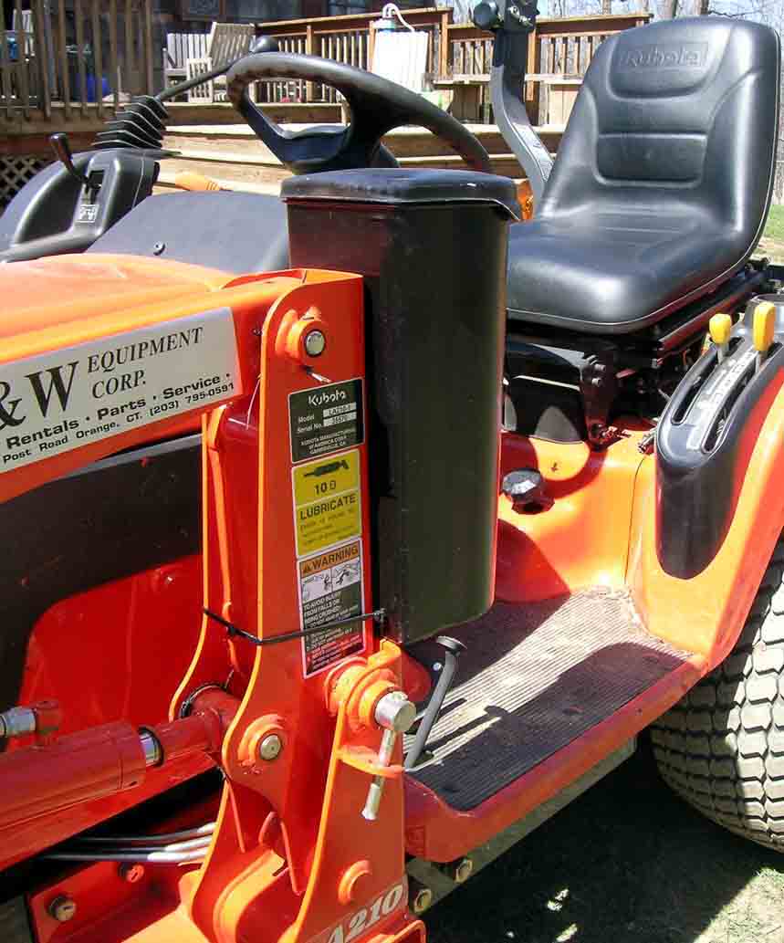

An inexpensive and simple toolbox (see attachment).
This is a rubbermaid bread container from Walmart that cost less than $4. I put a bushing that I had in my junk drawer into the hole in the loader and used a spring loaded anchor bolt to mount it. You could probably make the bushing by using the plug from cutting a hole with a hole saw. I cut two slots near the bottom to run a tie wrap through. Painted it black and put a strip of rubber insulated tape on the back where it comes in contact with the loader. Downside of this toolbox is it is mounted on the loader, and if you remove the loader you lose the box.

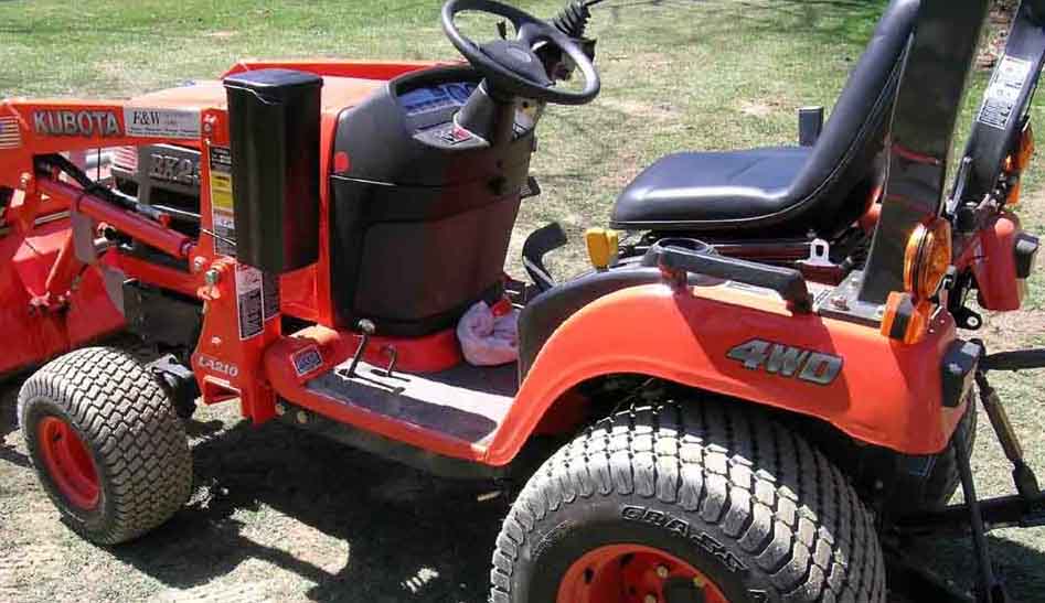

Another pic

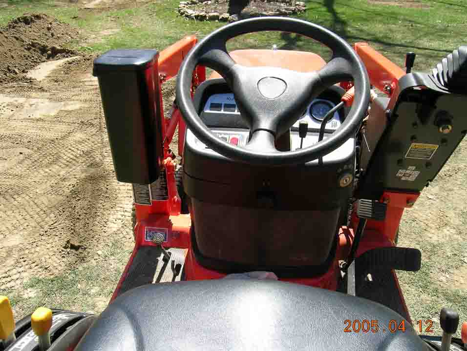

and another

I like it! My only problem is that I keep the remote control for my electric gate opener mounted on that FEL support, so I'll have to find another place for it. I have often wished I had some hand tools while out driving in the woods. Thanks for the idea!
