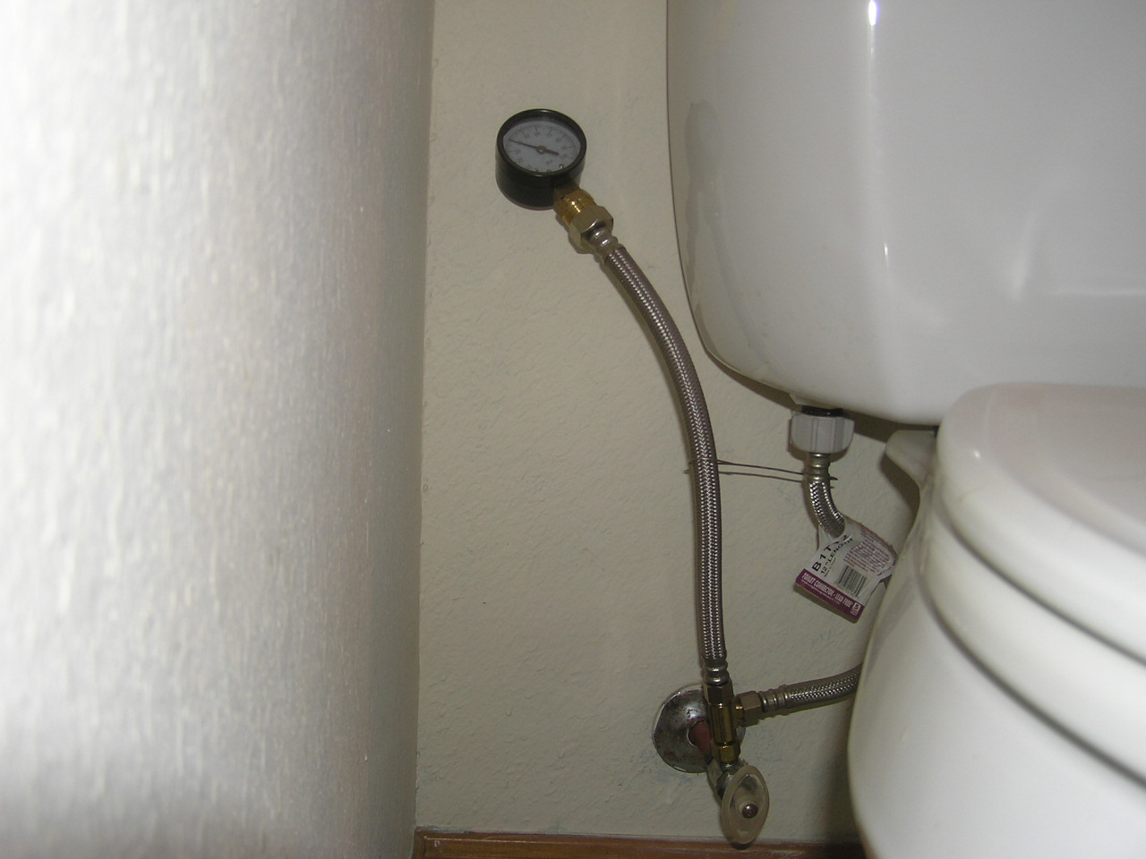

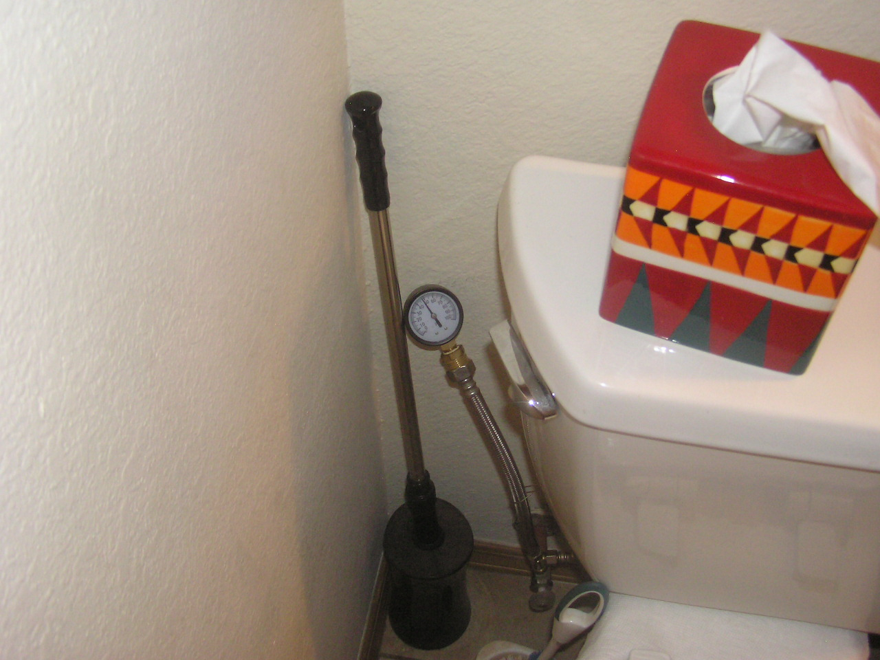

   / Indicator light for 0 pressure well #4
This is what I did. Added a tee, short hose and a water pressure gauge where it is easily visible:
   / Indicator light for 0 pressure well #5
That's the logical place to put it, but it sure made me smile. :)
   / Indicator light for 0 pressure well #6
Yep, I can relieve my pressure and check the well tank pressure at the same time. :D

Any pressure switch will work. Just set it lower than the switch that runs the pump. If the extra switch sees low pressure and makes the contacts, you can wire a light or anything to the switch to alert the owner. This is better than a light on the main pressure switch, as the light could be on when the switch is telling the pump to run, but the pump might not be working.
I love the pressure gauge on the crapper! Looks like something I would do. Lol!
